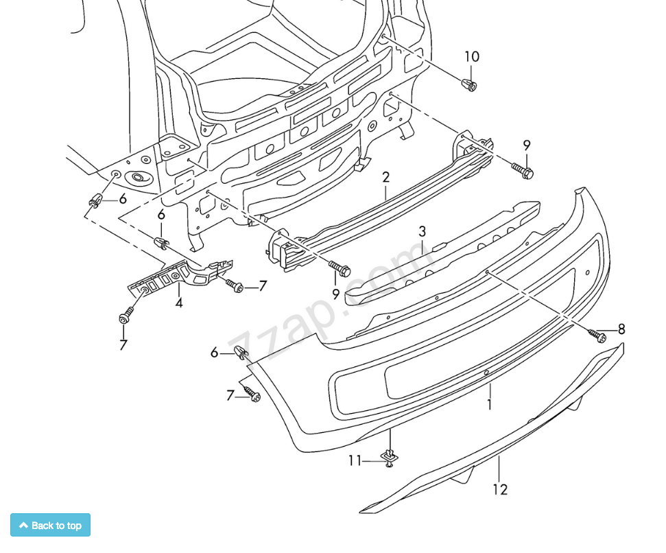

Do you know which of the parts in the illustration below you had replaced? Number (4) is described as a "Guide Profile" was it that?
Peter
The bump stops with the rear springs and shocks, not the parts above.
As in rubber mounts?
Correct.
