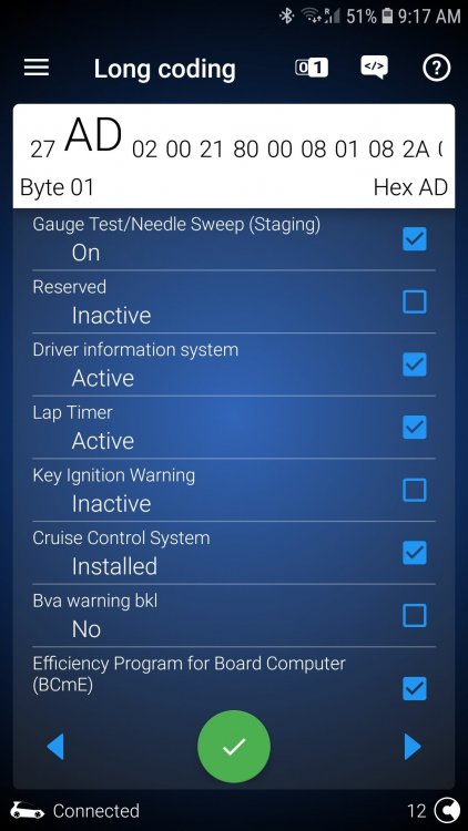

Here's where I ticked the box, worked for the lap timer but not for needle sweep ☹
I didn't use that screen, my option was in the Instruments section, but was called "Staging" rather than anything to do with needles.
