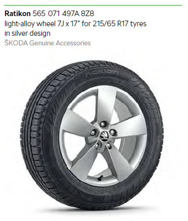

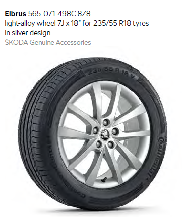

If the dealer does indeed declare that there's nothing wrong then another option might be to down size the alloys from 19" to 18" and take the higher profile tyres.
Or even 17"...
