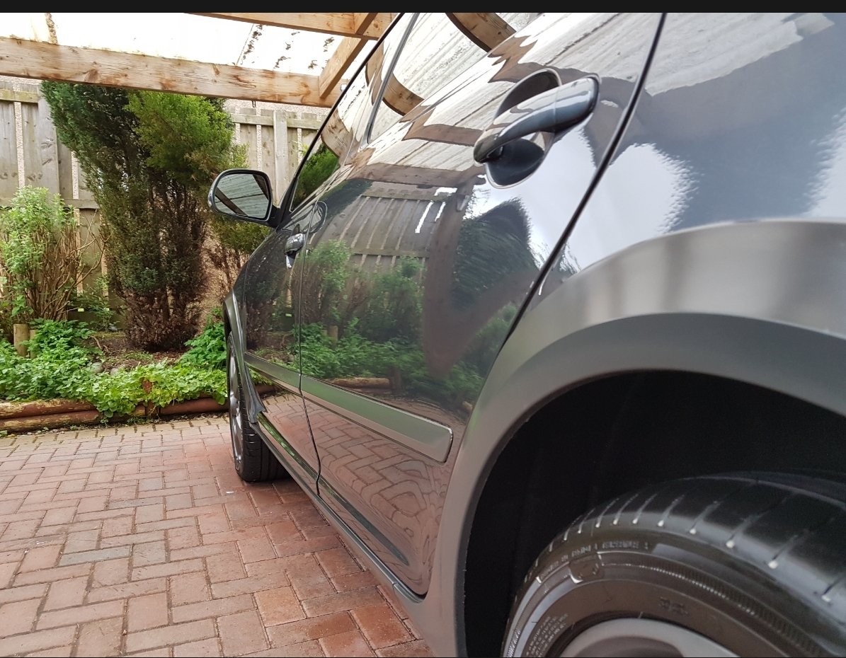

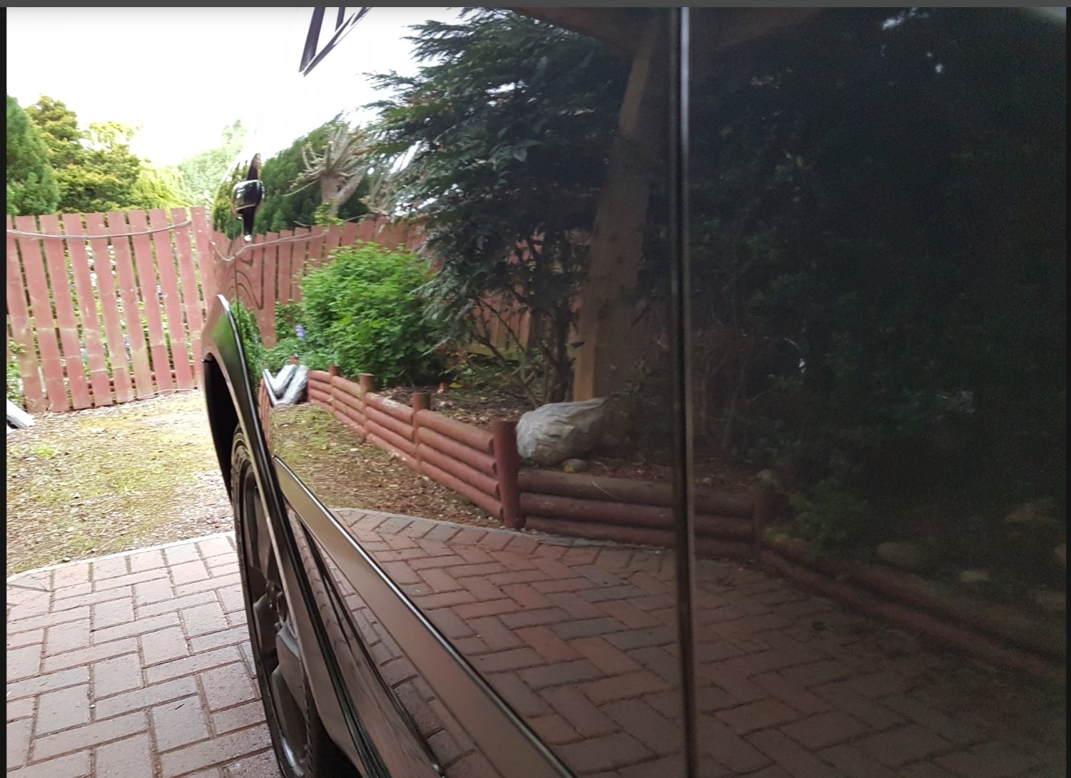

I used the above procedure last April and this was the result on a 8yo car approaching 100k;
Screenshot_20190225-121207_Chrome.thumb.jpg.efe3b19ff395f3c3efb1bbfb965657aa.jpgScreenshot_20190225-121120_Chrome.thumb.jpg.db881d9e7787ed48387bb07acad474c0.jpg
