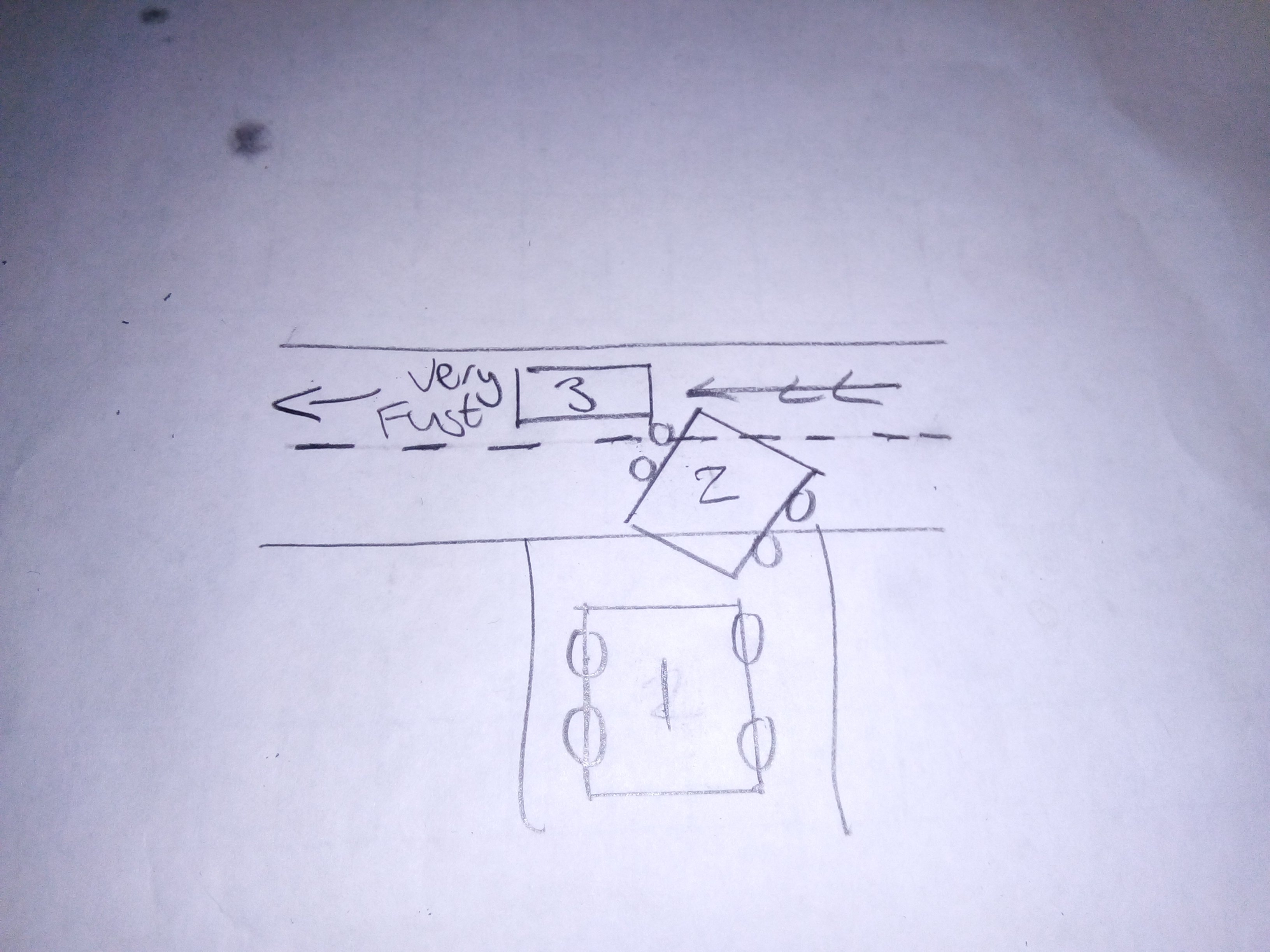

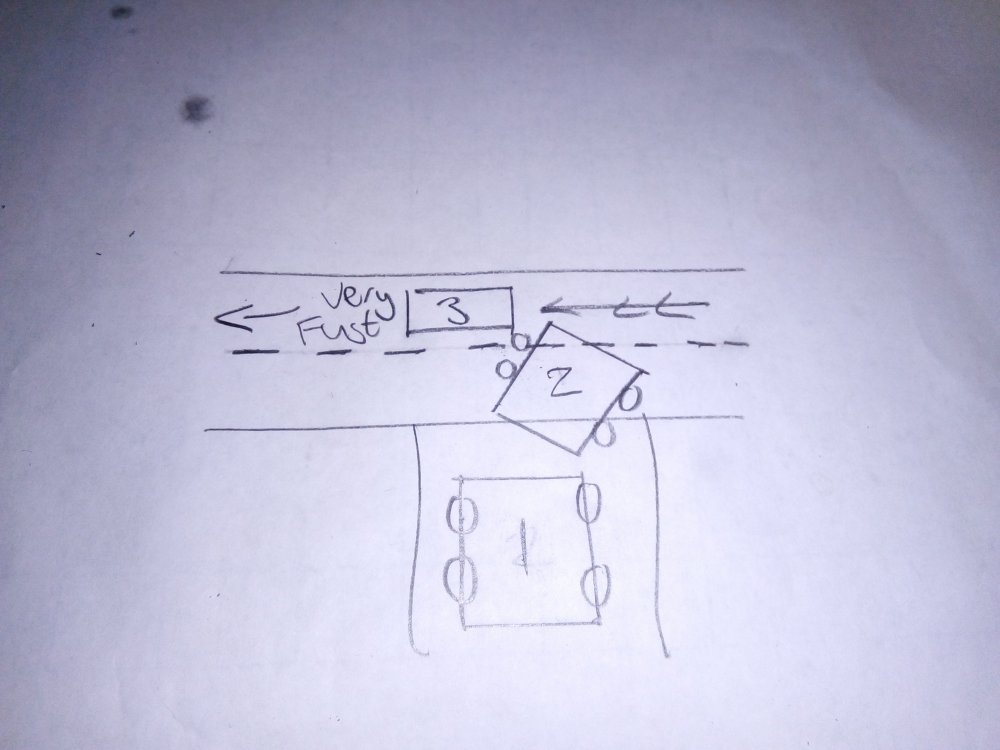

I brake Left footed as have problems with right ankle fatigue doing all the work and I once heavy braked Left foot at same time as front assist to the car in front, and touched the accelerator slightly at same time with my right foot while pulling out of a junction RH turn, when someone was overtaking on wrong side of road, and it left me sideways on blocking the main road both directions!
Are you describing one or two different incidents?
In either case I still cant understand what is being said.
Not being pedantic I genuinely want to know what happened and the circumstances.
14 minutes ago, J.R. said:
As I said, The first paragraph.
Attempting Right turn behind another car, clear from the right to both of us car moves forward i follow, he brakes because of an illegal overtake of another car,
i brake (my front assist comes on) , i also think i touched the accelarator at same time. I am then stuck in middle of road (cant move car stuck) wont reverse
Thanks I understand now, are you car No 1 or 2?
In either case your description makes sense to me now.
Why did your car react like that? It may have thought the accelerator imput was an implausible signal and in a percieved emergency situation such as you were in it would not allow you to continue, maybe until after a fault clear countdown.
I used to left foot brake a lot, especially when driving a loaded vehicle over speedbumps, driving with throttle open and brakes on sort of hunkered down the suspension and stopped the excessive pitching.
It was either my 95 Galaxy or perhaps the 98 Alhambra that would cut the engine power when the brake was pressed so it didnt work, I found there was a 2nd brake pedal switch to communicate with the ECU so I shunted it and could left foot brake as I wanted, after about 6 months it threw up an implausible brake switch signal fault code.
yes i was car 1 glad it makes sense now. The car thought i was in an 'accident' and locked me down like i was in P (but i wasnt).
Only N would work after switching engine OFF and ON and then i rolled backwards out of it to safe side street. Really weird what happened!
