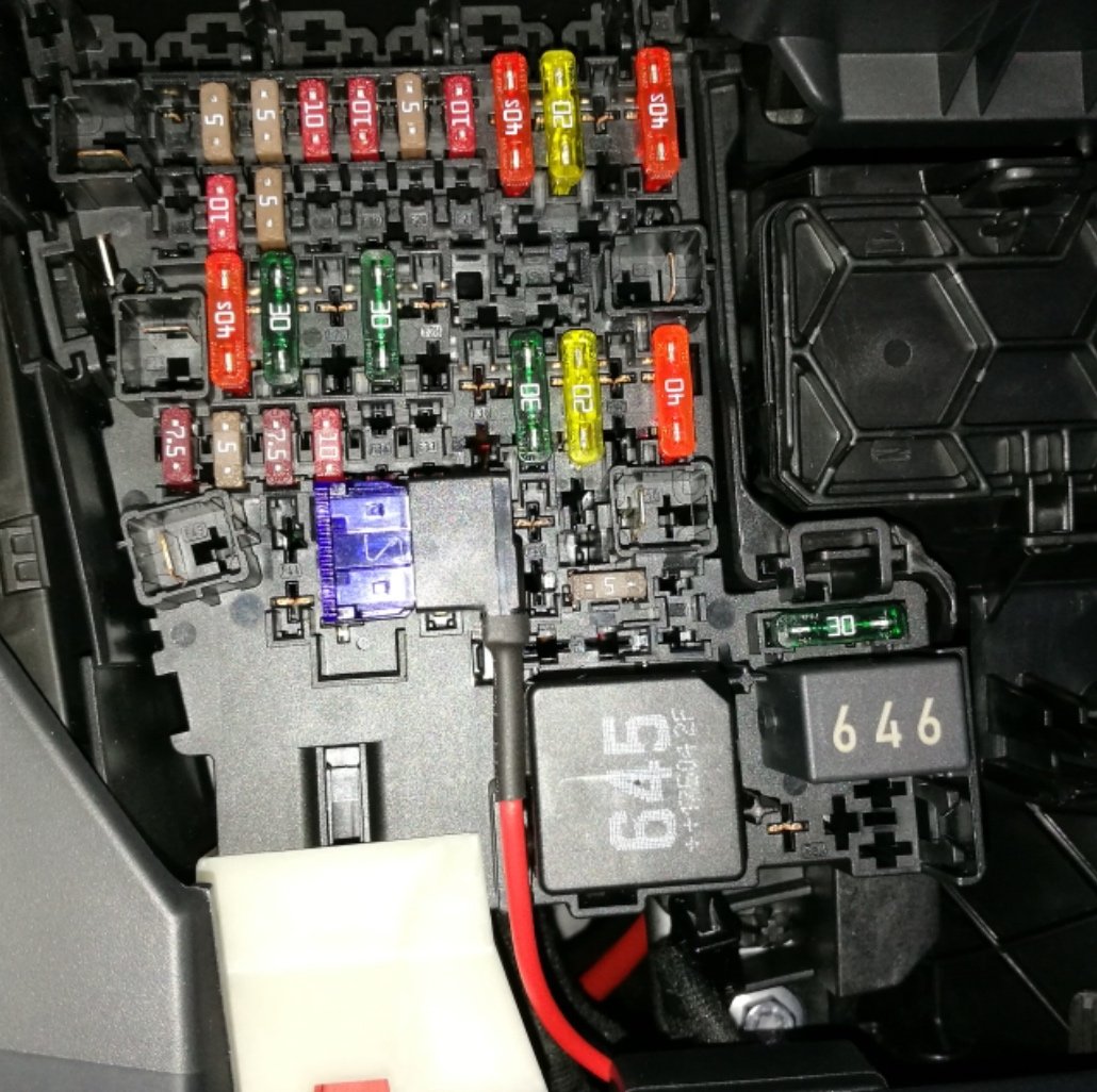

Just listened to your attaxhment again, sounds like possibly a relay. There appear to be two relays at the bottom of that fuse box.

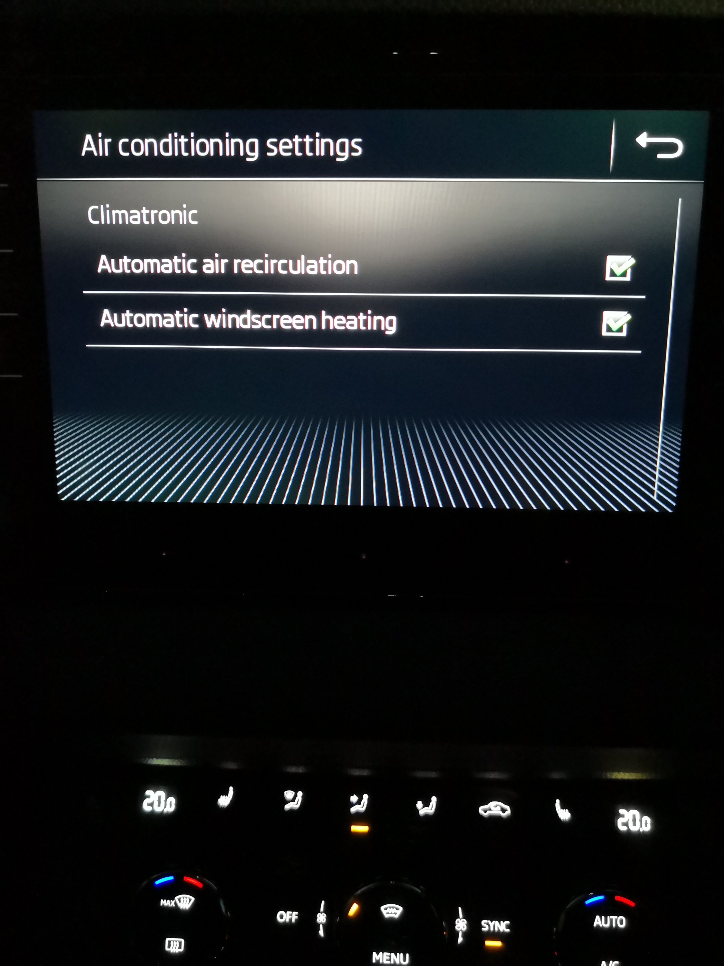

I had same issue. Go into the air con menu using menu on fan control knob.
Select options on bottom right of screen. If you have a tick in "auxiliary heater" untick this.
This stopped the noise for me.
Hi Bobspence. I went to the air con menu but couldnt find an auxiliary heater option. Only air recirculation and windscreen heating. Is your Karoq a UK spec? Thanks.
Yes UK spec but mine is 1.6TDI
I would disable the auto screen heating and see if any different. You can always re activate
Screen heating (amongst other things) is operated through relay 646 and heated rear screen through 645. If switching on/off these functions affects the buzzing sound it seems that the noise is coming from one or both of the relays.
Edited by Breezy
The aux heating us diesel only I think
Could be. Mine is the 1.5 TSI
Next time I shall put my hand on those relays to see if I feel any vibrations off them. Thanks
Buzz doesn't seem to come from where the numbers 645 and 646 are. And turning off auto air recirculation and auto windscreen heating didn't make a difference :(
