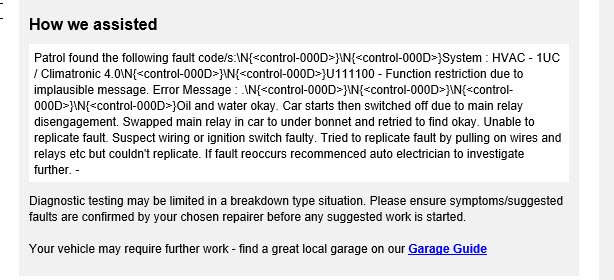

Just to let you know how i got on, First i ordered a obd reader and not here till tomorrow, This morning had to call AA Homestart  out to my house,  Car was terrible  same fault as before only 10 times worse, when it did start it keep sart stop start stop , The AA guy put a reader on to test for faults,  The attachment is the details of fault
After he pushed all connections and wiring to the main relays it solved the problem, So i asked him to follow me to auto electrics for them to check it, Waiting for the outcome,
