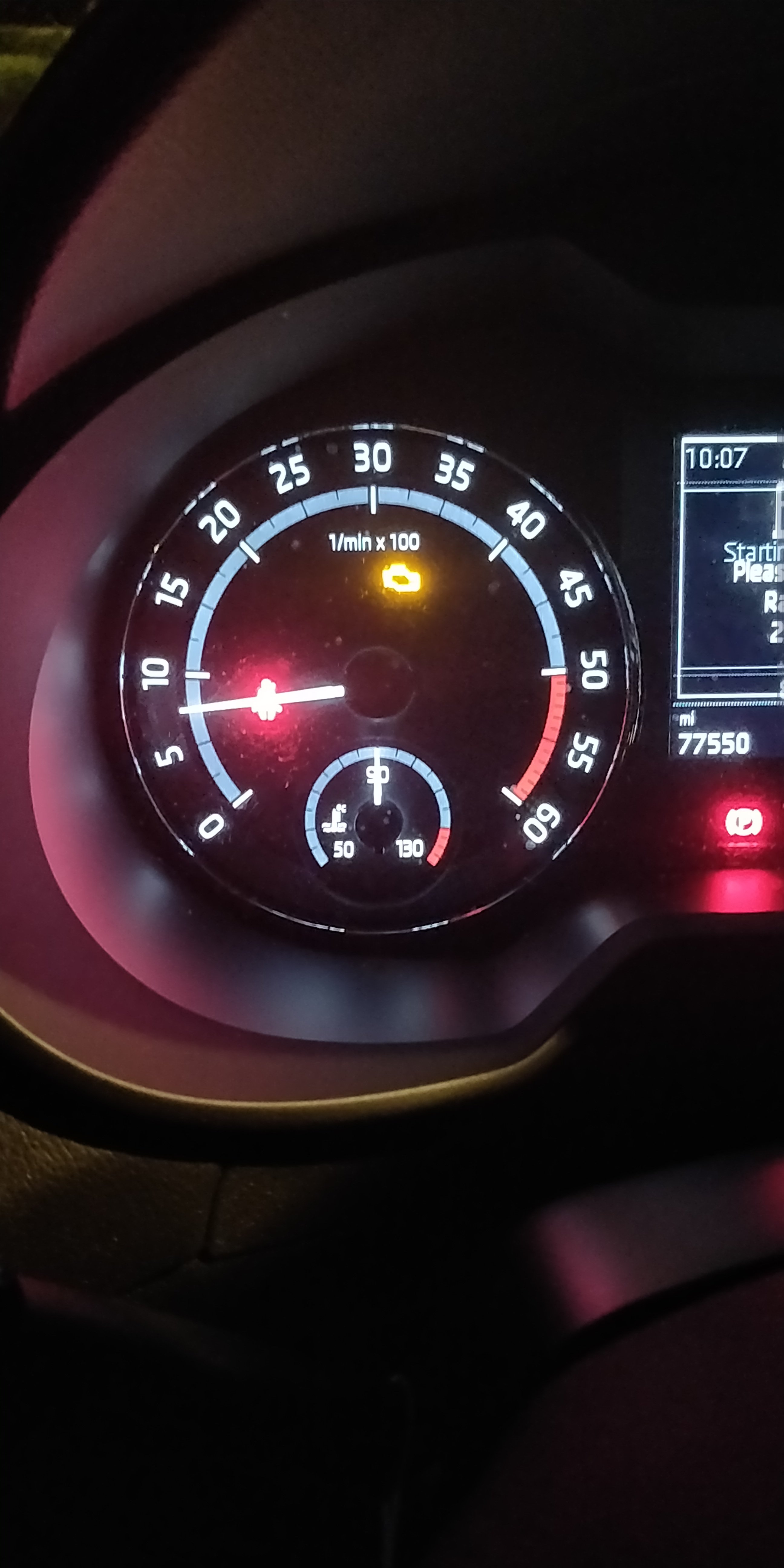

MK3 Octavia VRS won't exceed 100mph
Hello folks, first time posting after being a lurker for a while... Just had a check engine light repair, something to do with the secondary water pump leads corroded, will put further details in later, yet on my way home I took it for a 'spirited' drive on a long private road and it just wouldn't exceed 100. Pulled well through the lower gears, but ran out of steam towards 80 and above. This water pump is something to do with the turbo I believe so could it possibly need a replacement turbo? Any information shed on this would be great! As the only garage I trust locally is closed until Monday :(

Skoffski & V6TDI first of all many thanks for your polite replies! And the warm welcome to the forum! Over the weekend it will be easy for me to avoid driving it, or if I need too it will be very minimal at least. Indeed as you've said a stitch in time... I do hope it isn't a turbo failure, although if it is it may be time to get out of the Skoda sooner rather than later... It's near as makes no difference 80k on the clock and has been faultless over the past 30k since I've owned it. Will post an update on Monday hopefully after diagnosis!

Quick update, took it for a gentle necessary trip just now and on the return the light returned... Luckily I've managed to get hole of one of the mechanics at the garage who is willing to look at it for me tomorrow, will update incase this becomes useful for someone else in the future :)

@themanwithnoaim not a problem with me calling it quits!  And the problem has been resolved now, was a siezed fan on the water pump or something along those lines...struggled to hear over the phone earlier but car is back performing as it should!
