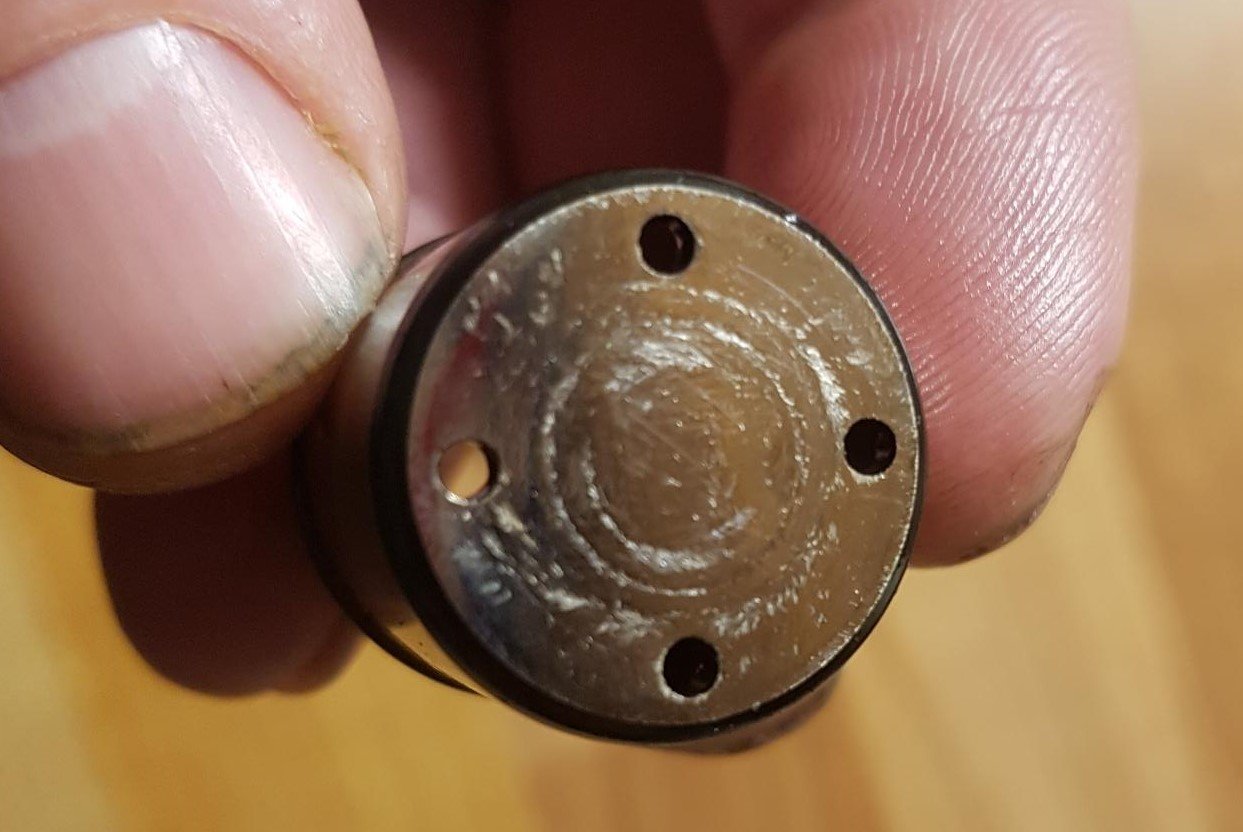

I have changed the Fuel Pumo Cam follower on my 2006 Octavia VRS using this excellent guide:
Thank you very much vRS Carl.  10 yrs later your guide is still helping people and saving money!
The cam follower was the original at 105k and showed very little signs of wear. However, better to be safe than sorry.
One thing I did notice, that I wonder if anybody else has come across, is the schrader valve. When I followed the guide and pressed the schrader valve, there was no residual fuel pressure! Does this seem right?

Thanks munster. We were doing the same job at the same time then! Was there much wear to your cam follower?

Yes, I think you did just catch that in time. Looks very worn. Did you replace with an original part? I used a Febi part as my local dealer wanted £40 for an original!
