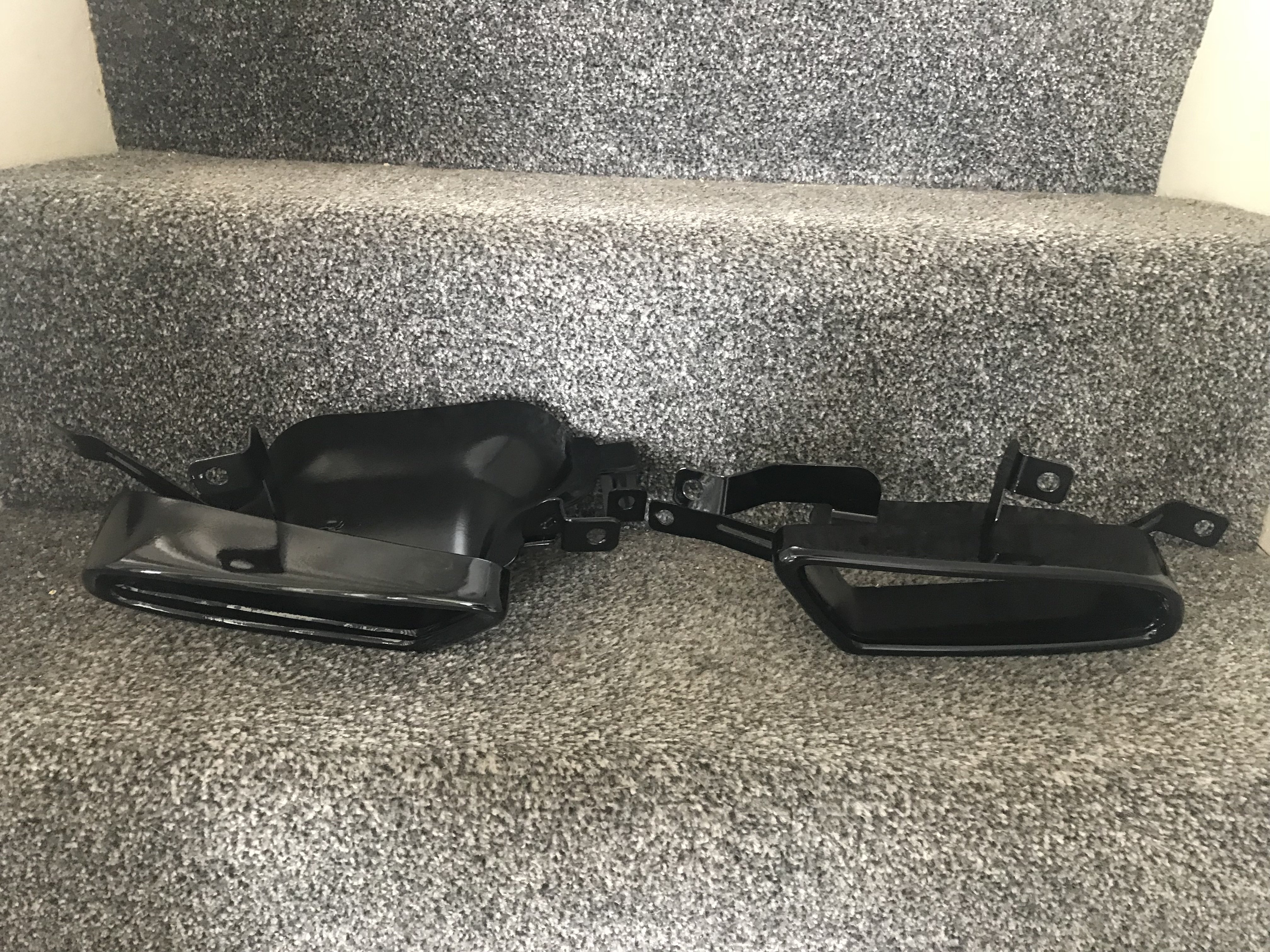

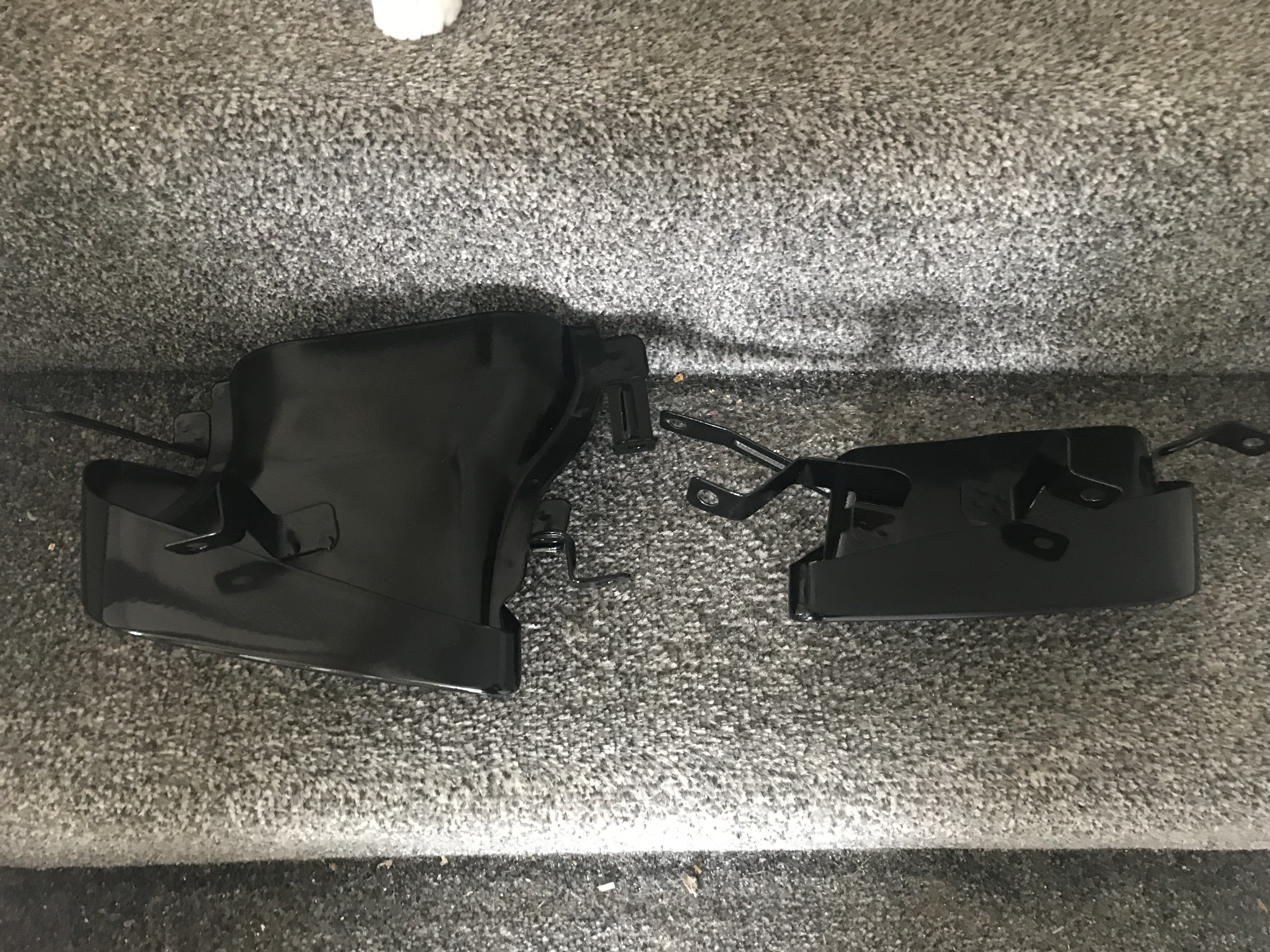

There are 4 torx screws each side to undo and then they are off i panted my ones with heat resistant paint and then lacquer them with heat resistant lacquer i did it 2 years a go now and they still look good

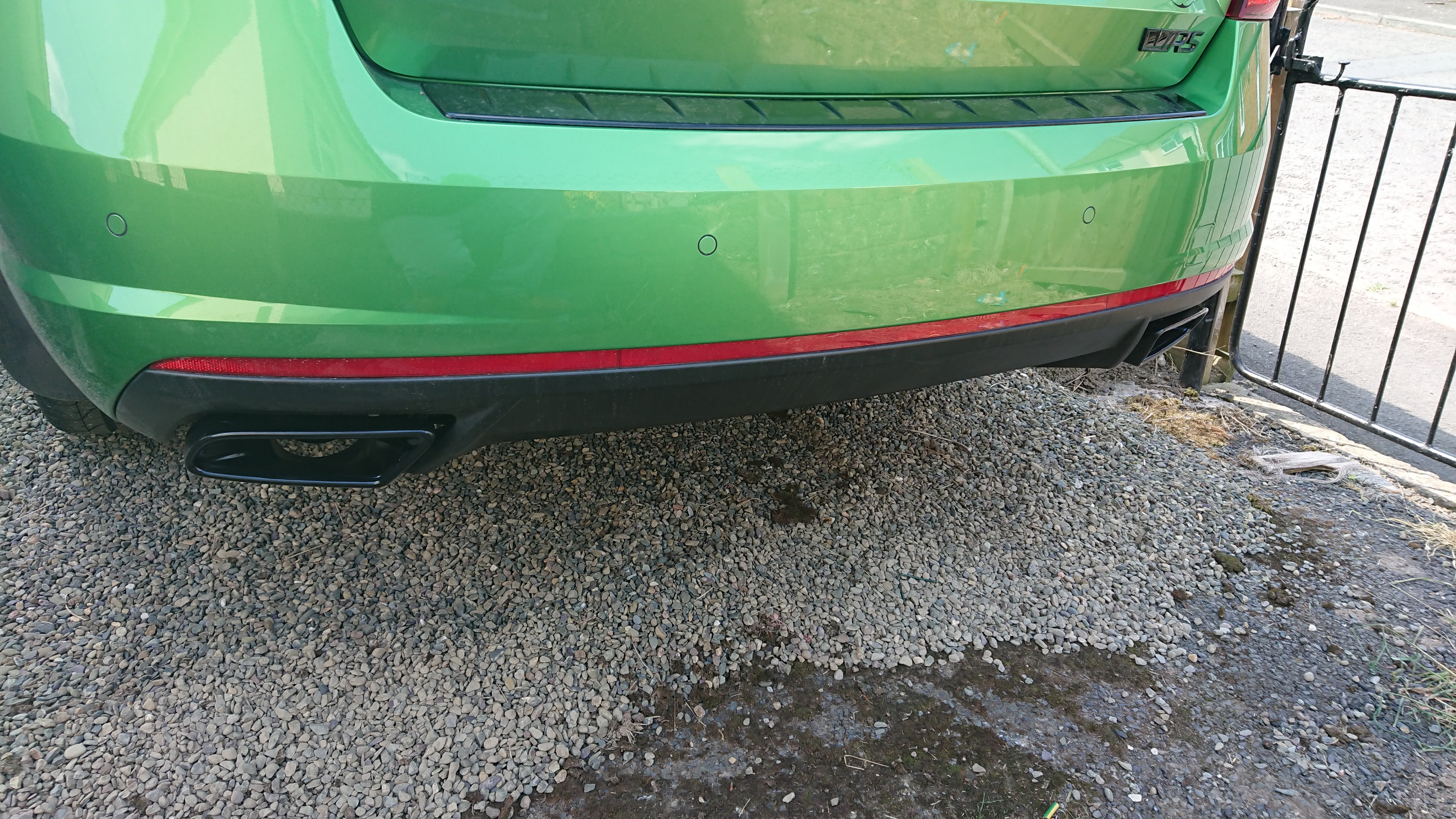

I purchased a can of black gloss engine paint from Halfords earlier today.
Alas the weather has stopped me getting under the rear of the car to remove them - so I'm just waiting for a dry hour to get them off so I can clean and get them ready.
My plan is then to give them a number of coats over the week before popping them back on the following weekend.
I'm assuming there is no issue driving the car without them - they are decorative rather than anything resting upon them etc?
