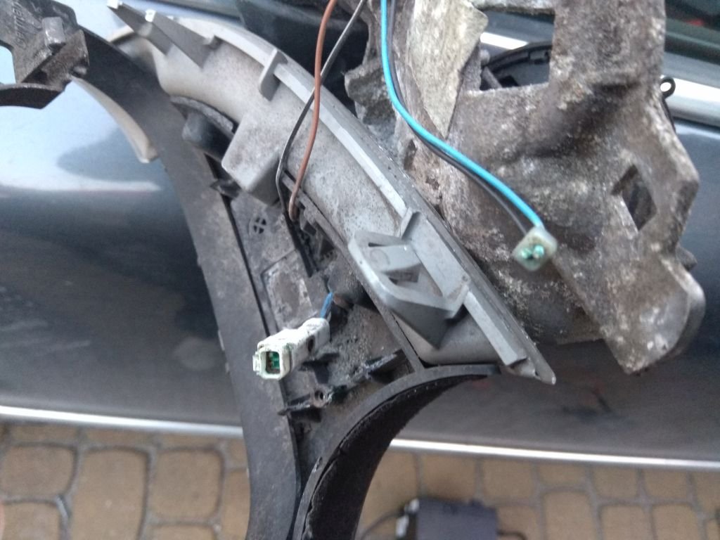

OK guys today i started my dat with checking wires in the trunk and i unplugged every single light inside the car. But still i was getting this error:
Address 46 Central Conv.
00946 - Interior light (W) Short to plus
And then i realized that there are two more lights that i can't unplugged -> Ones present in the mirrors -> yep, left one was the issue.
Evething is connected and sealed properly -> AND IT WORKS. FInally WORKS after allmost 3 weeks ;).
I hope that this battle that i won might help someone to resolve their lights problem ;).
