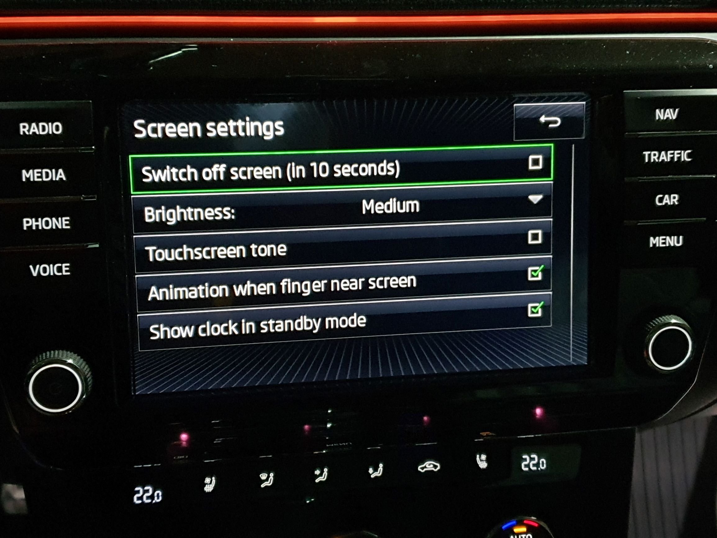

and there is another option which disappears after Off/On
