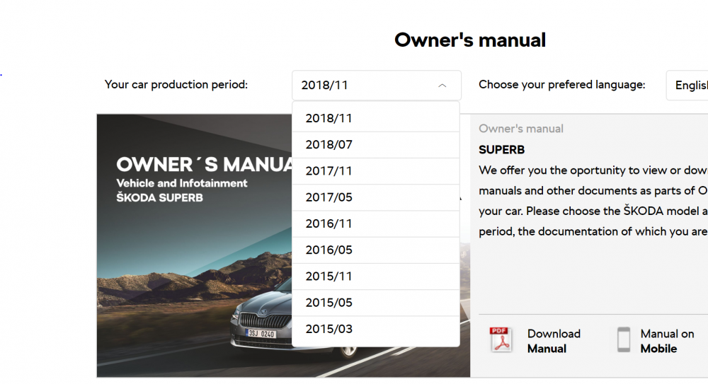

  • Ok! So a few posts back I had written that I thought I had found the solution by browsing the user manual. At the time I was doing so using the electronic version of the manual from MySkoda app. But w
