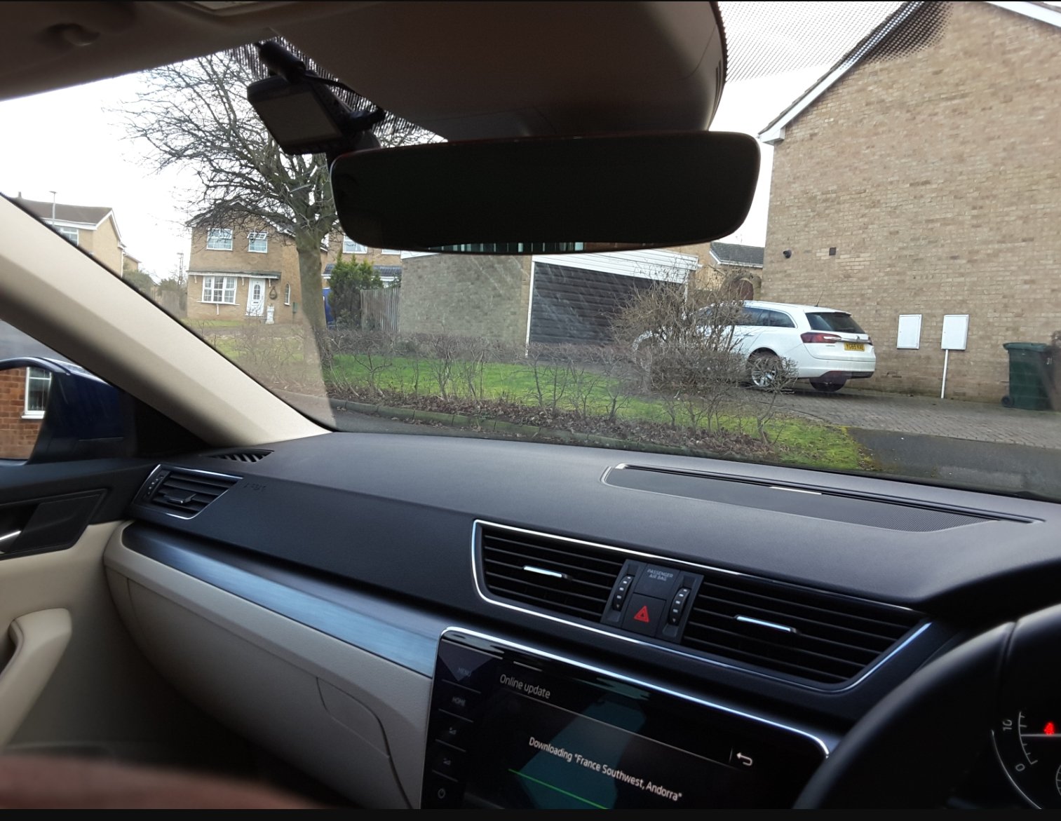

It's any easy route along the top of the screen down the passenger side front pillar. Remove the panel on the end of the dash behind the door, drop the glove box door. The fuse box is easy to access.  There are plenty of posts on here.
Edited by vfrvrs

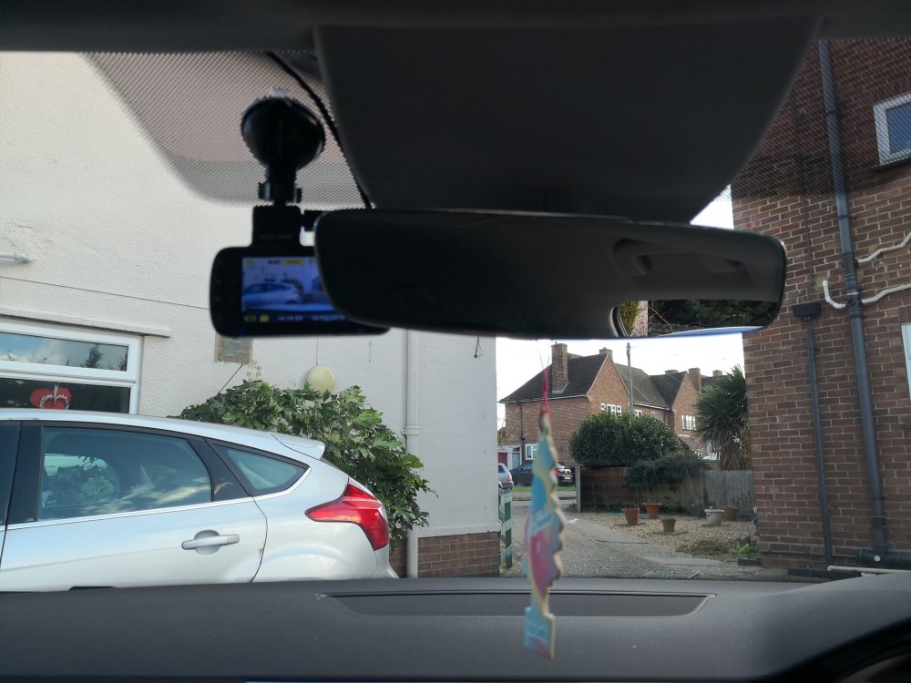

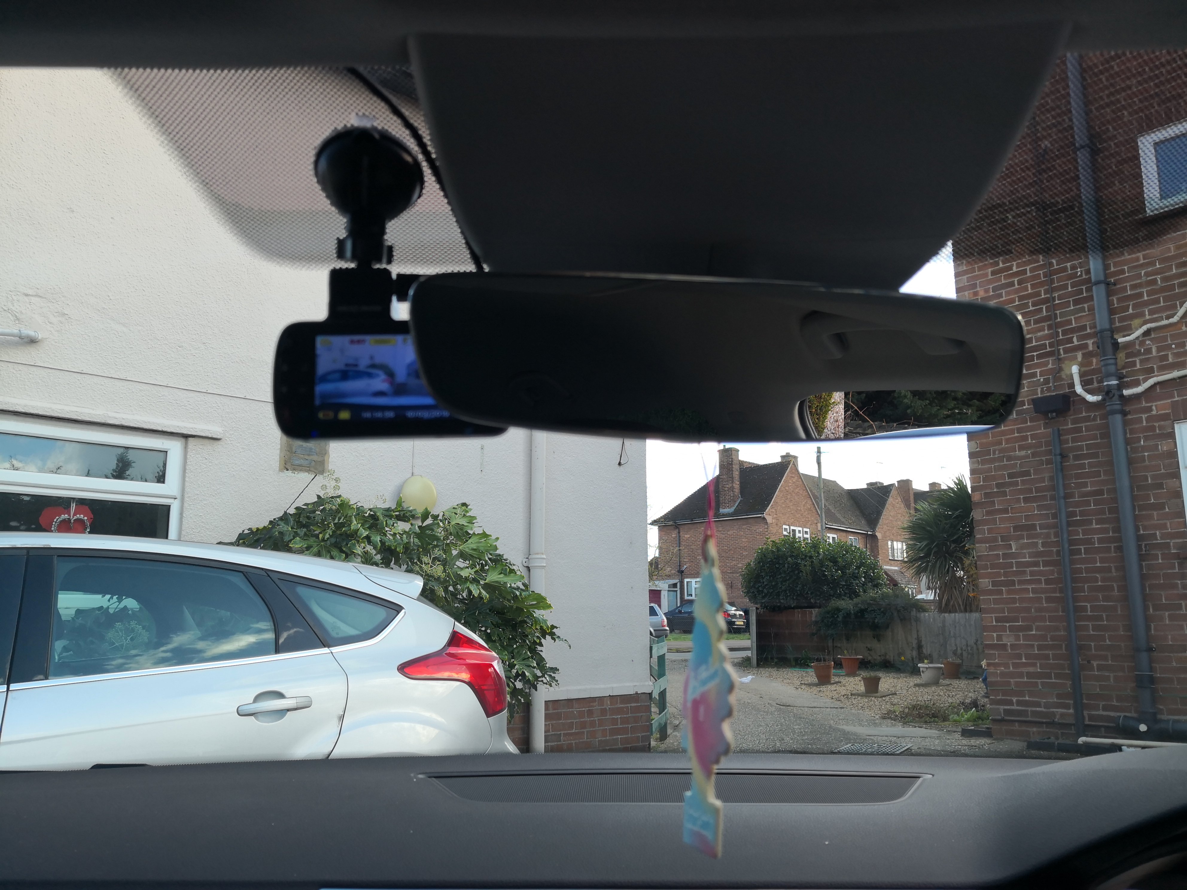

fitted my cam today the guide was useful

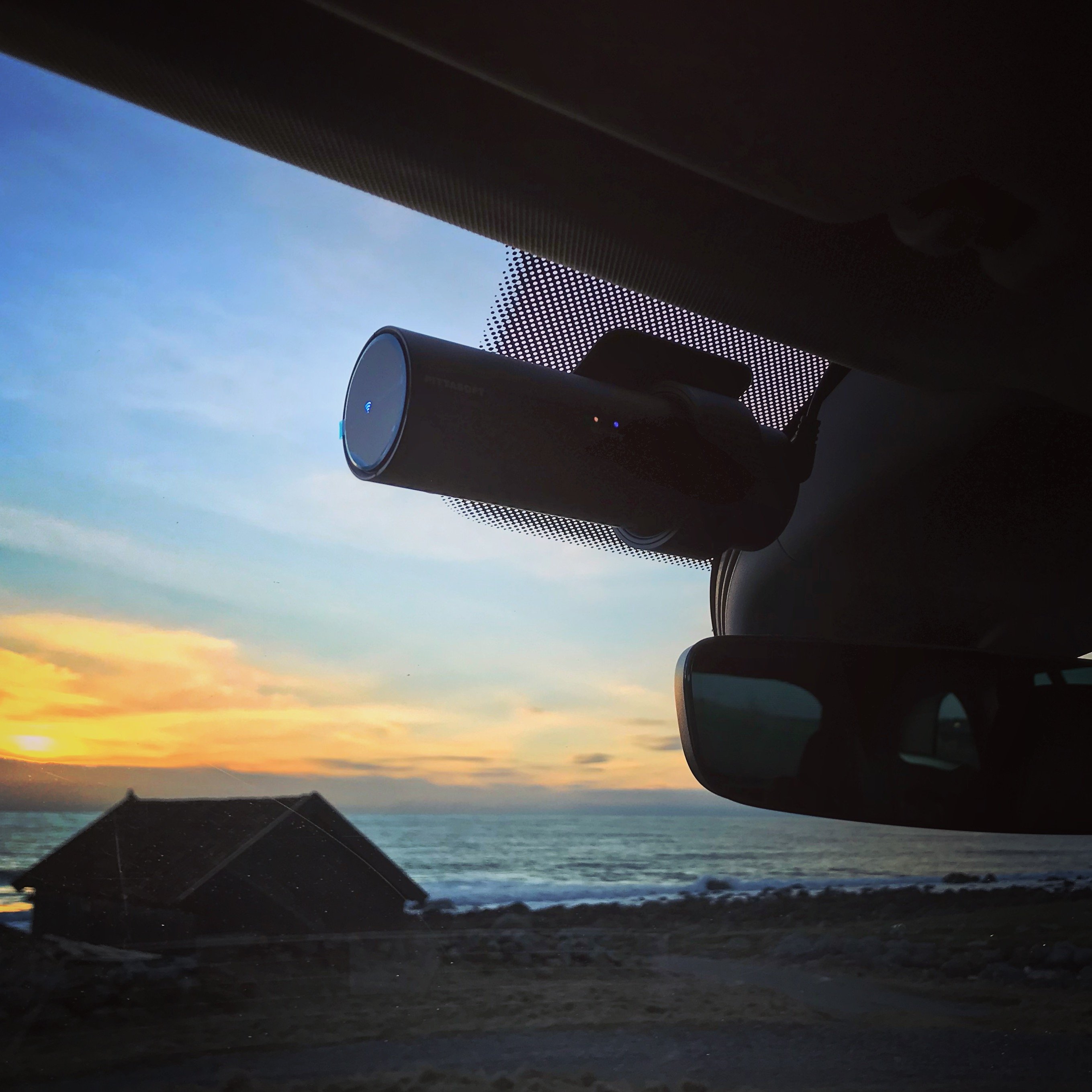

Have been thinking of mounting a dashcam for a while, and got inspired when reading about it yesterday.  So went to my local shop an got a camera and the power magic pro for hardwiring/possibility to use parking mode. Really easy to install, and happy with the result.
That looks like a fab location...the vista...not the camera!!!
