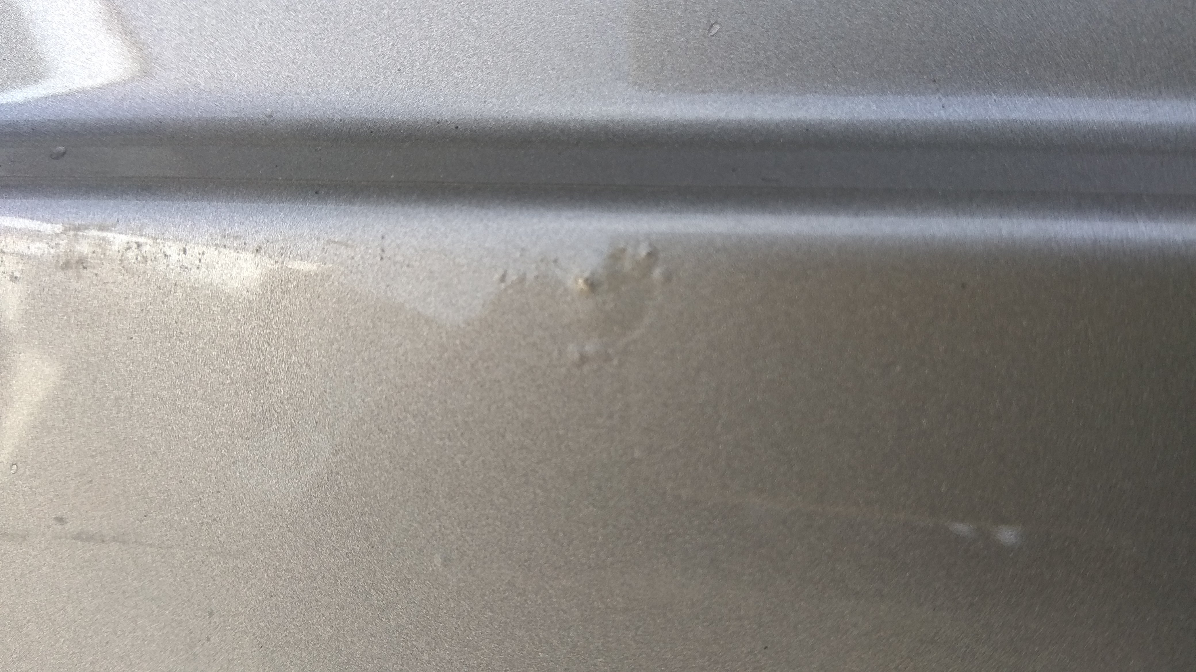

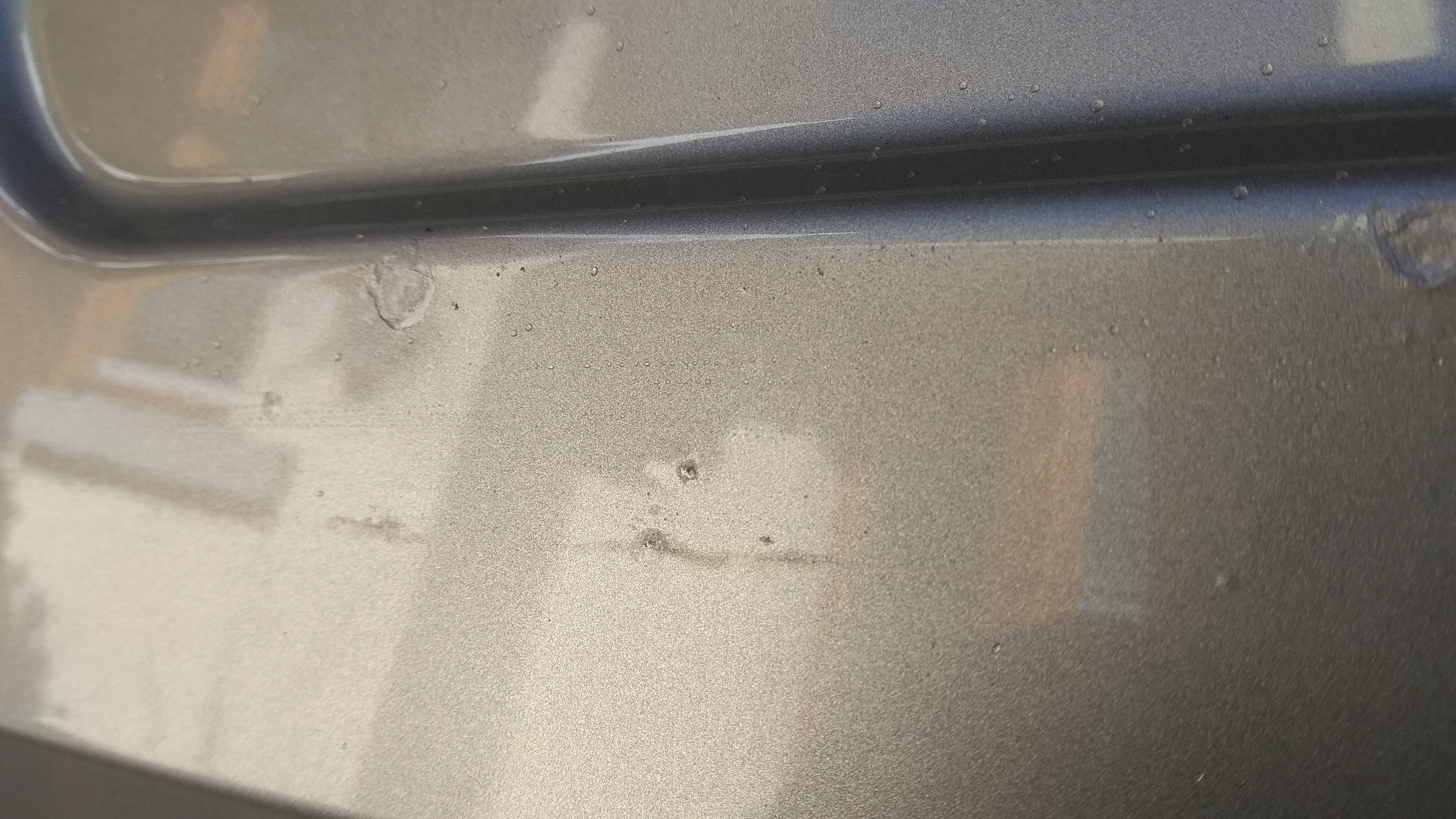

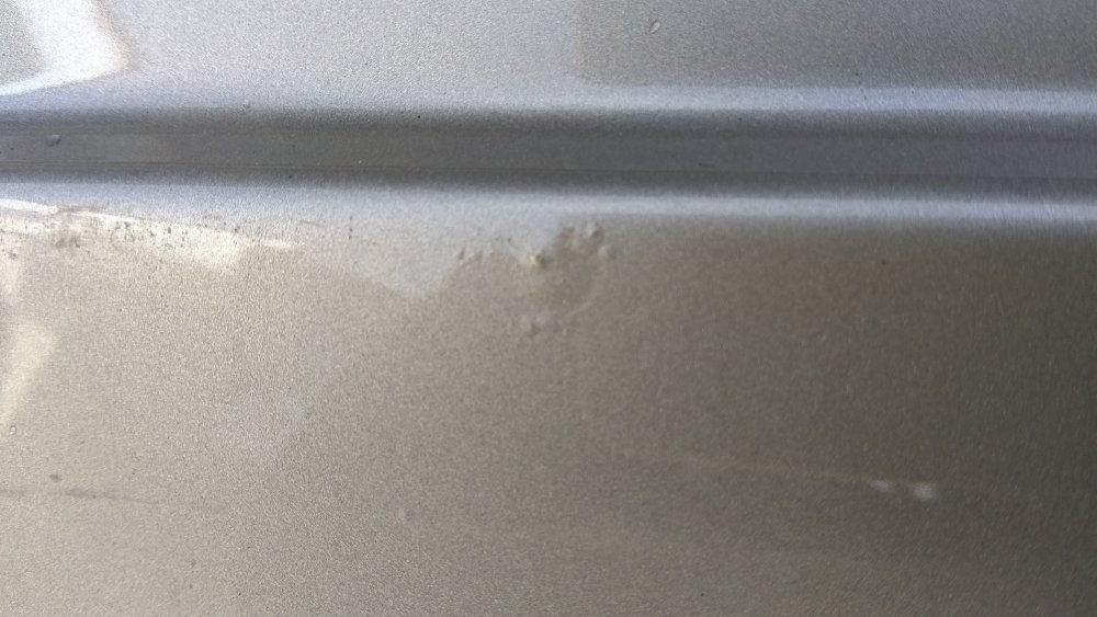

Fitting new rear number plates today and found a number of areas where the paint work was pitted and rust had started to form.
Ground back the paint with a dremel touched up with anti-rust and painted. Not a pretty fix but hidden behind the number plate.
I assume grit had got behind the number plate and was chafing against the paint work. I also noticed the metal is super thin in this area.
Could be worth removing your number plate and having a look.

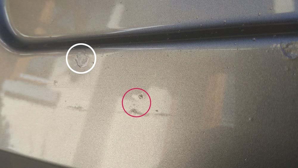

Are those photos after your fix or before?
White circle I had fixed, red circle is was not fixed (but now is). The bubbles were where grit had abraded the paint, trapped between the plate and body, maybe slamming the hatch aggravated caused the damage.
So long as you are sure. To me, bubbles like the ones to the lower right, not highlighted, and there seems to be at least 3 that I can see, where the paint doesn't seem broken shouts internal corrosion to me. It could be the bubbles that you repaired, were indeed damaged by the plate, but as a result of the bubbles lifting toward the plate. What looks like grit could be the underlying rust.
I would check the inner side of the tailgate if I were you. For peace of mind.
