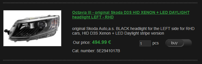

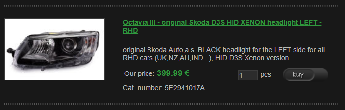

Afternoon guys don’t know if I’m doing good or wrong here but I’m sure someone will help I habe a 162 skoda Octavia ambition looking to change out the headlights so some better any recommendations and items I could put in not a huge cost ?? I perfer and headlight unit change out not bulb change out !’ Thanks again
Your only option it to upgrade to the bi-xenon headlights. Not cheap I'm afraid. In addition to the actual headlights you need the automatic levelling system sensors for the suspension, headlight wash system (if not already fitted), plus some electronic module upgrades and coding...
Image result for mk3 octavia headlights
