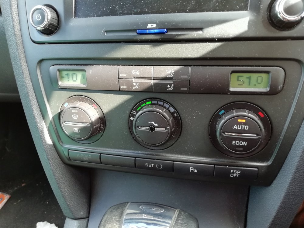

Looking at the liquid refrigerant pressure on the climatronic it shows 51. Is that normal?
It has a compressor shut off code of 17 according to the climatronic.
17 = Compressor off (no signal or implausible signal from High Pressure Sensor -G65-)
