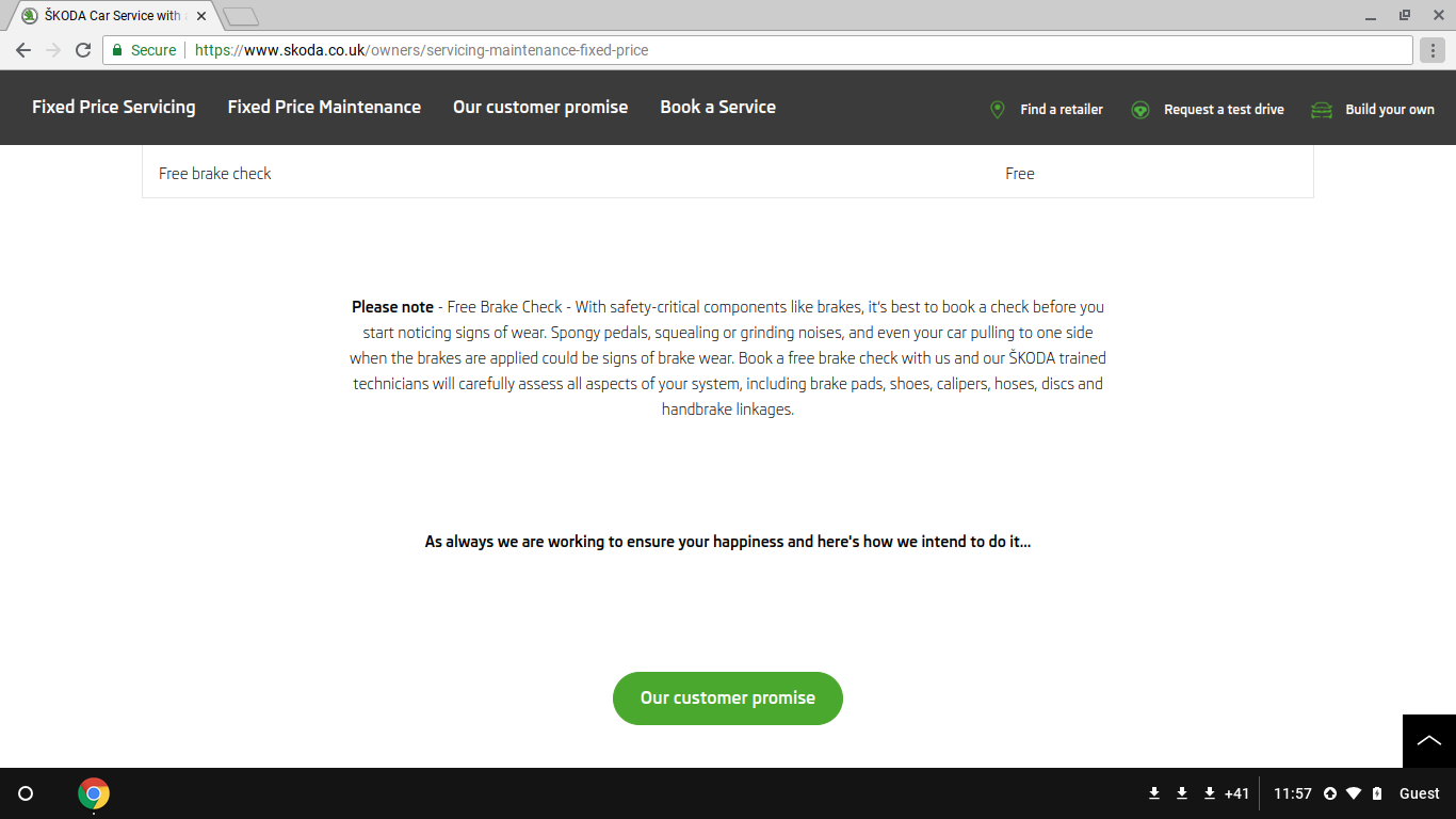

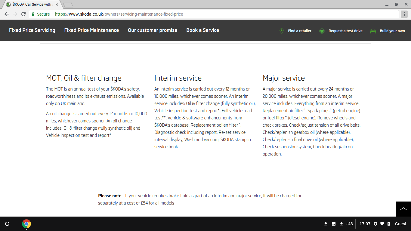

The Current Skoda 'Fixed Price' Service site does say about removing wheels.  (flying pig there.)  But brakes might well get inspected.
The sites on and off for a decade have referred to the cars with Rear Drums by saying that they would be cleaned.
They also said 'remove wheels', and some seemingly inspected from behind as you can, with wheels on.
The 'Dynamo' / Paul Daniels type ones could clean out the brakes without removing the wheels or drums.
