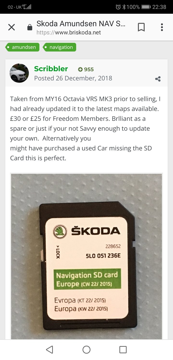

1 hour ago, Sparky73Ni said:
Skoda one
That's for a MIB2 Amundsen, if your Octavia (like mine) is an early 2015 build then it will have a MIB1 Amundsen and you will need a 5E0 051 236 SD card not the 5L0 051 236 pictured.
Edited by PetrolDave
ive upgraded my HU to MIB2 amundsen and it uses that card although its a 2014MY
I'm slightly confused about the maps in my car as I have full EU maps, but I don't want to update them because the new offerings are worse.
Not that Dave needs a confirmation, but I have that very card pictured and in my MIB1 it no worky :shake:
