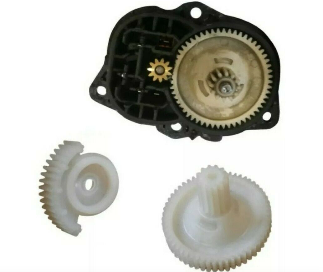

Have been looking at the common cause of the egr problem on the Skoda 1.6cr and it seems the plastic cog that is driven by the metal gear on the motor causes the plastic gear to strip its teeth on not move the mechanism throwing up a fault code P0403
Now £800 to replace this item seems a lot of money
On a well know auction site there are plastic gears available to purchase to replace the gear at fault for maybe a £30 fix
Looking upwards under the car (see pic) you can see the housing the gear sits in and removing the 4x 2.5 Allen headed bolts and the electrical connector would release the mechanism
The gear in the housing can then be swopped over and the housing placed back onto the egr and bolted back up and electrical connection plugged in
anyone tried this? may give it a go this week

The real question is why the plastic teeth sheared in the first place.
Could it be that the whole assembly is full of carbon coke and that the gear drive motor was asking the gears to take excessive torque? You may still need to drop the egr unit to give it a decoke.
There are pictures elsewhere on this forum of totally blocked valves, especially those that had the emissions fix where the valve is forced to work over a larger range of movement.
Yes the crud could have caused the gears to jam and the metal gear just sheers the teeth off.
