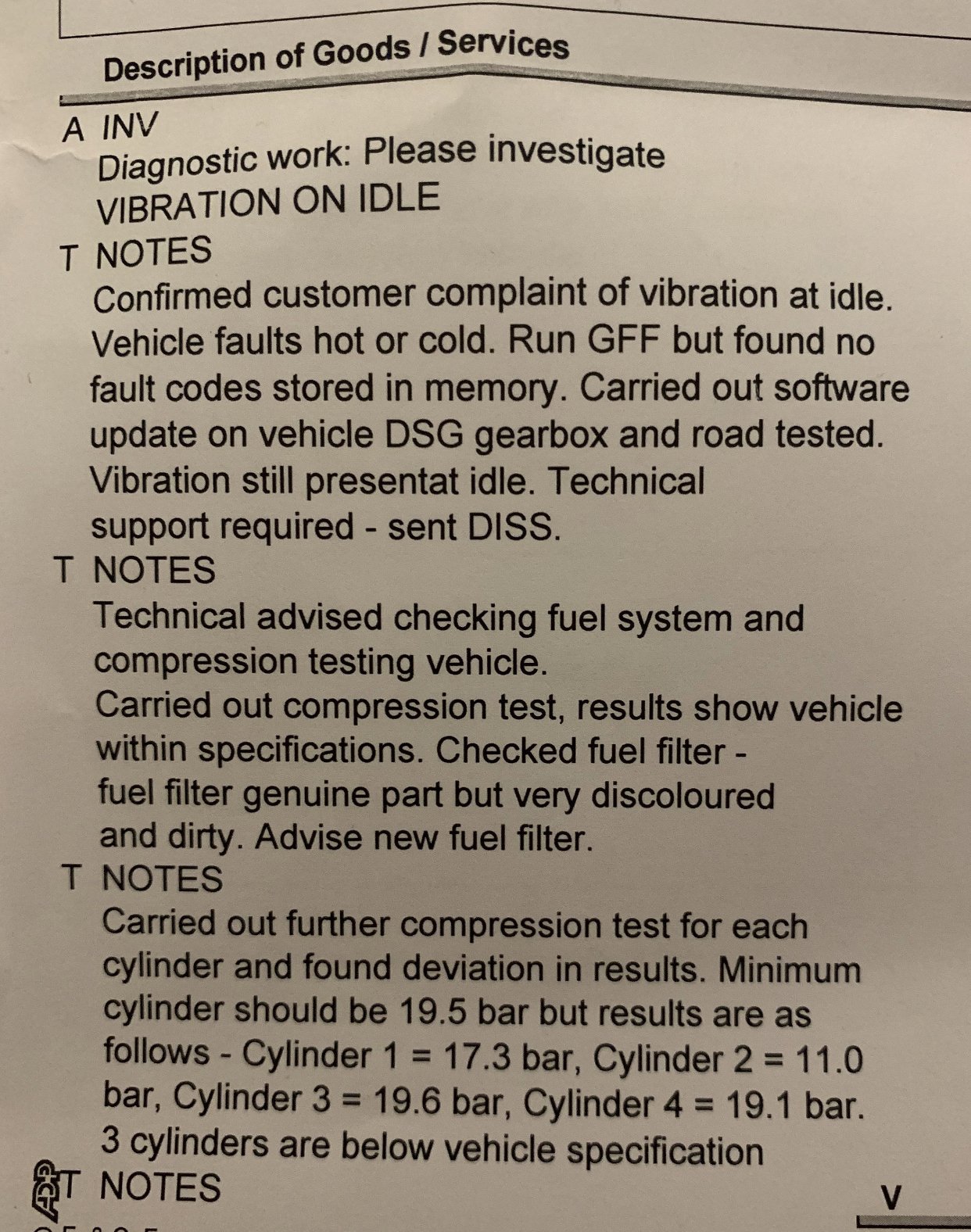

First visit : They made a software update on the DSG gearbox

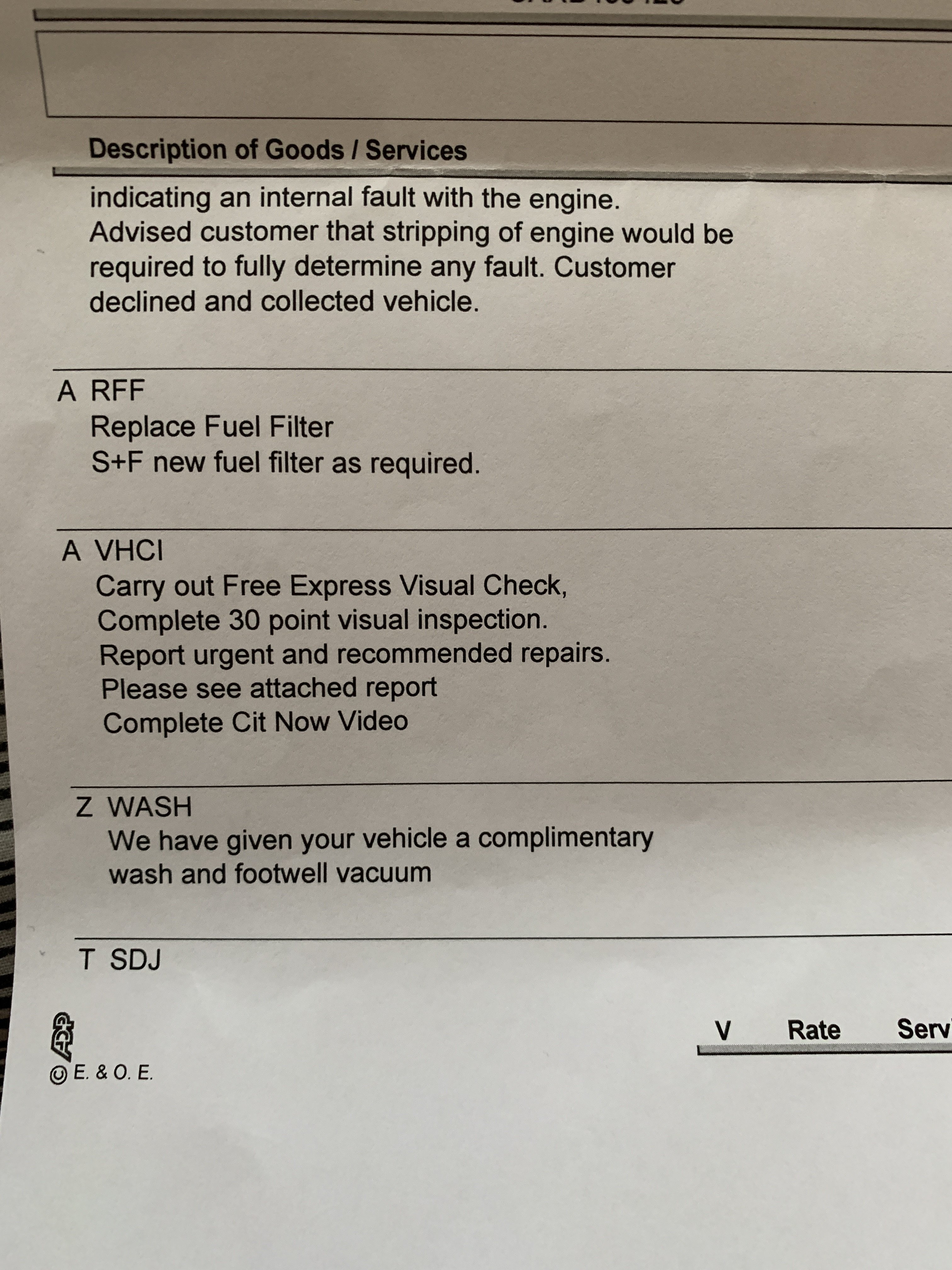

Second visit : They changed fuel filter(not solved) , they have discovered that  cylinder 2 has a low compression and for that the car woould need 8 hours labour (£899) and only after they remove the top of the engine they will find the problem eventually and could need a new engine after that.Of course i have refused

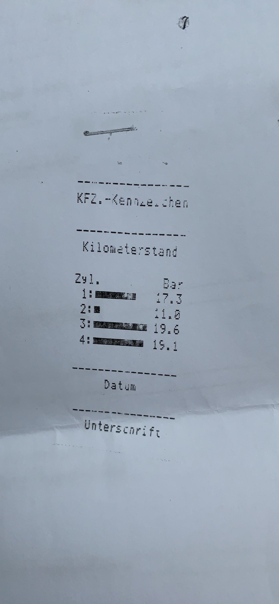

@Darck11 - I repeat, have they done a wet compression test? A dry test will tell you that the compression is low, but not whether the problem is cylinder head (including gasket) or piston rings. If the CR rises on a wet test, that means it's rings.
I don’t know exactly what test has been done to be honest but the thing is i cannot come back to them as we argue..those papers have been provided to me
Yeah; that's exactly my point. They seem to want to do a full engine strip without actually trying to diagnose the fault first.
  • Sponsor
I think you need to visit another dealer, or another Skoda specialist garage.  The fact that this place did two compression tests and one showed no problem, the other showing significant problems, leads me not to have confidence in their work.

basically the Skoda garage did :
updated DSG gearbox software and they said is fine ,gave me the car..wasn’t fixed
second time they said it could be the fuel filter,they changed it..wasn’t that the problem
they have done that cylinder compression test and discovered that is to low there and they need to take off the top of the engine to see where is the real problem and after that they can provide me an exact symptom.(Could need a new engine)

@Darck11 - As upthread, a single dry compression test tells you if the compression is acceptable or not. You then need to perform an additional wet test to identify further where the problem is, if the compression is not acceptable.
