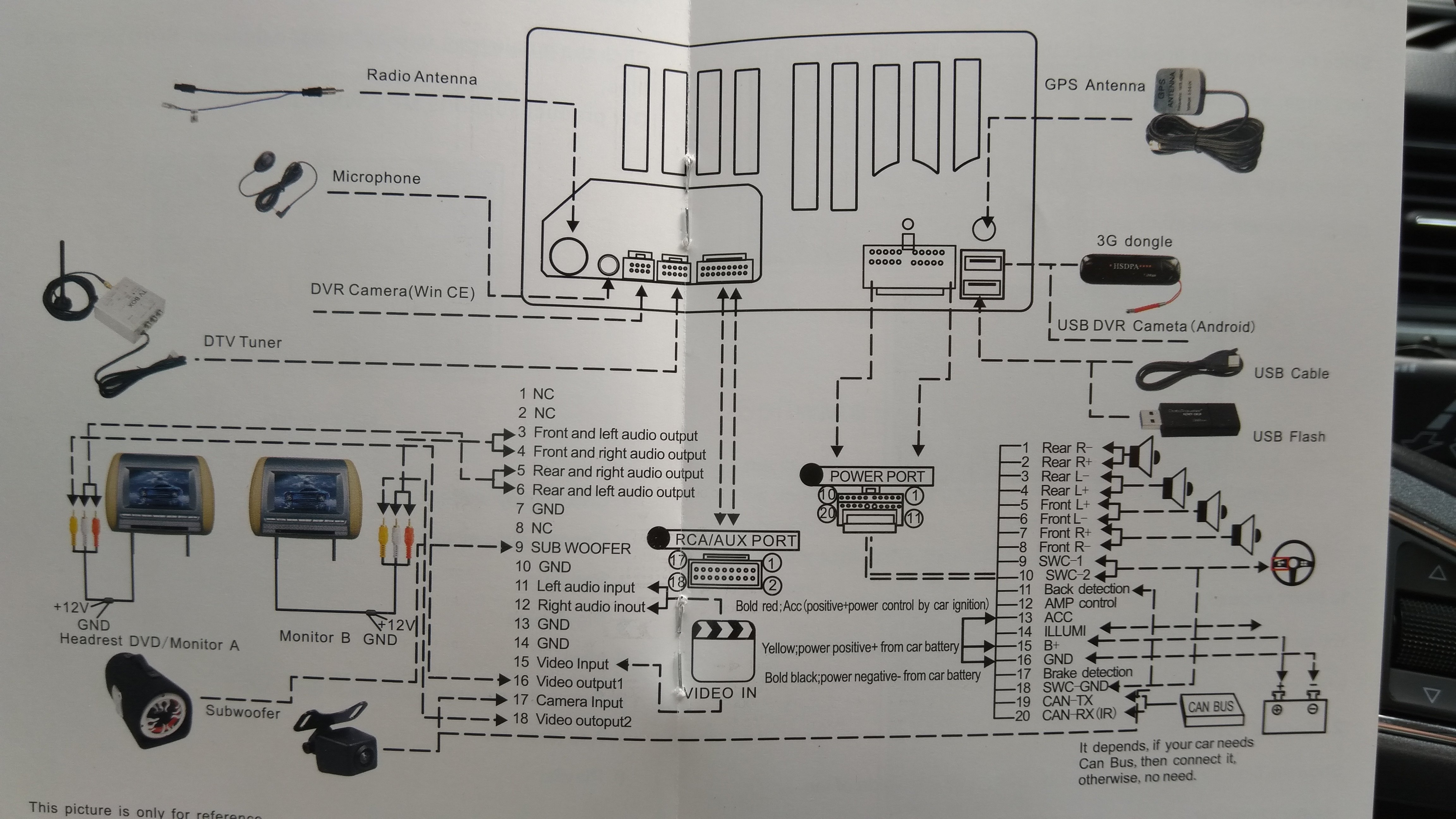

Currently trying to install an android head unit from Audio Tech Direct and I've got a bit of a wall.

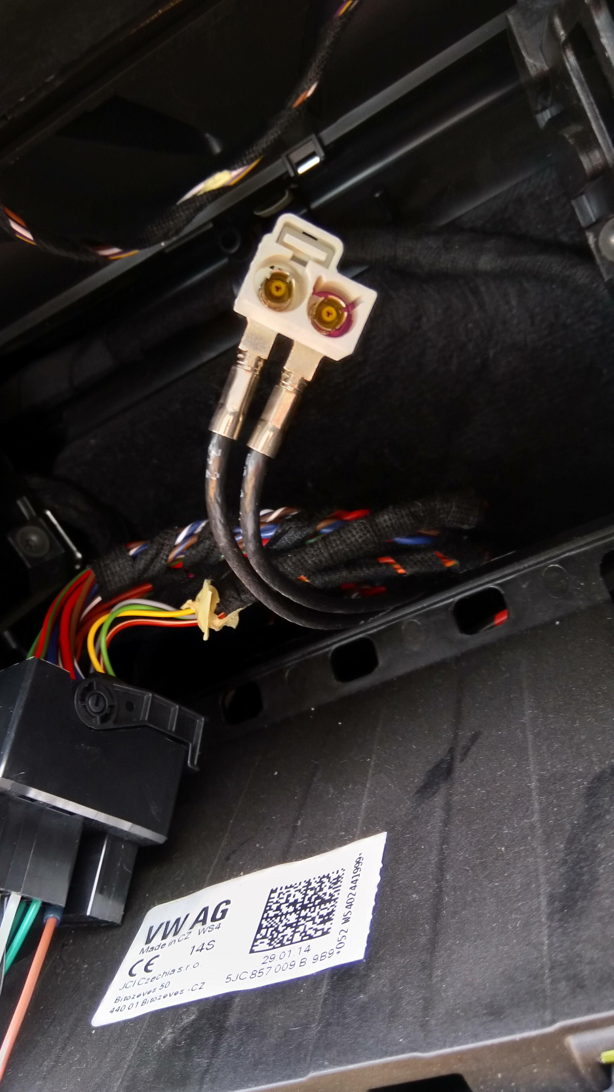

Taken out the old swing radio without issue and connected up the wiring loom, but there are two connectors in a little white plastic case labeled 1 and 2.
I've got a USB cable to keep the factory fitted USB port in use (this cable plugs into the head unit but the other end seems to have 4 metal pins in the connector) and a cable for the radio (which seems to fit the 2 connectors very well) but I'm stumped as what the two connectors actually connect  to?
Anyone got any advice?
AM/FM antennas
One hot wire antenna and second hot wire earth... You need adapter: VW Fakra adapter

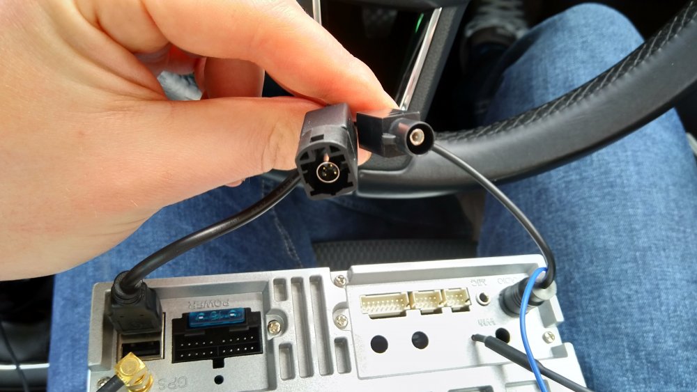

Thanks for your help! Purchased the correct cable and now the radio works brilliantly.
