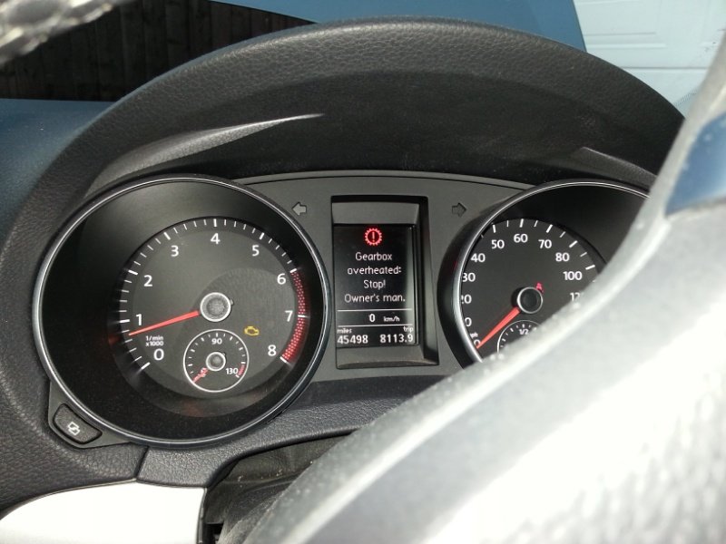

I would not expect the 'Flashing spanner' with your DQ200 car.   That is for those late 2012 that supposedly had Synthetic Oil from the Factory and
did not require '34F7' for those 2009-2012 DQ200 or '34H5' for those 2013-2015.
So just the flashing gear Numbers.
The flashing Gear Cogs are overheating.
Hopefully you can get someone with all the gear and more than just an idea and know what is what to diagnose and repair your DSG, and it is a simple repair.

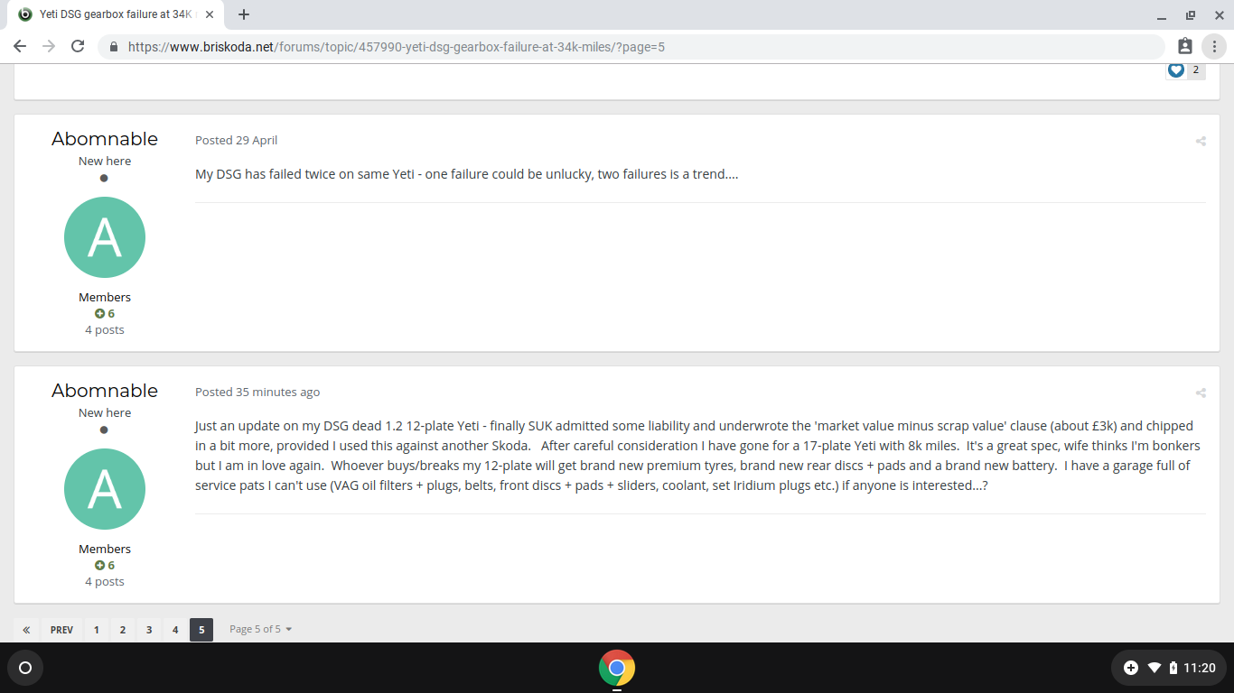

Post from a thread in the Yeti Section.
Flashing gear selector is never good sign, Very much sounds like the mech unit is on its way out.
There is a problem.
Mid to Late 2012 DQ200 DSG's like @Sittingbull has and others. More and more of these are failing.
They supposedly had Mineral Oil from the factory and did not require '34F7' so the change to Mineral oil & the Software Update,
and did not require '34H5' the Software Update some required from 2013-2015.
Dealerships / Techs giving the wrong information on the 'flashing white spanner' warning is a problem.

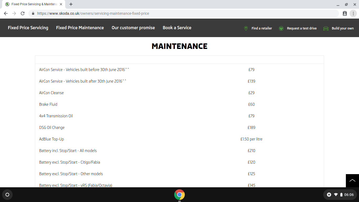

If a Mani Dealership is prepared to change the Oil for you in a DQ200 DSG they might charge the same as for the DSG with Oil changes due @ 40,000 miles,
so £189.

£189......not bad in the grand scheme of things...its whether you trust them to "actually" do it.
Firm believer that there is no such thing as "filled for life"............on anything !!
What it really means is, once the oil has reached it's servicable life (which it will) , the box packs up.
