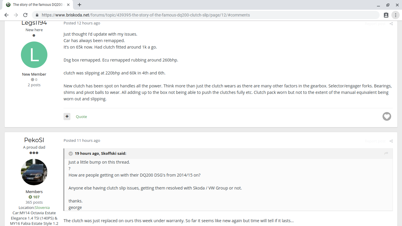

A recent post from a new member @Legs1194,
More info on the cars mods would be nice.
