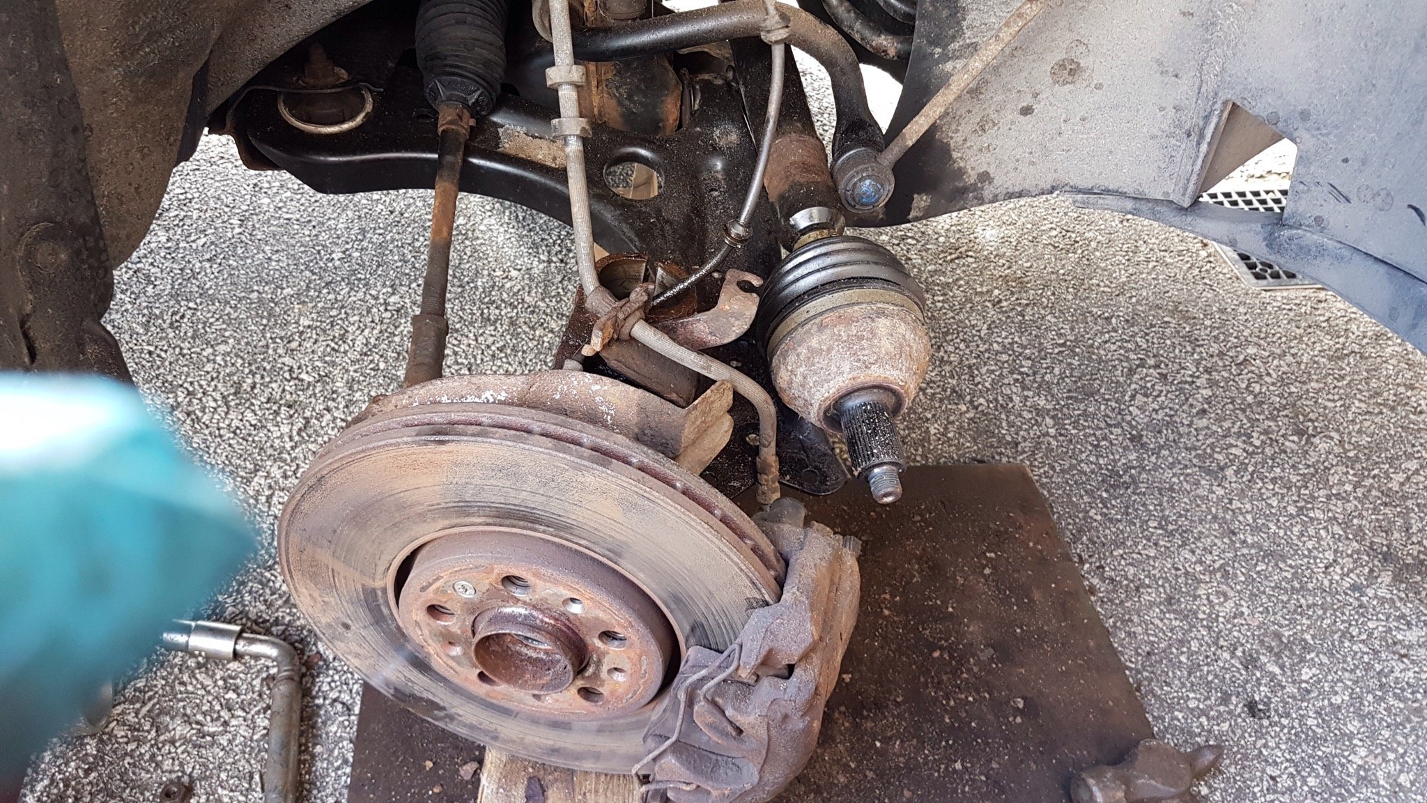

Finished this job. What an utter pain in the ****. :@
First up, bought the SACHS springs from Euro Car Parts. My car, 2010 plate must be between model registrations as the top mounts they supplied were not the small bearing sealed versions, but a large cup style bearing similar to Audi A2. Ordered a Meyle version as driver's side top bearing was fine.
Next, to get the struts out, I removed lower balljoint, I had to purchase an M14 splined bit (1 hour round trip) for the strut-hub bolt which is fixed with an M18 nut. Also had to remove the drive shaft hub nut, so assembly could pull out. Oh, and drop links top (where it connects to the strut) need to be removed.

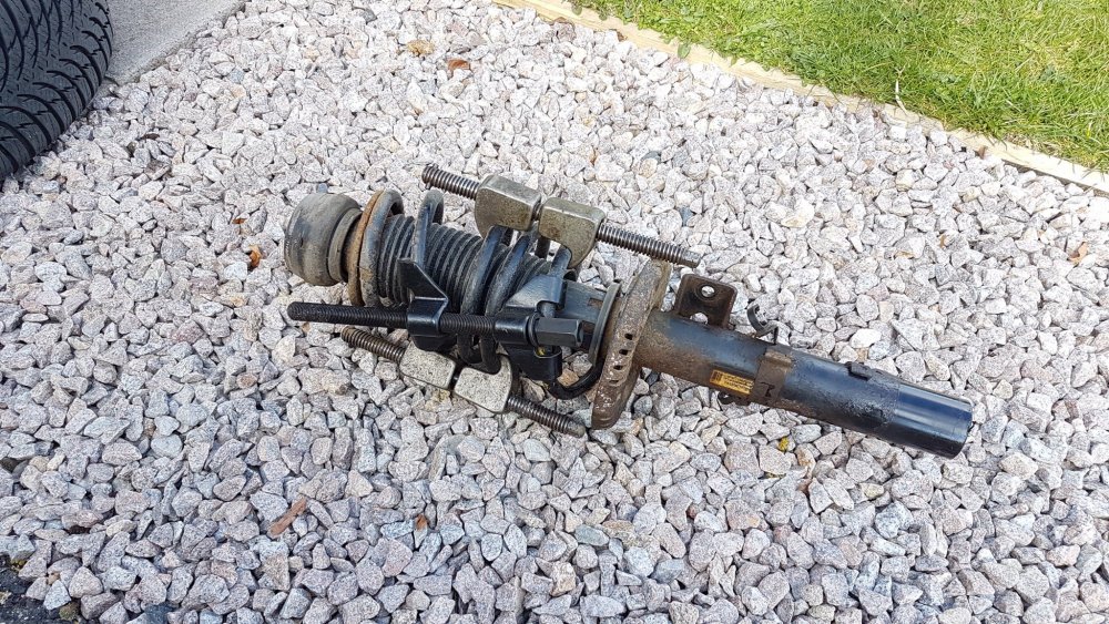

Driver's side was fine, passenger side was a pain. The lock nut on the top of the strut that holds the rubber bush and bearing in place is M21 size. You need a drop ring spanner, but profile needs to be very slim. Another 1 hour round trip only to find the spanner wouldn't fit. Angle grinder out, and spanner shaved a little to fit! Found one of my Meyle HD drop links (fitted a year ago) that the rubber bush spring clip had detached, so now goosed. Luckily had a spare.
This job wasn't straight forward. Luckily I have another car, but honestly Skoda, whoever thought fitting a M14 splined strut-hub bolt that is going to get seriously corroded should be publicly flogged! Bought Laser tools impact splined bits, excellent quality, combined with extension bar.
Tools wise, two trolley jacks. One to lift the car, axle stand for safety, and the other to lift the suspension assembly. You could use same trolley jack I suppose. Splined bits, especially M14, decent quality for hub-strut bolt. Wire brush first, penetrating oil, then hammer bit in. 36mm socket for driveshaft nuts. Fit new ones on completion. 21mm dop ring spanner (not Silverline tools). To get strut out of the hub, I use the end of a pin hammer where I've made a wedge. Works a treat. Use engine oil to lube when refitting. Spring compressors. I have Draper and Laser ones.

More than one brand/type of spring compressor does help get control of tapered springs!
