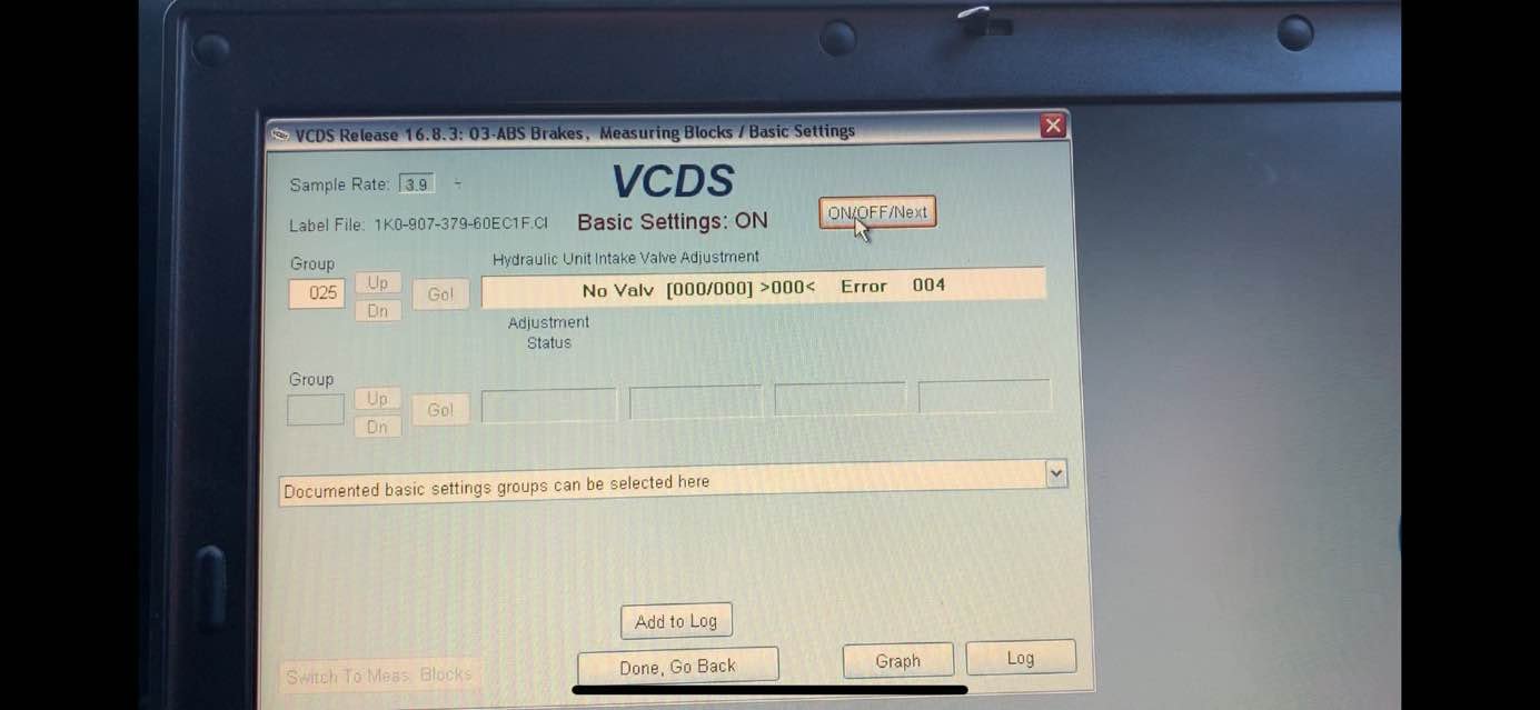

langers2k i did the basic test ....when i click on/off/next on group 025 ........ it shows me noValve [000/000] >000<     Error04
any suggestion

You probably don't need to do group 25.
What does have you currently got and which basic settings have you done?
