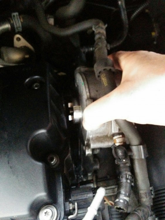

What is the tandem pump? Is that what I think of as the servo vacuum pump? What is its tandem function? Does it act also as a low-pressure fuel pump to raise fuel from the tank and supply the Electronic Unit Injectors?
Richard.
Yes, top right of the engine. The unit bolted onto the right hand end of the camshaft. It is driven by the camshaft and contains 2 pumps, hence tandem, one pumps diesel fuel into the fuel rails in the cylinder head. You will see the metal fuel pipes along the top front of the engine going to and from the pump. The from is just the unused fuel return, the actual fuel to be used pumps into the head itself. The 2nd pump is the vacuum pump with the vacuum pipe attached to the rear.
I had to change the gasket once on mine due to it leaking oil down the rear of the engine block. I managed to swap the gasket without removing all the pipes. I just got enough clearance to remove the old gasket, clean up the surfaces and place in a new gasket as this picture I took shows. You can also see the drive slots here that engage in the camshaft. Once the gasket was replaced the oil leak was gone.
