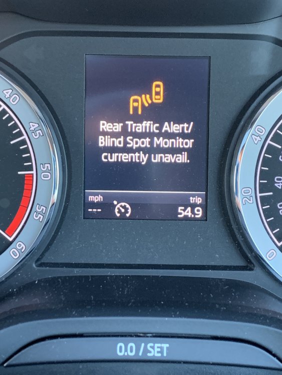

No tow bar fitted. Tried it again recently and got this up as well
The 'Blind Spot Assist' sensors are in the rear bumper.
The reason the system is disabled with a tow bar fitted, and something plugged into the tow bar electrical socket, is that the trailer / bike rack etc. obscure the 'Blind Spot Assist' sensors and would result in false readings / alerts. Quite why they have to be manually turned back on again is strange, you'd think the car would know when the trailer lights have been disconnected i.e. the obstruction is no longer there, and automatically reactive the sensors. Even on Kodiaq's with the factory fitted tow bars the 'Blind Spot Assist' has to be manually turned back on if reverse gear has been engaged (after something plugged into the tow bar electrical socket has been removed).
As you have no tow bar fitted, and as you're getting the 'sensor obscured' warning only when you place the car in reverse makes this sound very much like a software issue related to the settings designed around a prospective tow bar fitting.
As with many of the other technologically advanced systems fitted to the Kodiaq, Skoda are continually issuing software updates to correct known issues and gremlins.

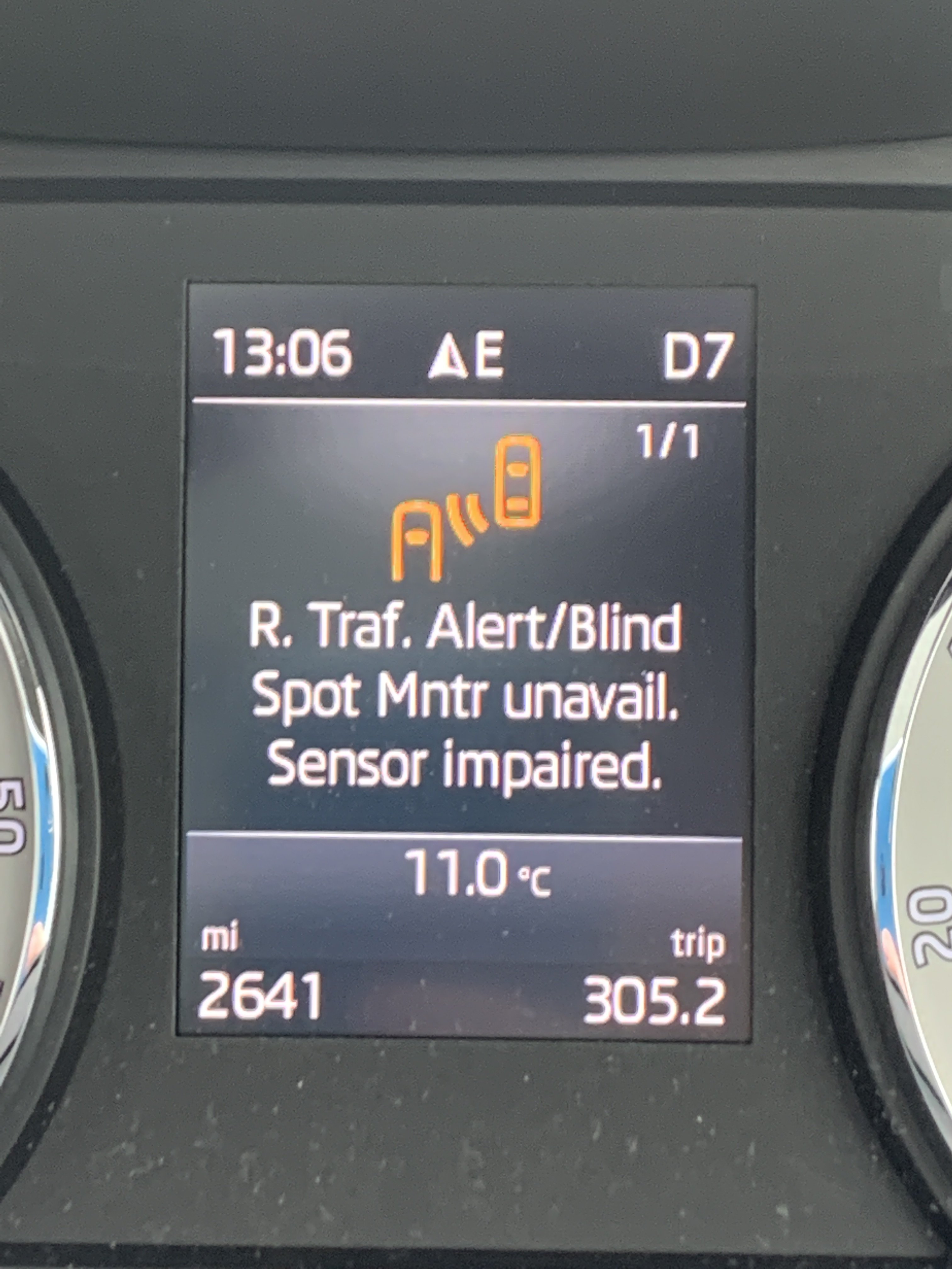

The other error I get is this
The dealer genuinely hasn’t had this before and don’t really know what to do apart from ‘booking it in for an investigation’

This was the same error I was getting when putting the car into reverse, never saw the other one but then it only flashes up briefly so not the easiest to spot!
