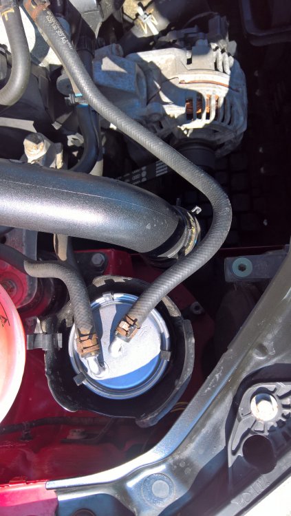

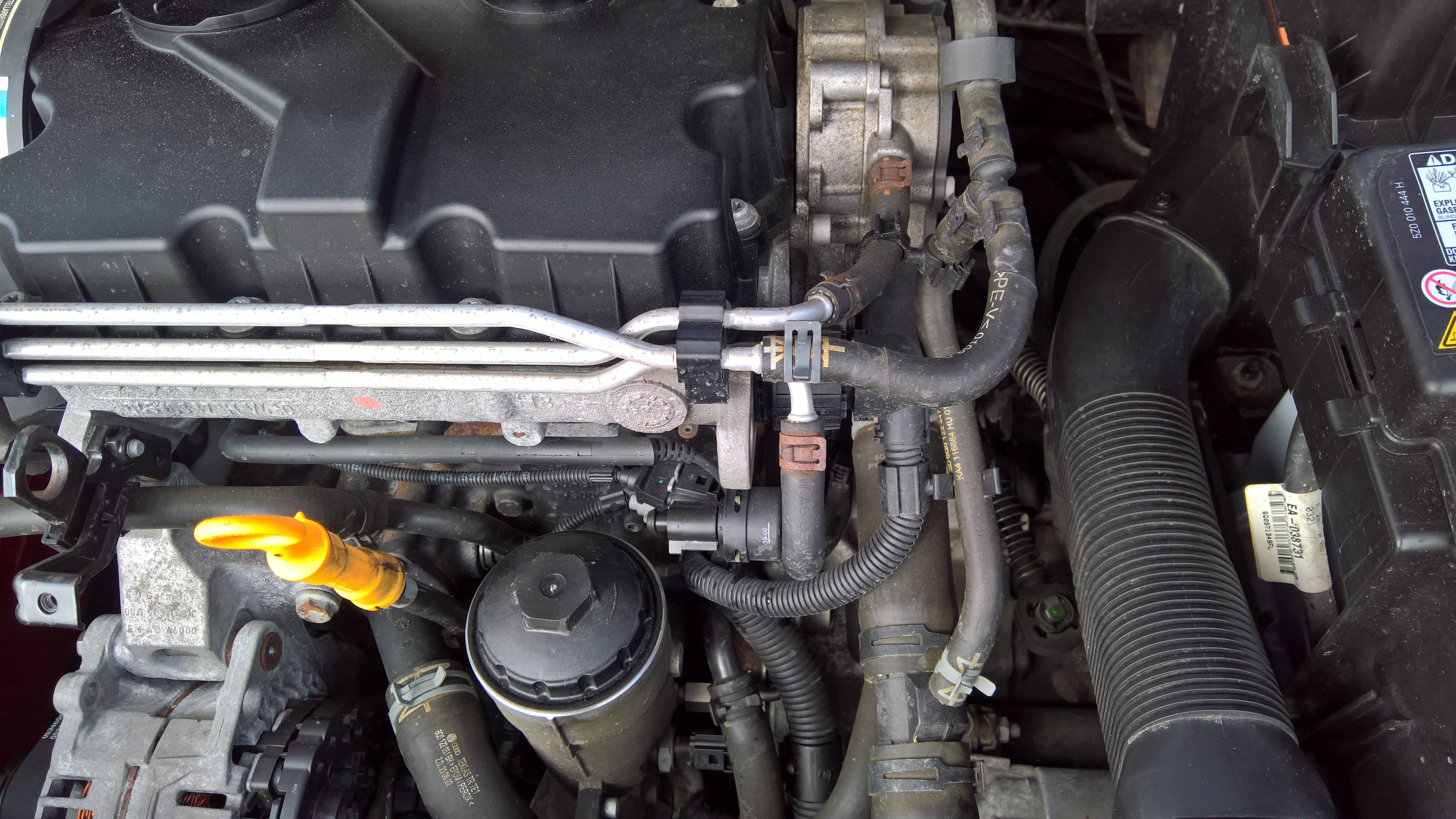

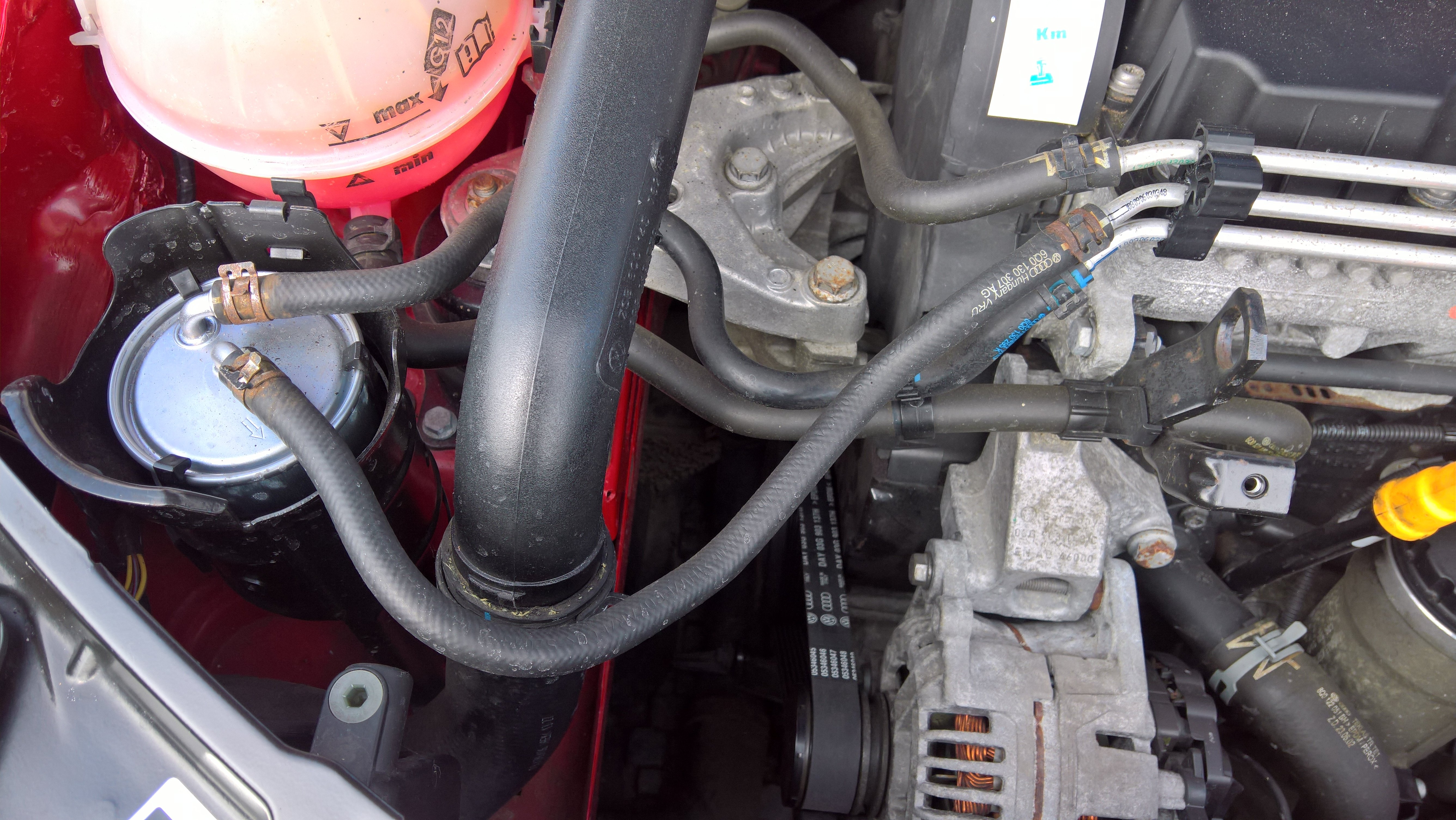

If you post some decent pictures of the fuel pipes in the engine bay i'll tell you what to connect where

large_1st.thumb.jpg.cd8299b7995f152cd436
Take the pipe marked with the green from the filter where the red dot is and put it in your magic unicorn urine. (this is the supply to the tandem pump)
Take the pipe marked blue from the hard line on the engine and attach to red dot connection on filter (this will put the lift pump in recirc to the tank)
You will then need to find another piece of pipe to connect to where you have just removed the blue hose from and put it in to the uniorn urine as well.
DON'T attach anything to the top hard line as this is coolant.
