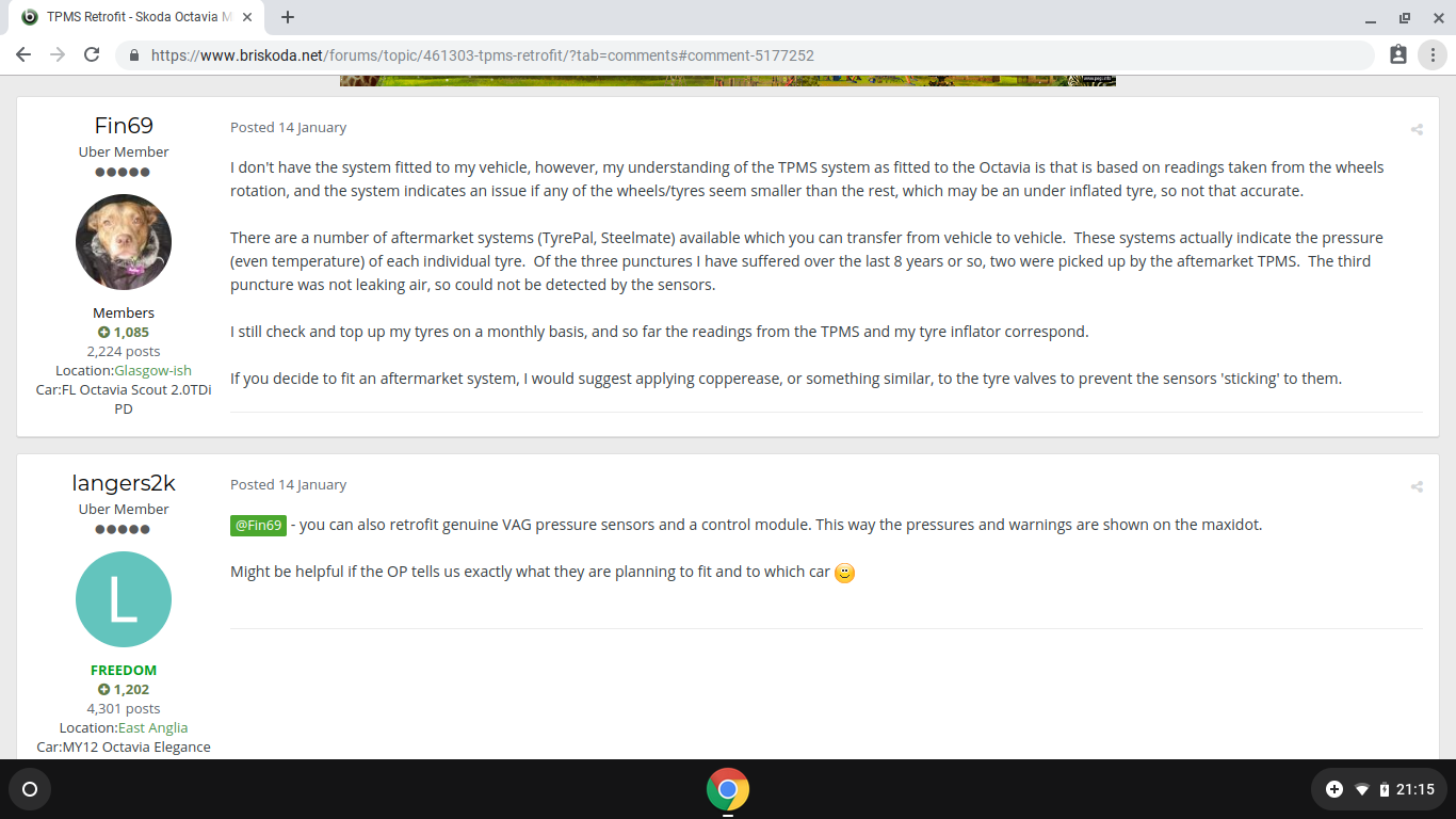

It's this;
https://www.tyrepal.co.uk/product/solar-colour/
I think I may have solved it. The above product was bought to replace another system I had (different manufacturer) due to one of the TPS seizing onto the tyre valve. Took it to one of the major tyre fitters and they cut it off and replaced the valve free of charge.
It threw me that it was a different wheel, but I've swapped from summer to winter and back again since then. So it's possible this may be the wheel with the leaking valve.
2 hours ago, AGFalco said:
Put some grease on the threads to stop then seizing on the valves.
Thanks AG Falco
Lesson learnt from the seized TPS on the valve, I bought a big tub of Copperease and ensured there was a plentiful coating on each valve before installing the TPS.

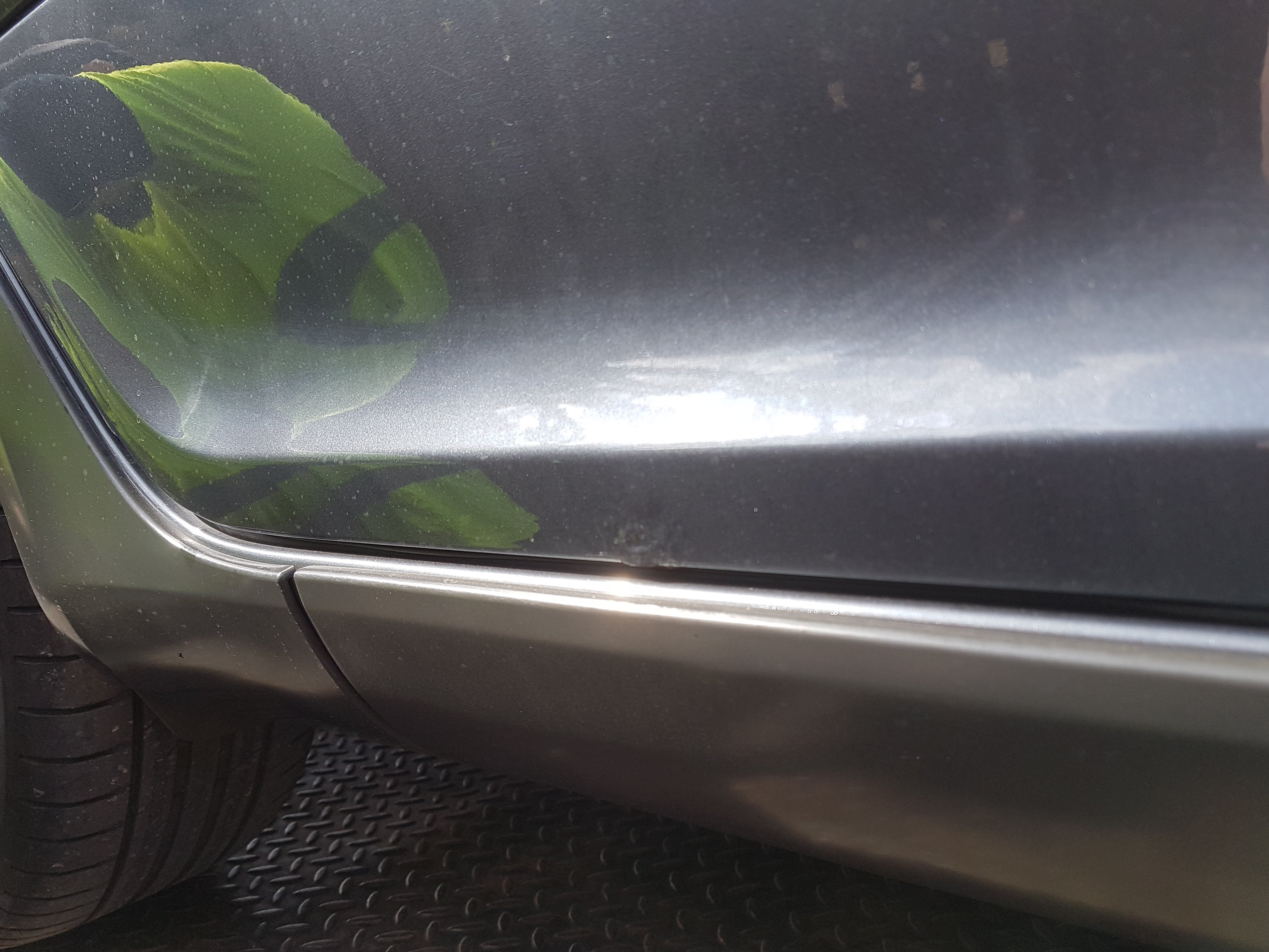

One thing I'm not happy with is, I've just noted a ruddy great big rust patch on the bottom of OSR door. Not that it means20190331_135453.thumb.jpg.42d3b3579c925401b352dd6accb3b063.jpg anything these days, but vehicle was given a clean bill of health at last dealer service. If I noticed it whilst vehicle was raised, why not the' Tech' carrying it the VHC?

Three of the doors have the beginnings of rust in the same location.
