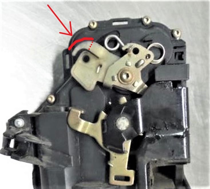

somehow i managed to dislodge this bit (circled) - pretty confident the plastic bit is broken
is there an easy way to get this back together/anyone got a spare bit of plastic? (originally non central locking but someones retro fitted central locking - non working)

Hard to see properly from that pic but it looks like the bit I've highlighted in this pic has broken off? But if it hasn't then there's nothing else wrong with it that I can see. Can you clarify what you mean has dislodged?
Edited by TMB
@SkUG - I'd agree with TMB: Is there a sign of crystaline or corroded metal in the area you've both highlighted?

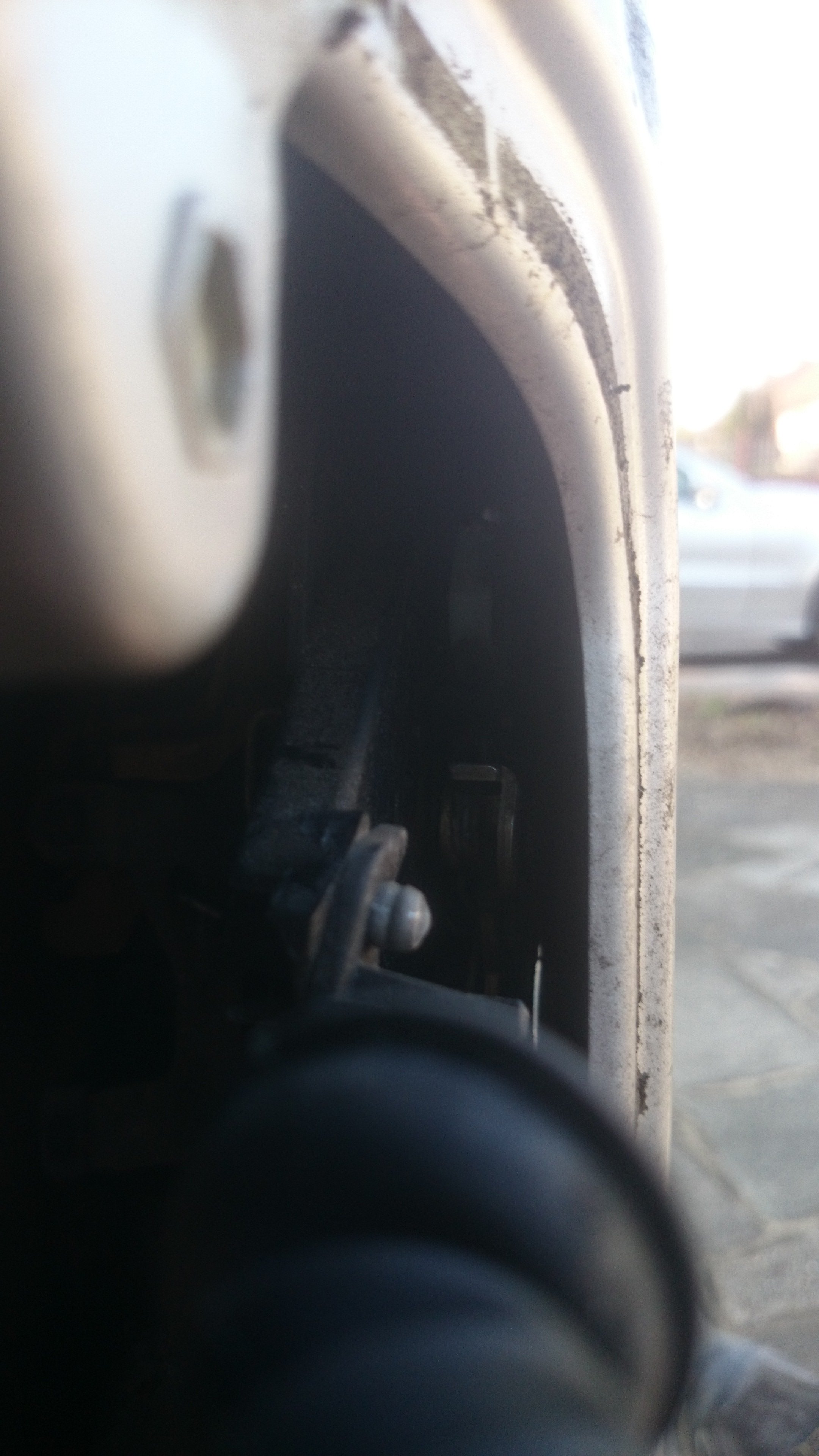

thats not the actual picture of my car - sorry - i tried to take a picture but my camera kept focusing on the car in the background...  i think the hooky bit has been mising for a while (wasnt there last time i opened up the door - PO fitted some dodgy retro fitting of central locking) whole thing crumbled as bits came off in my hand, seemed small enough to be the hole portion if that makes sense?
"disloge" the "pull pin" is no longer attached to the white plastic bit as it appears to be broken...
Edited by SkUG

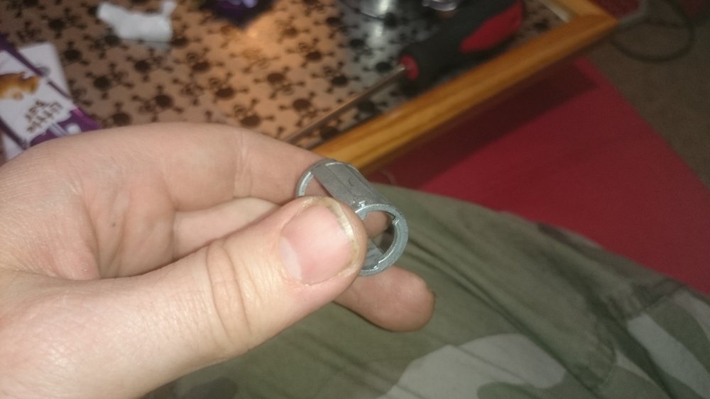

Meanwhile...  wheres this supposed to go? Door lock seems to work perfectly fine without it... Fell out when i took the barrel out

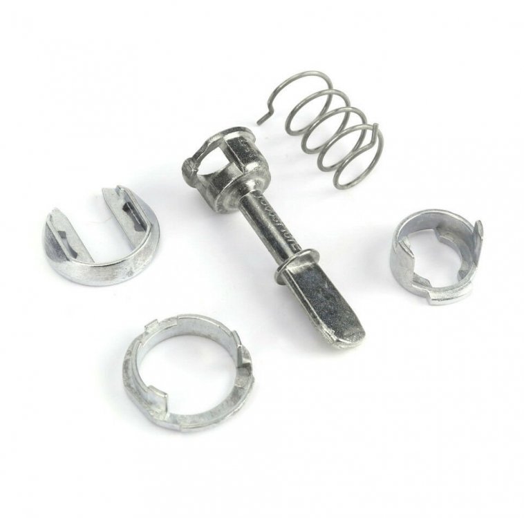

Part of the assembly that transfers movement of key/barrel to the lock mechanism. Five bits as below.
Yes but where does the bit in my hand go in relation to those bits ive just replaced( all five bits in your picture)? It was loose inside the door!

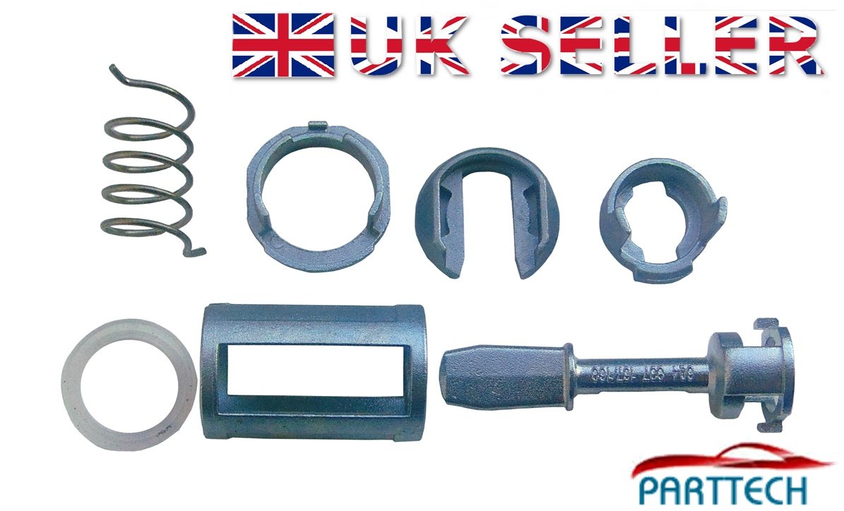

Part 6
Edited by SkUG

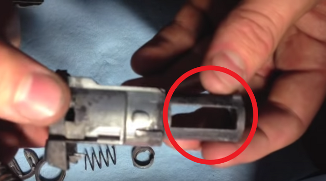

Sorry. I was wrong. That 'barrel' bit goes inside the lock housing and the lock cylinder with all the pins in it goes inside that 'barrel' and the pins when they key is out stick out into the side gaps. The transfer bits in my pic stick on the other end from the key of the cylinder that goes inside that 'barrel'.
Correcting the terminology it is the lock cylinder. The bit it fits into is just called the cylinder housing and the bit that fits inside the cylinder and has the pins in and which is the bit the key fits in and turns is called the plug! Here's a key in a plug. Pins have been retracted and lined up by the key. The cylinder should be completely hidden inside the cylinder housing and the plug in the cylinder. The cylinder is inserted from the inside, the plug from the outside of the housing and the five bits both transfer the movement of the plug and hold the plug and cylinder in the housing.

No.. no.. wrong bit! The bit the key goes in (barrel with all the pins) is fitted and all the 5 bits in the picture are fitted and part 6 (the bit in my hand) was rattling about in the door... Door opens and locks perfectly fine without the "plug" (aka part 6)

The piece in your hand is the replaceable insert for the lock barrel. See this video at 3:05....
https://www.youtube.com/watch?v=jf4uLb2IZiU
I should imagine that if you've put the cylinder back together without it, the lock may turn with anything like a screwdriver as there will be nothing for the lock pins to locate into.

I can scavenge the plastic piece from a lock I replaced a while ago.  Can you message me your address and I will post it to you.
i guess i do need that bit... as you said... it opens with a screwdriver - wow - all these years i've had the car (even had to call AA out for when i locked my keys in the car when replacing the battery - doors automatically locked when reconnected!) and i've not tried to open it with another key/screwdriver - hilarious!
Guess i'll be taking it all apart again as the barrel fell out tonight n all
Big shout out to LB123 for sending me a replacement part - you sir are a legend! - now i just need to fish all the bits that fell in the door out again.. lol
