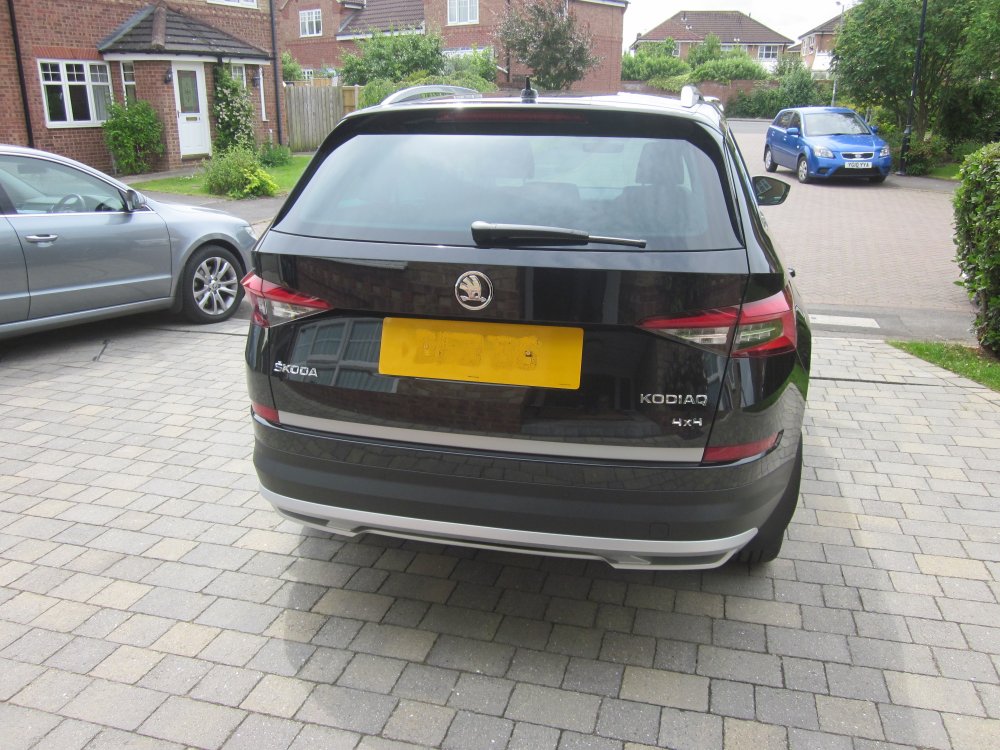

Looks good!
Think there is a distinct lack of chrome on the rear though in general.
A small strip between the rear lights would lift the look of the tailgate a lot.
Thoughts?

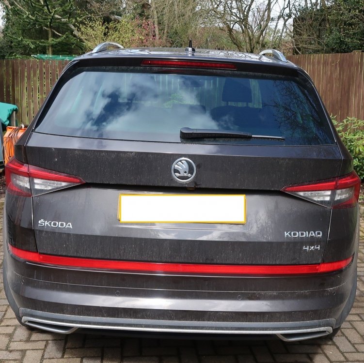

I've just fitted a RS Reflector Bar to my L&K, which I think improves the rear end appearance.
There are 3 parts involved, total cost from my local dealer inc vat - £91.63:
Protective bar - 565807423A9B9
         Reflector - 565945103
         Reflector - 565945104
Fitting does not require the rear bumper to be removed.  There is some minor modification involved in the fitting as the reflector studs protrude through the rear of the bar, that is not beyond the means of an average d-i-yer with a 13mm drill and a dremel taking around 1/2 hour, simply because the RS bumper is not quite the same as other Kodiaq rear bumpers.

(Yes, it's due a first wash!) :giggle:

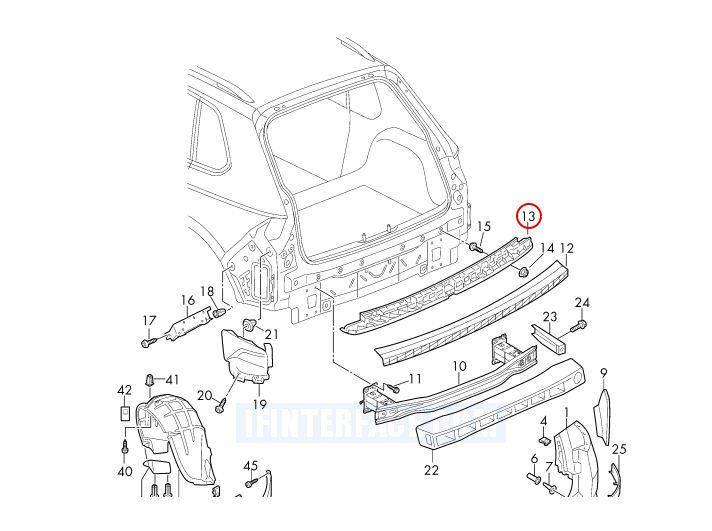

Good morning, first of all, excuse my ENGLISH, I am using the GOOGLE translator. I am an owner of a KODIAQ 1.4 TSI ACTIVE in SPAIN, I have seen your page and specifically what they talk about this article, and I am very interested in it, because I think it looks great, but I have several questions. According to the page https://ifinterface.com/prog/car/cp2/inprog.php several pieces appear in the car, in the rear bumper, Would it be necessary to change the number 13 ?, the 12 I think that if it is the one that is left out and is the one that is seen, If so, how much would that piece cost? because 12 is clear to me its price, but 13 does not. Would someone in the forum have changed that piece? or there would be a kind of instructions on how to change it. the centerpiece, are two or one whole? Thank you very much for your attention. and excuse my discomfort
If I'm reading the previous posts correctly, the new reflective strip replaces part no. 12.
Part number 13 remains in place, but needs to be drilled / adjusted to allow the new reflective strip to be fixed to it.

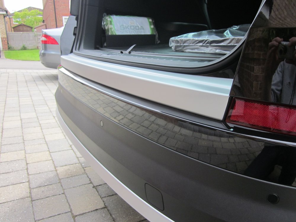

I went for a silver strip to match the silver effect plastic already fitted to the Scout model...

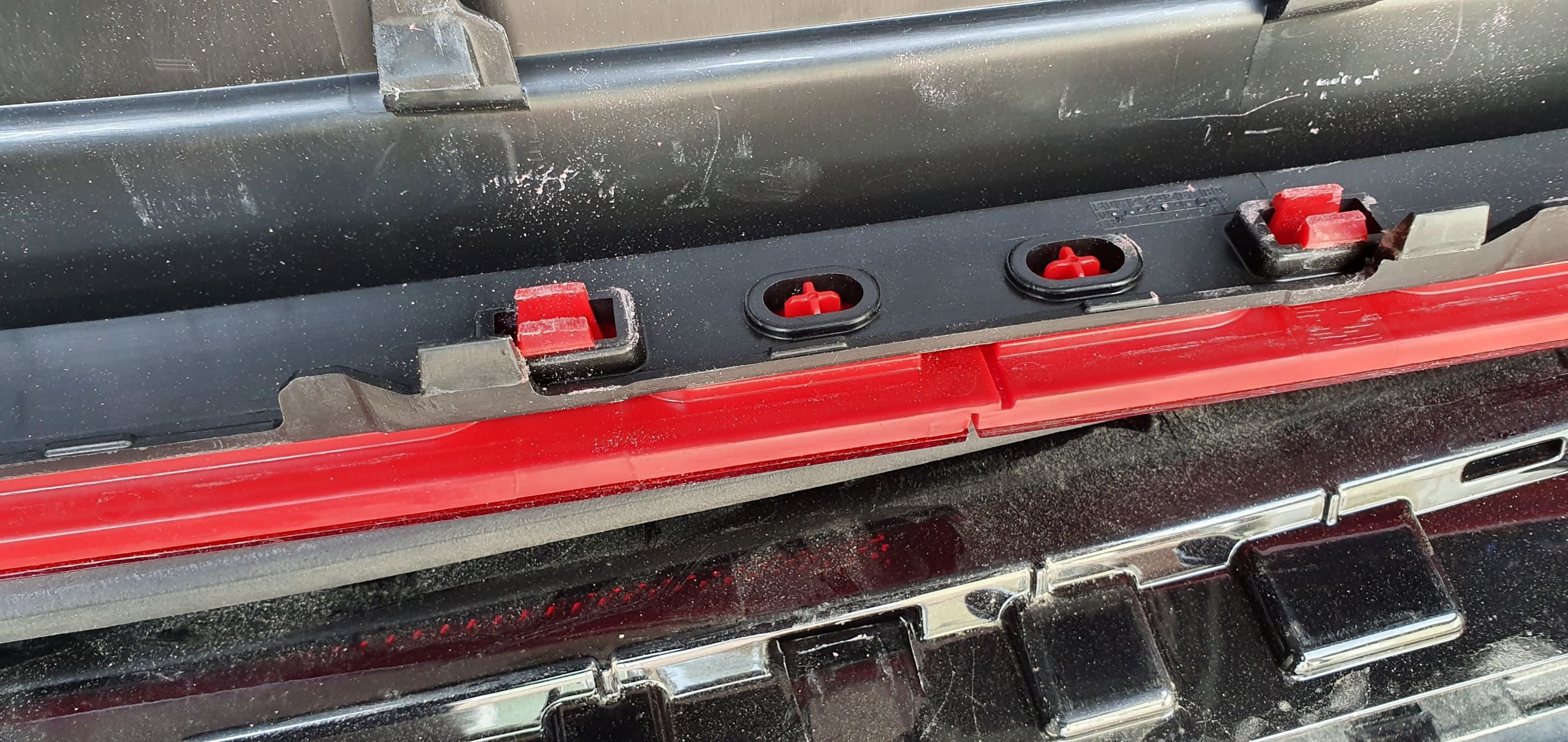

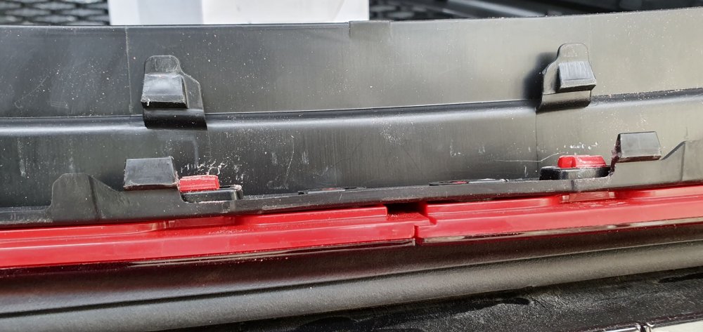

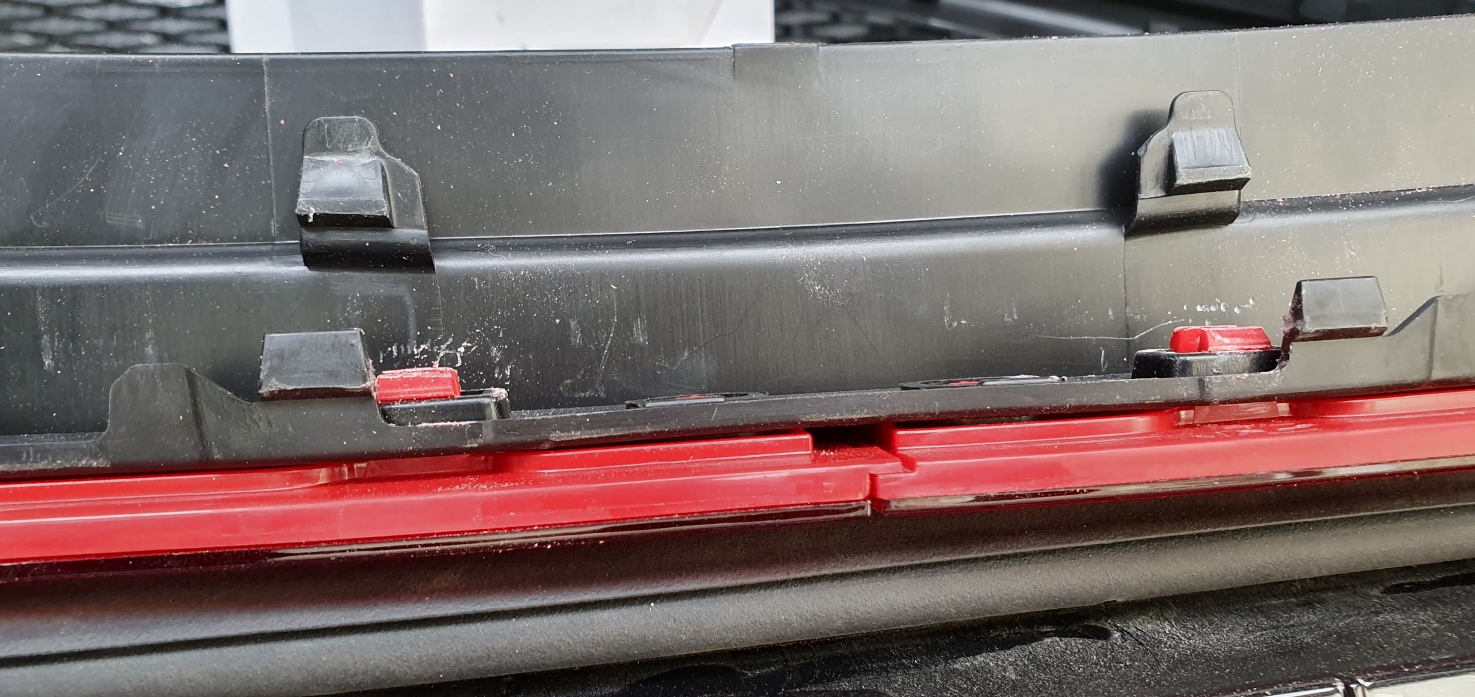

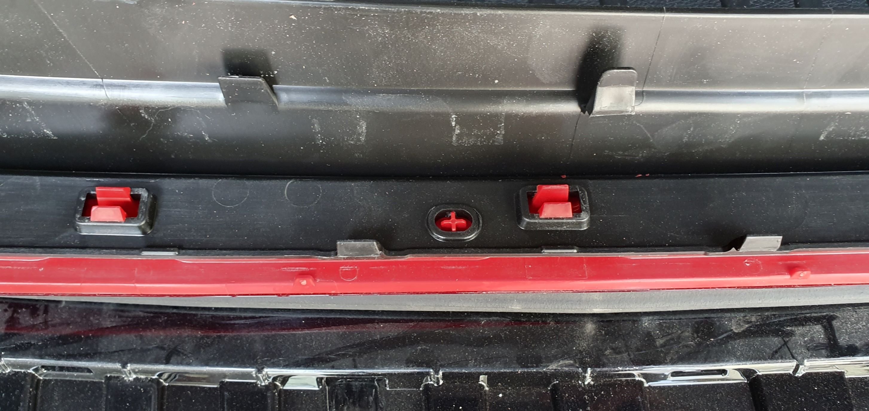

With kind thanks to Ralf Braumann for the photos, here's hoping this helps clarify fitting:
1. Lever out and then pull slowly backwards:
2. As it is “naked”:
3. Mark holes for clips, drill holes and mill out with Dremel or similar:
4.  Protective bar complete with the 2 reflector halves - total fitting time about 30mins:
I wonder how long before the makers of that strip (Milotec..?) do one with the reflector instead of the aluminium look?
I like the idea on ones that wouldn't require drilling - makes it easier to put the car back to stock if selling/trading.
Given that retrofitting the genuine vRS reflector strip requires drilling and cutting, pretty soon I reckon :D
Easy enough to put back to stock as the grey honeycomb one simply covers the holes behind!

No need to make holes into your car! Yes, the new bar with the red reflectors doesn't want to 'click in' fully. The reason are the clips of the reflector, which are a little longer then necessary, when clipping into the black bar. However, you really don't have to make any changes to the plate section under the plastic bar. Just shorten slightly (0,5 mm - sharp knife, file) those red clips when they are clipped into the black bar and push the complete bar with the reflectors in place. You don't even have to shorten the clips in the edges -  there's enough space.
