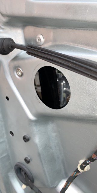

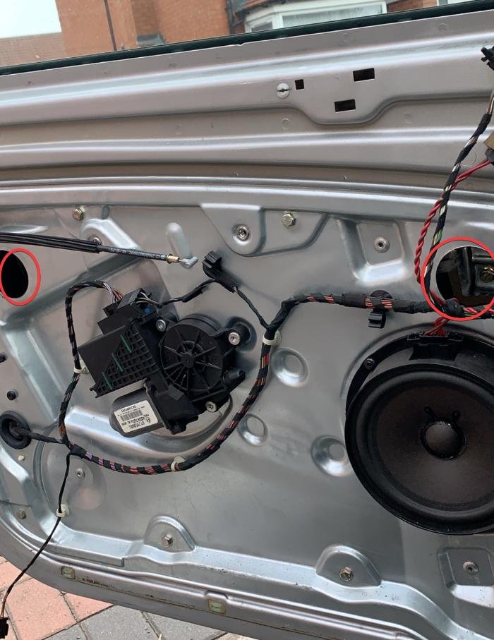

SOLVED! whipped the door car off today and actually found out my passenger window regulator is bolted on whereas my drivers one is actually riveted, this car must have had a passenger door of a pre facelift vRS, however this had nothing to do with the rattle.
For anyone wondering how i did it:
I removed the two rubber bungs on the left and right on the panel and wound the window down till i saw the bolts that are on the window carriers and i actually found that one of them was very loose, I used a 10mm nut spinner and tightened them up and the rattling was gone!
Hopefully this can help anyone else that is having the same problem as i was
Be careful when getting the rubber circle bits back on as you do have to give it a bit of force and in doing so my finger slipped and went straight into the raw metal circle and gave me a pretty deep cut.. silly me.
