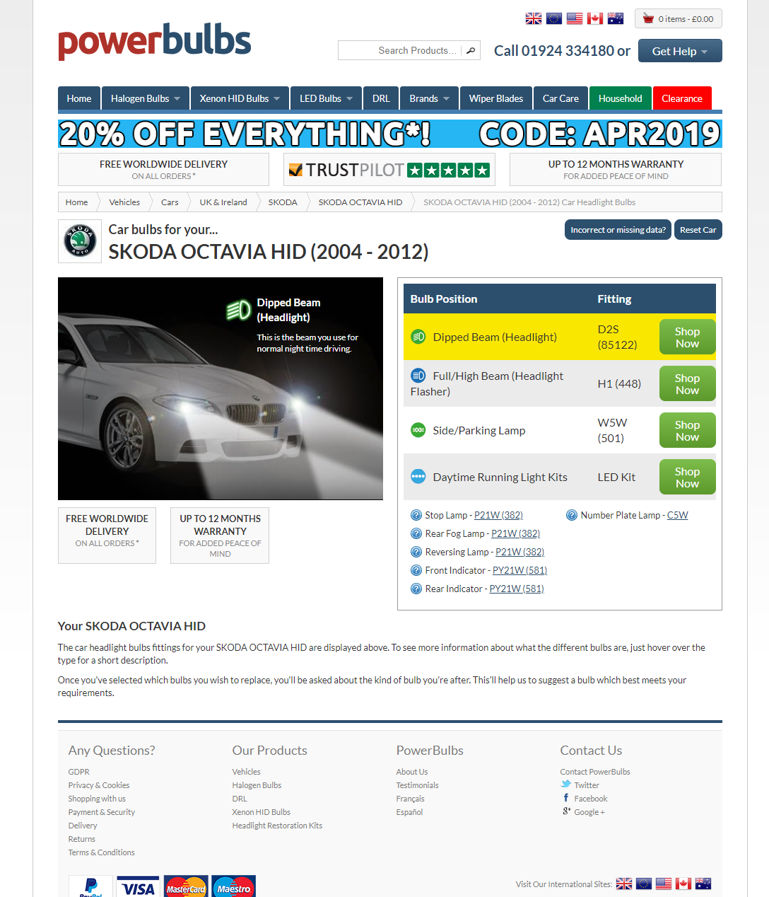

This is what this site is telling me although I am not sure how accurate it is...
I do appreciate all the advice :)
My owners manual says D1S, so that's what i'd go with.
Ah yes, mine says DS1...

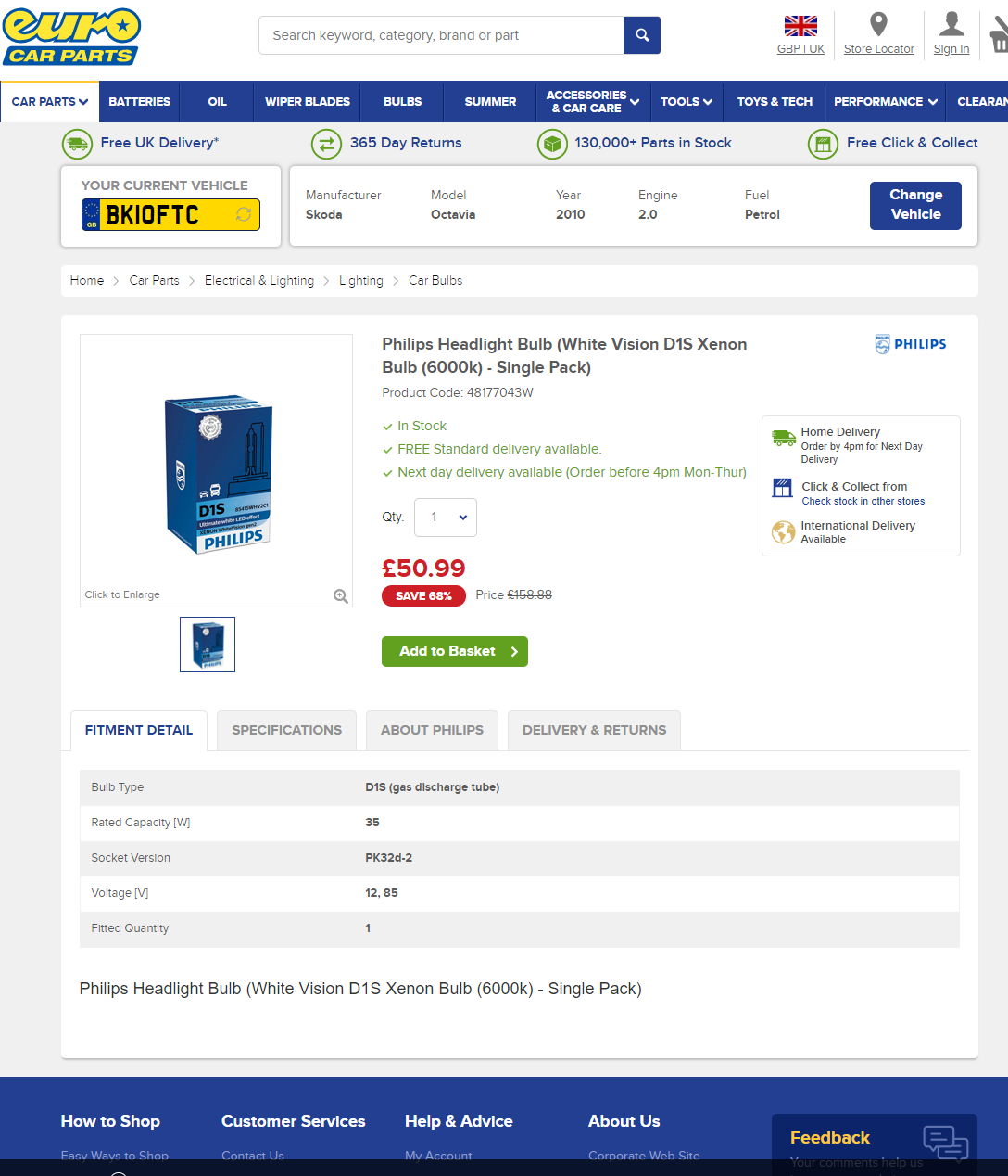

Are these worth getting? Or should I get OEM 4300k or something?
Any decent quality xenon will be fine as they all produce basically the same amount of light. As for colour temperature, around 4300k should give you the most useful light.
