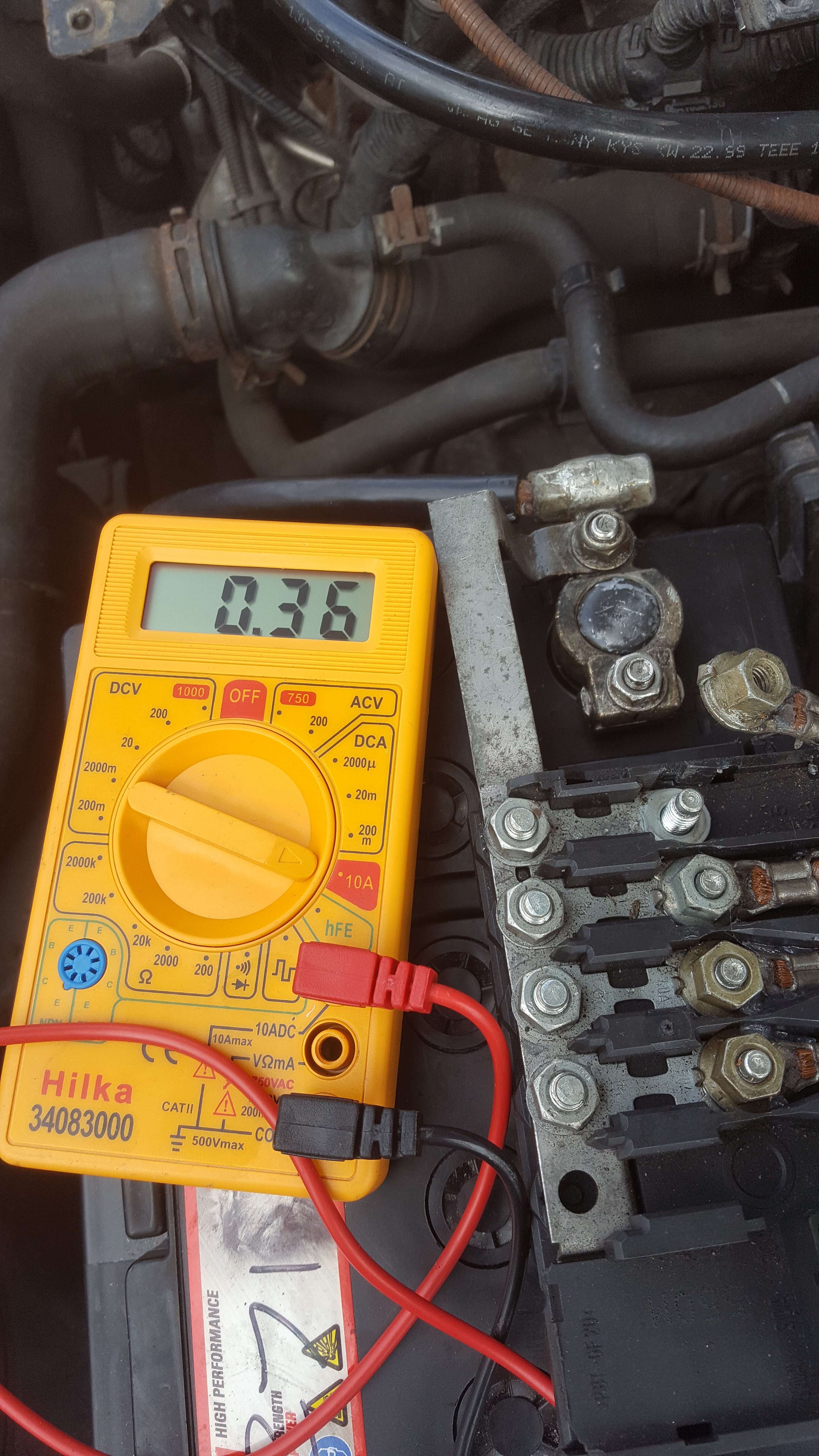

I became suspicious of a parasitic draw on the battery so I checked it out with a meter in line with the battery (neg' terminal). I pulled all the fuses one by one but the drain remained regardless (350mA).  I also pulled my radio just in-case.
Switching on interior lights raised the draw as expected but making sure everything was off and doors shut still 350mA.  It's also a new meter.

I tried as you suggest nige8021 and disconnected the alternator (I did this at the fuse for the black wire that sits on top of the battery, I tested the current draw on the battery again and its still measuring just over 350mA (0.36A on the 10A scale).

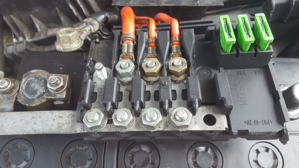

Next things to try are to disconnect each of those other strip fuses, and the three green blade fuses, one by one and see which of them is conveying the current.
If you tell me what year the car is, I can probably tell you what each of those fuses does, later.
Big red cable is probably everything interior, so a good one to rule out.

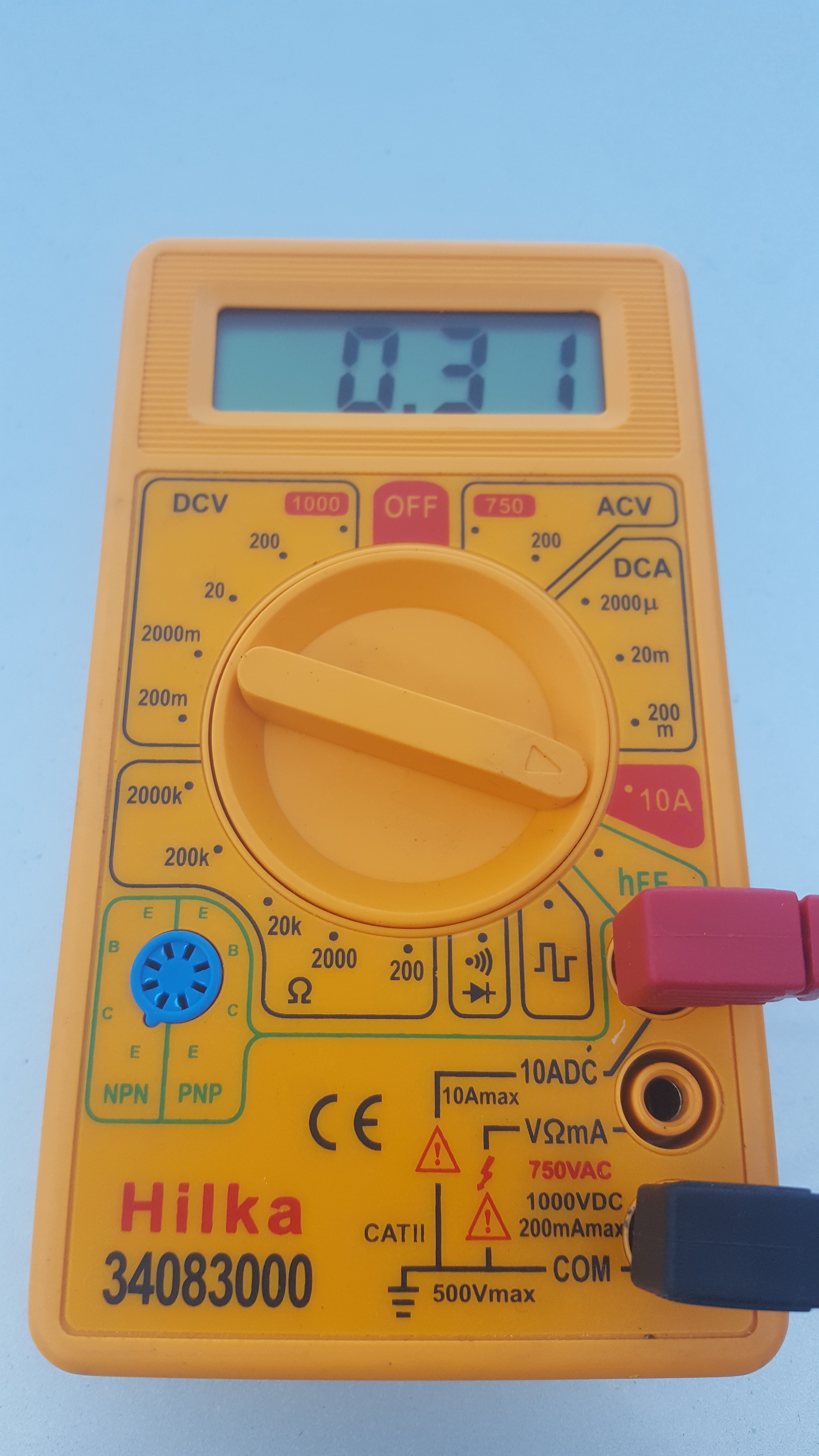

Ok, I left the meter connected while the car sat for 2h 20mins exceeding the recommended 2 hrs.  The current draw had reduced to 310mA .
The only variable which may have confounded this experiment is the fact that I had to manually lock the car because the central locking is temperamental and 'decided' to be broken this evening.  The current draw did drop by 50mA so I am going to assume that the car did actually go to sleep- it also rose to almost 500mA after I unlocked it suggesting that it 'woke up' once I unlocked it.

I finally got round to some more testing.  I did as you suggest and and tried undoing those other fuses next to the alternator one.
When I undo the large red one (which I believe is for all the internals) the current drops right off.  I think this one goes into the car to the relay panel under the dash by the drivers knees.

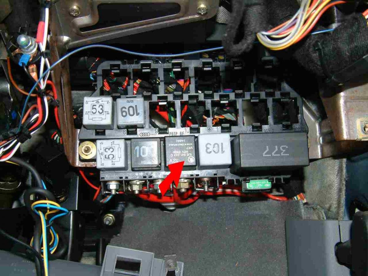

I pulled the panel and tried unplugging each relay one at a time in case there was one stuck on or something... still no change. The current draw drops off when I pull the 30A fuse with the green top which sits underneath the double relay but I have no idea what this fuse is for.

Got a photo of the relay panel?
Ignore the arrow (I nicked the photo from google) but what is that green fuse on the bottom right for?

I have a funny feeling that might be a self-resetting thermal fuse for the electric windows?

Yeah Power window fuse :thumbup:
  • Sponsor
That's saved me a lot of looking though pdfs, cheers Nige. Looked familiar from my mk2 Golf days.

It should be to the right of the position indicated in the pic, but Position B on the early ones wasn't allocated and on the May 02 > it was for vacuum pump in position B and pos C for the windows
