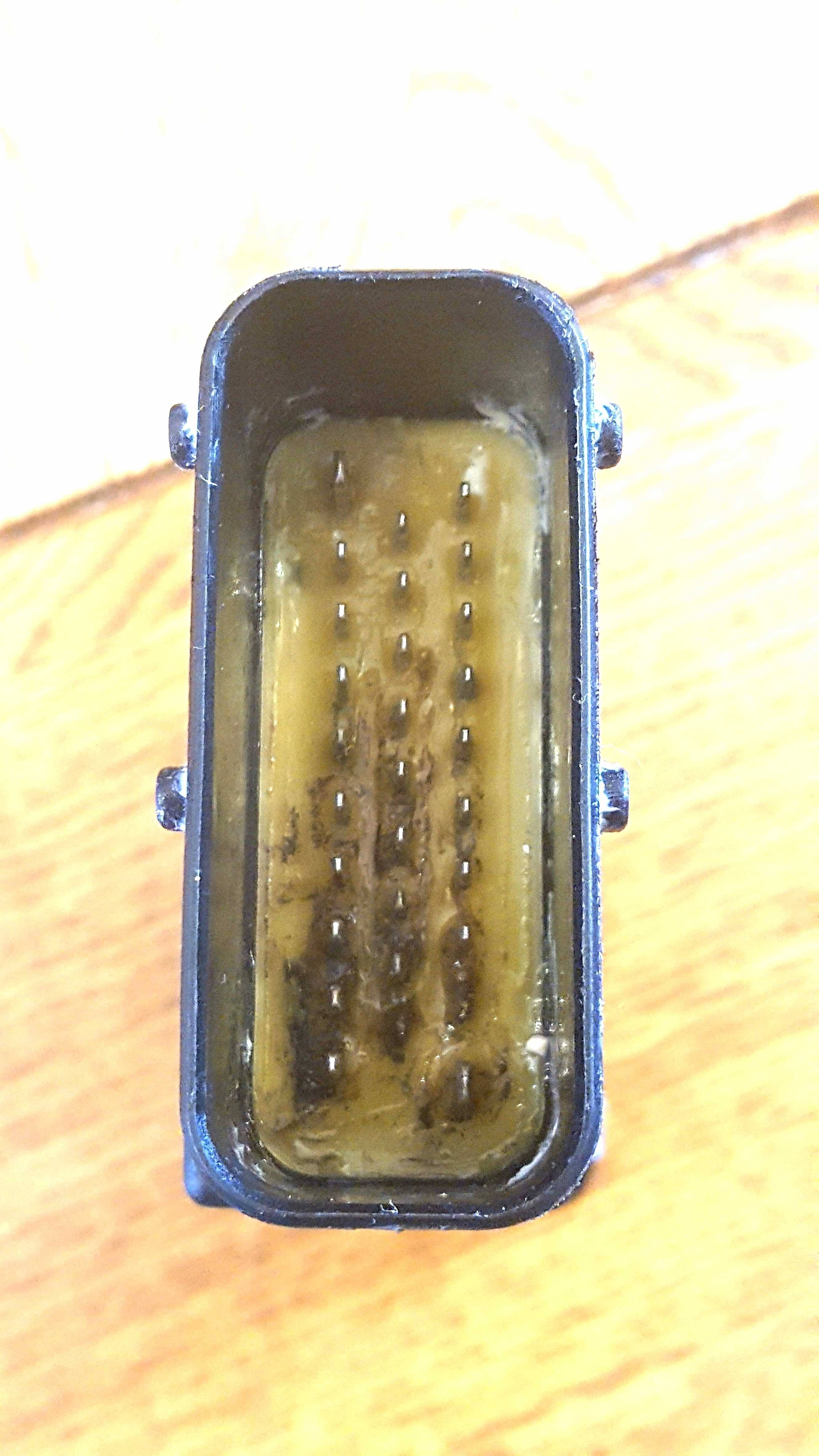

Just a quick recap- so my battery drain problems were indeed traced back to the control module inside the drivers door (no surprises there i guess).  I have had niggles with the windows and CL since I bought the car ... when I first got it there was indeed an egg cup worth of water in the connector so cleaned it up and all seemed ok at the time.

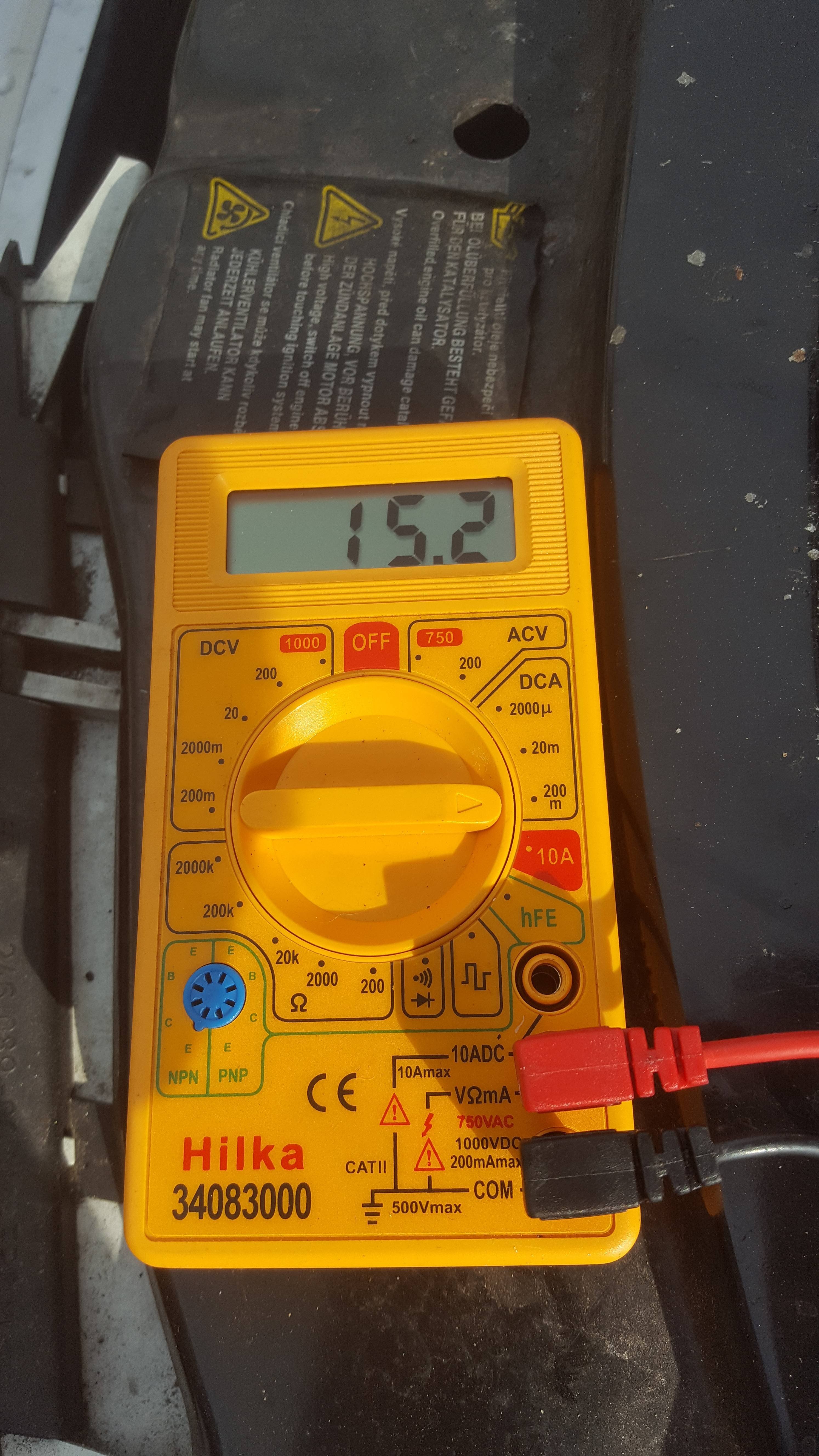

I went back into the door panel today and found that although it seems dry, unplugging it dropped the battery drain to a very reasonable 15.2 mA.
I have pulled it out and found the electonics inside to be kinda rotten and there was a ben't pin and a missing one. I put everything back together without it - I can still use all the windows but the drivers one and I can lock the car manually so it's fine as a temporary measure.
