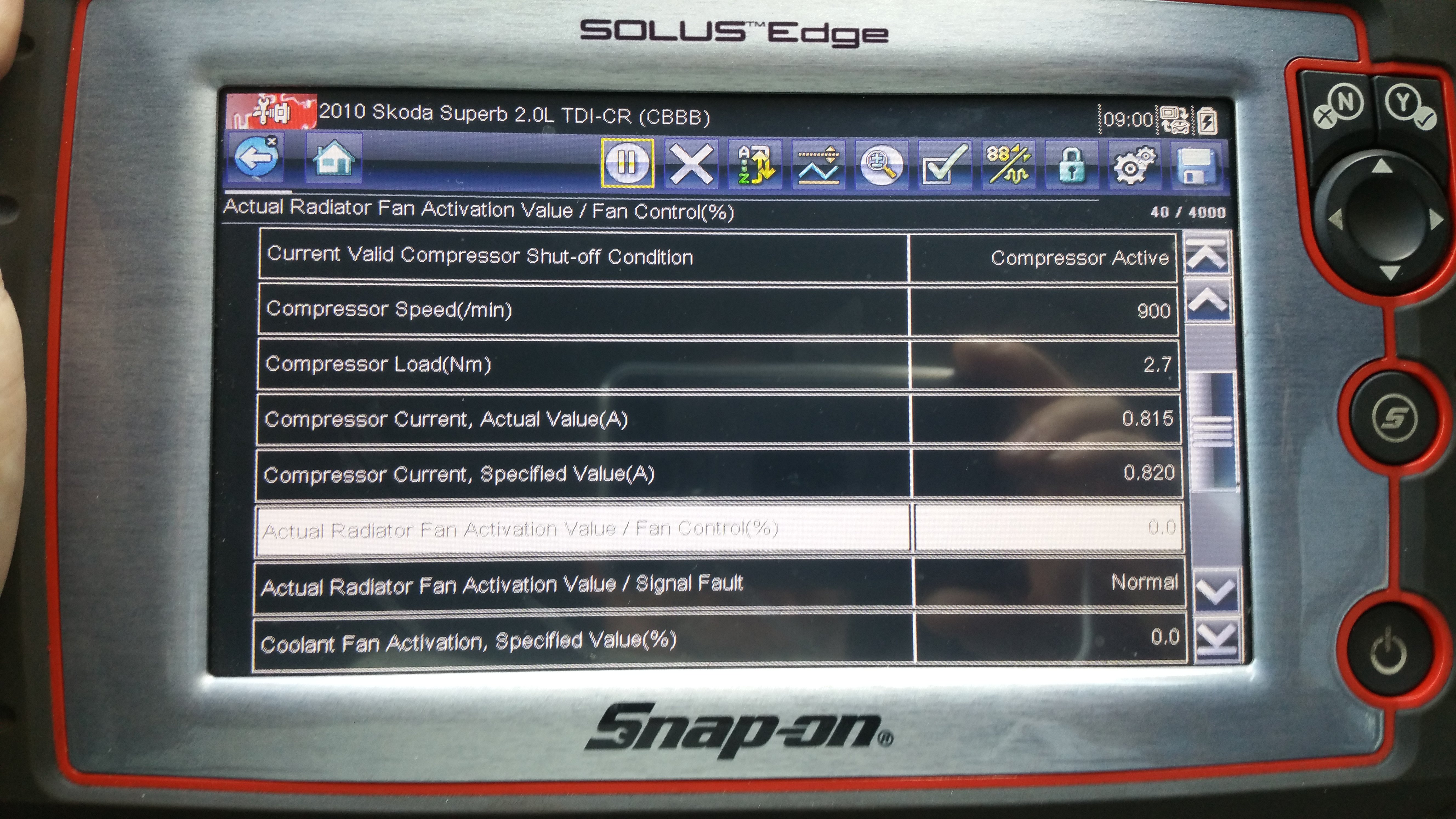

hi guys. so today could only get my hands on a solaris. heres the screen shots from the aircon data
the car has 4 bar aircon pressure before you switch it on, but even when raising the revs it takes ages before the fans kick in..maybe 10 mins
