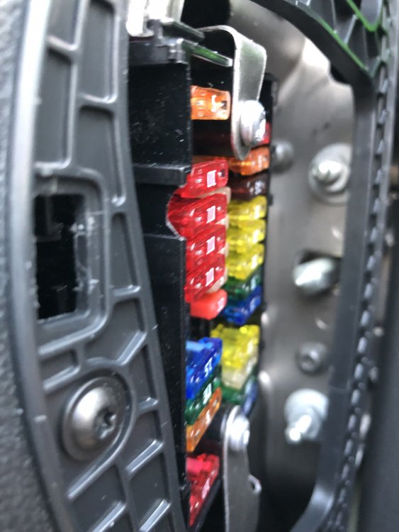

please see attached photos that shows one side of the fuse box sitting outside of the cover location
Those brackets look like they’ve been bent or twisted. From memory mine was mounted flat with plenty of room for a piggyback fuse (which I fitted for a dashcam, as you are trying to).
I recon you’re right weasley, the vehicle has had no work done to it since I’ve had it from new, trip to the dealership is called for tomorrow! Can only guess it happened on assembly.

I would agree, both of those brackets look as if they have been twisted.
The bottom one should be easy to bend a bit more inwards.

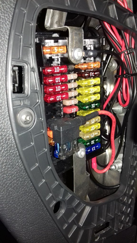

For reference, this is what mine looks like with a piggy-back fuse in it. I believe it was the NextBase kit I used. Whilst it is close, I haven't noticed any issues with the panel closed.
Hmm, actually looking at that picture, I might want to look into protecting the red cable against the screw at the bottom to stop wearing.

Thank you it definitely looks straighter than mine!
Looks the same to me  - and the same as mine! I guess it’s a matter of a couple of millimetres in or out! Mine is a couple of millimetres out so the cover is slightly bowed when fitted whereas GerrardUk’s might be a bit “in” so piggyback fuse doesn’t interfere with cover. Or, maybe the piggyback fuse holders are slightly different sizes, which would also account for the difference in cover fit?
Thanks Expatman, I recon that’s right, if you look at the fuse board on mine adjacent to the four 10amp fuses it projects some 10mm+ past the lid location (also the black plastic fuse board moulding appears damaged).  On Gerrarduk photo the fuse board is almost aligned to the lid location in the same area. I see that Halfords stock fuses with a breakout cable, by using one of these and an inline fuse (of the correct amperage to suit the dashcam) I am sure that it would allow the cover to seat correctly.  Maybe as you said earlier a case of fit and forget.
