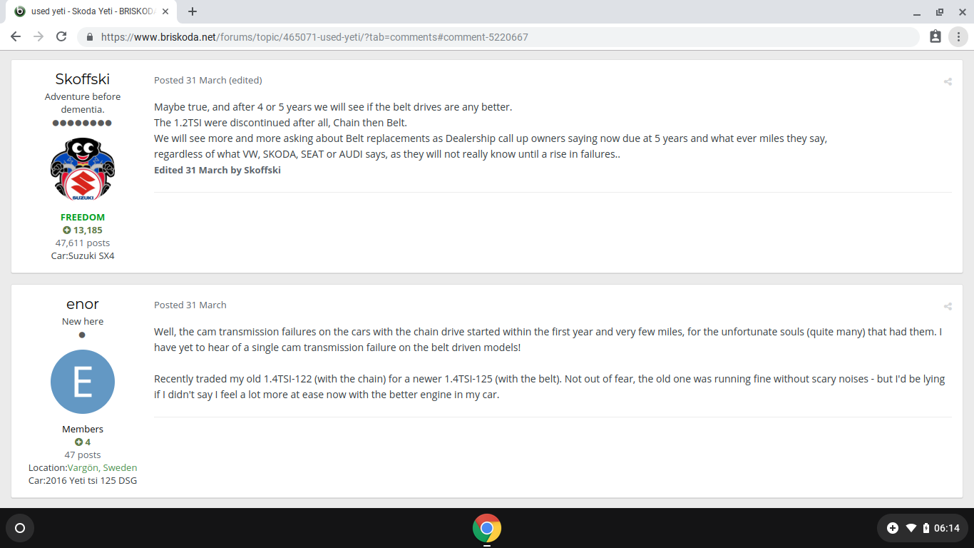

On 15/04/2019 at 13:41, muddyjim said:
There were 1.4TSI (122BHP) Yetis made around 2011-12, but I'm not sure if they suffered with the Chain issue?
They certainly did.
@enor
Euro 5 1.4 TSI / TFSI 132-136 kw Twinchargers had Timing Chain issues, more so the CTHE from 2012 than the CAVE from 2009 with the other issues with Pistons and rings, valves etc.
. As had the Euro 4 Twinchargers and 1.4TSI.
How common were issues or are issues with a 1.4 TSI / TFSI 105 / 122ps Euro 5 engine from 2009?
http://adamlewin.co.uk/vw-mk5-golf-tsi-engine-timing-chain-problem
This forum has had quite a few members with 1.4TSI Octavia Mk2 that have not reported issues, certainly not the issues that those with the Chain Driven 1.2, 1.8 & 2.0 TSI's have.
http://briskoda.net/forums/topic/423736-mk2-14-tsi-engine-any-known-issues-and-real-world-mpg

I remember this post you made.
