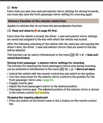

This is Karoq - WITHOUT Personalisation

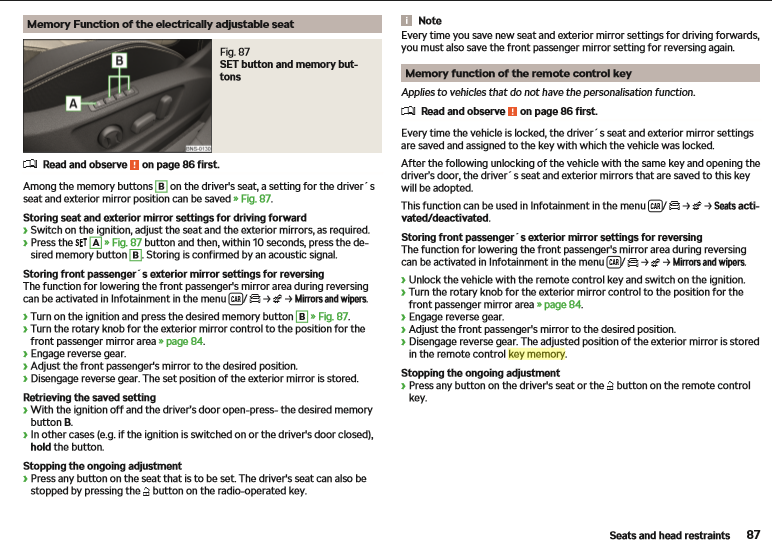

This is from the Kodiaq - Page 87 - seems it should have the same function - WITHOUT the personalisation
All that seems to be about seats and mirrors, rather than drive modes, though.
If a car doesn’t have electric seats (and therefore doesn’t have multiple mirror memories), but does have selectable drive modes - a typical SEL in other words - can the drive modes be remembered?
