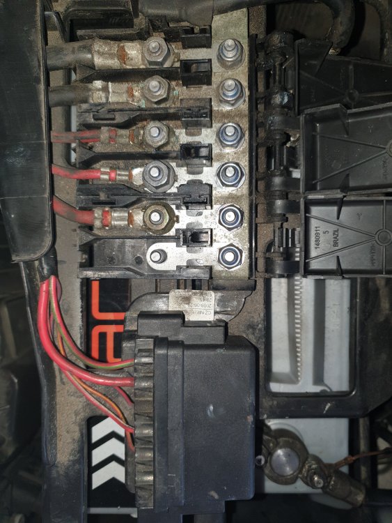

ABS light came on 3 days ago. Took car to KwikFit (no grumbling, they've been reasonably good), ran through diagnostics, no fault code and no light on for them. As soon as I took it out of centre no more than 100m light on and difficult to press breaks. Turned round put it back through diagnostic to show rear nearside sensor showed intermittent sensor code. Sensor replaced, ABS light still on with unusual intermittent error. Asked if it could be the sensor cable, told unlikely and also told to take to specialist as perhaps needs electrician at it. Taken it this morning to IVC in Leeds, similar feedback. Told electrician not around till next Thursday. I've read a fair few threads on here about possibility of strip fuse possibly being faulty. IVC mechanic had a look but said visually, nothing apparent. I have bought some myself and going to attempt to replace
Could someone please confirm if it's 3rd or 4th from the left in the picture and also the box to the right, is that where I'll find other blade fuses?  Have tried fuse 25 internal fuse box, all seemed fine.

Position 4 on your car (fourth from left as you look from the front bumper, or fourth one down in your photo).
You could just swap it with the unused one in position 6 as a test, although that looks like a 50A one, so shouldn't be left in permanently.
Yes, the black cover houses 5 blade fuses (counting the wires going in) No.s 7-11 inclusive.
Brake fluid is in a reservoir at the back left of the engine bay (high up) as you look from the front bumper. Won't be related to this fault, but worth checking level anyway.
