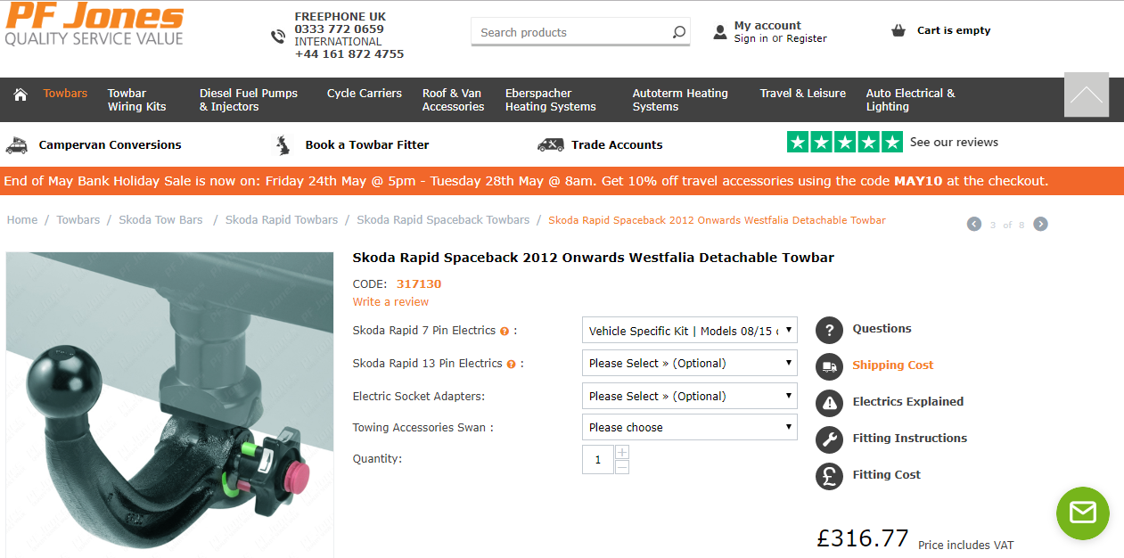

The PF Jones website is a good guide.
£366.17 for a Westfalia removable swan neck and the dedicated electrics, delivered...

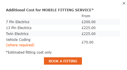

Plus £270 for fitting...
So just under £600 fitted.
Cars are a lot more complicated than they've ever been before. There are a lot more vehicle systems that have to be considered.
https://www.pfjones.co.uk/skoda-rapid-spaceback-2012-onwards-westfalia-detachable-towbar.html
