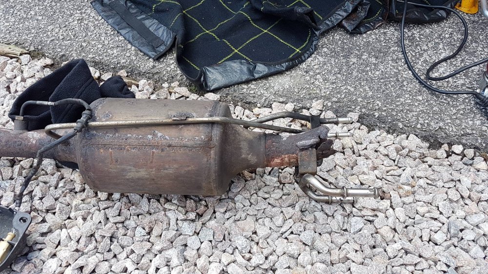

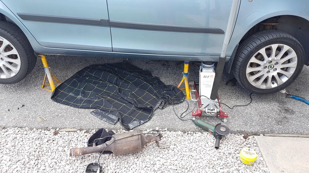

Would you believe it. My car exhaust has started leaking near the catalytic converter. I'd patched it before, but looks like I'll need to get under it again tomorrow to investigate.
Update. Great day for working under a car! Stripped out the catalytic converter. Turns out it's sheared just where it joins the flexi exhaust pipe from the DPF. Used an angle grinder to cut the exhaust clamps at the join at the back of the catalytic converter to the middle exhaust pipe. Disconnect sensor 4 and two control hoses to differential pressure sender and disconnect at hangers.
Managed to insert a length of 50mm exhaust pipe into the catalytic converter, clamp it on with exhaust gum and seal with chemical metal. The exhaust pipe section goes into the flex pipe, and sealed there too. It's a temporary fix, but will last a few months. I'm looking to offload it in the Autumn and switch to a petrol daily driver.
Used jubilee clips, but have ordered A2 stainless clips for rubber hoses and heavy duty exhaust clamps for central section.
Can i ask you what engine code do you have ?
On this picture , you two differential pressure pipe outlets plus temperature sensor , which would indicate this round box is DPF.
I am saying that because i just attempt yesterday to remove DPF from my car and we got confused what is what , as local garage where they do DPF removal saying round box is actual DPF not a CAT. I have engine CAYC engine code.
It was I assume CAYC engine code. However I've since sold the car. What you're looking at is the catalytic convertor. The diesel particular filter sits behind the engine on the bulkhead. The corroded section is connected to a flexi pipe which goes to the DPF.
