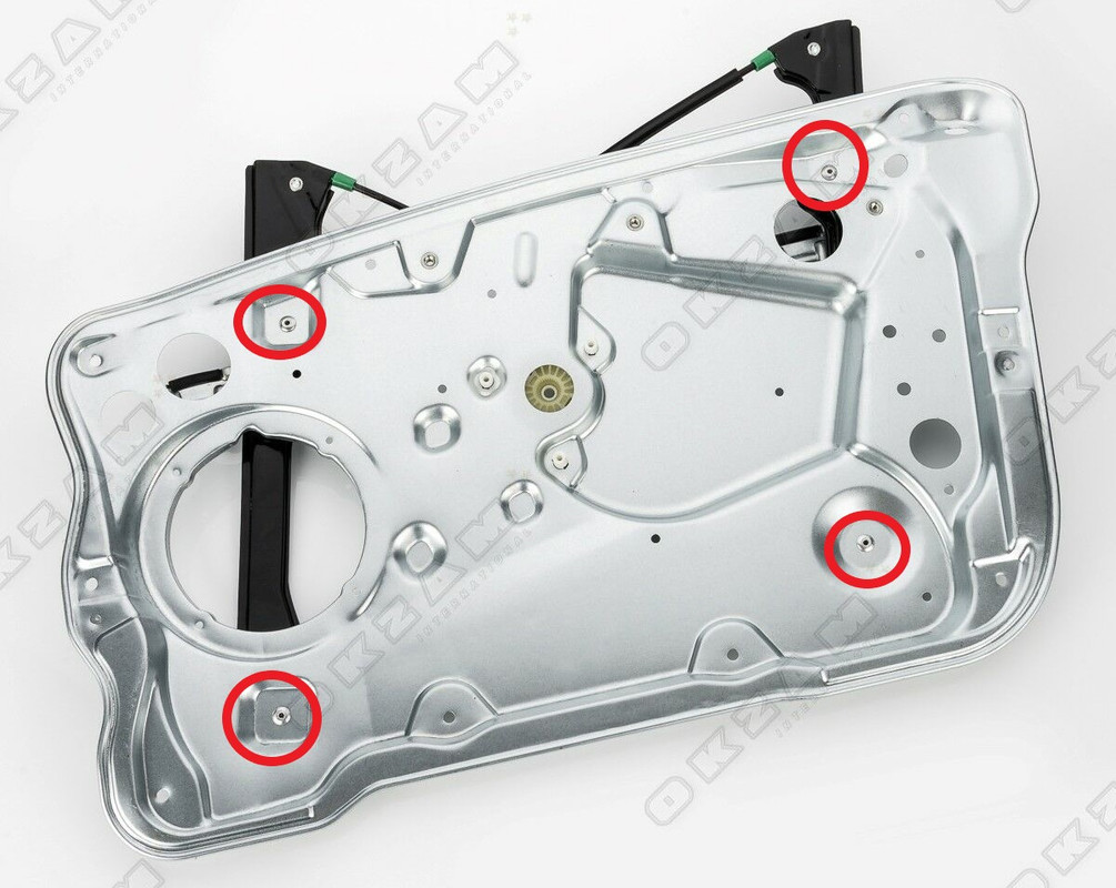

I need a bit of advice please. My window regulator has failed for the 3rd time in as many years. Its now stuck in the down position, and I can't pull it up at all. I'm trying to remove the regulator panel, but, after drilling out the 10 rivets, its still not coming away - is this because the window is preventing it from being removed? If so, how can i solve this? Any advice is wholly welcome, thank you.
You need to drill out the four rivets securing the regulator to the door carrier panel. The panel will then come off.

Lee, you're a star mate, thank you very much. I'll give it a go today. Obviously Im going to need to replace the rivets - any suggestions on what rivet gun a need to get?
No probs :)
Window regulator to carrier rivets are 4.8x15mm. Part number N90765701 (these also fit the door speaker).
Door carrier rivets are 6.4x10mm. Part number N91078801
A lazy tongs riveter capable of taking those sizes is ideal.
