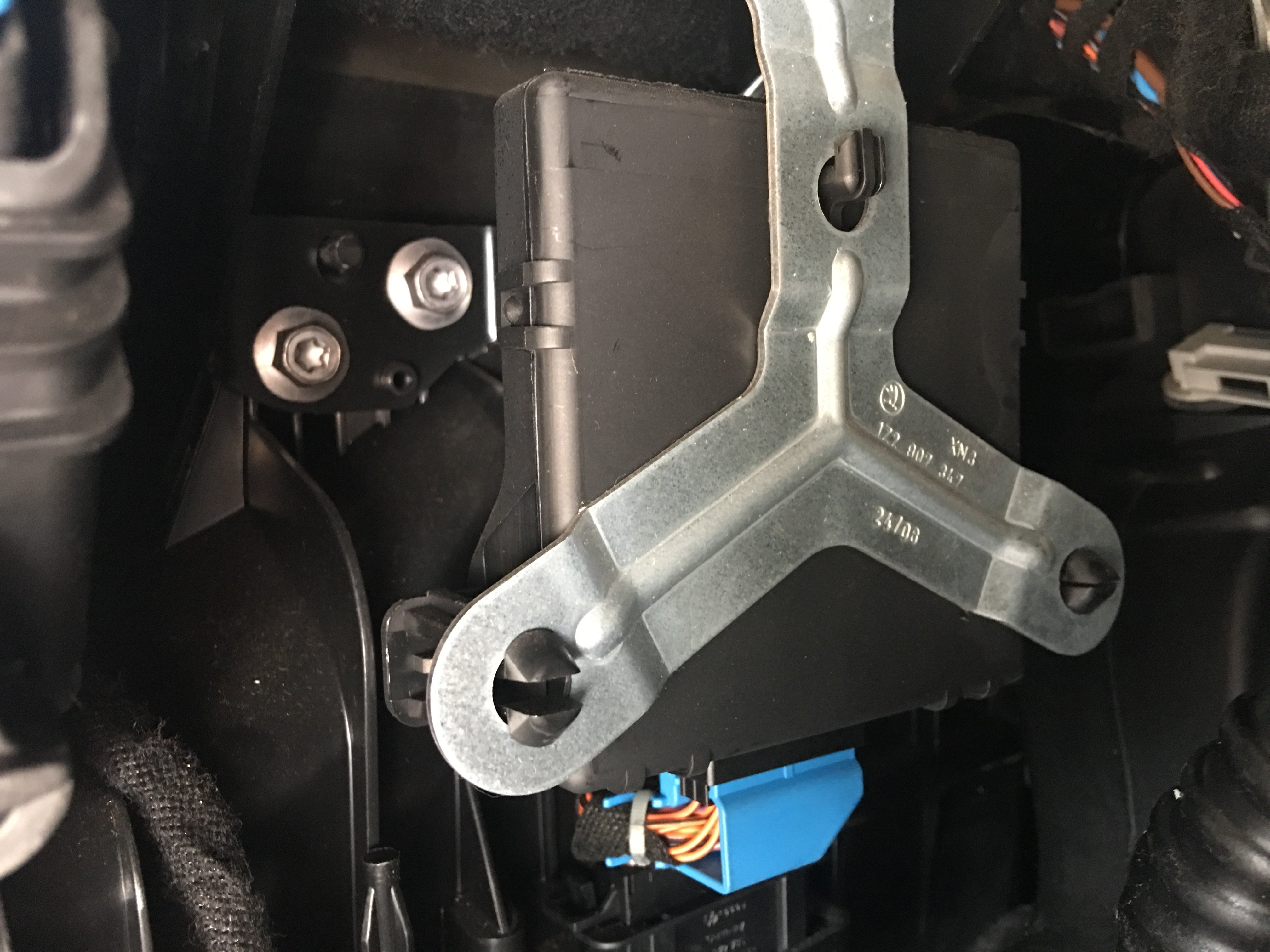

If yours is a 2006 the gateway is behind the glovebox.
It's dead easy to swap over.
8 hours ago, Rustynuts said:
Cool.
Yeah it is behind the glove box easy couple of screws
That's easy enough. I'm away this week but I'll be back Friday or so and be in touch then.
