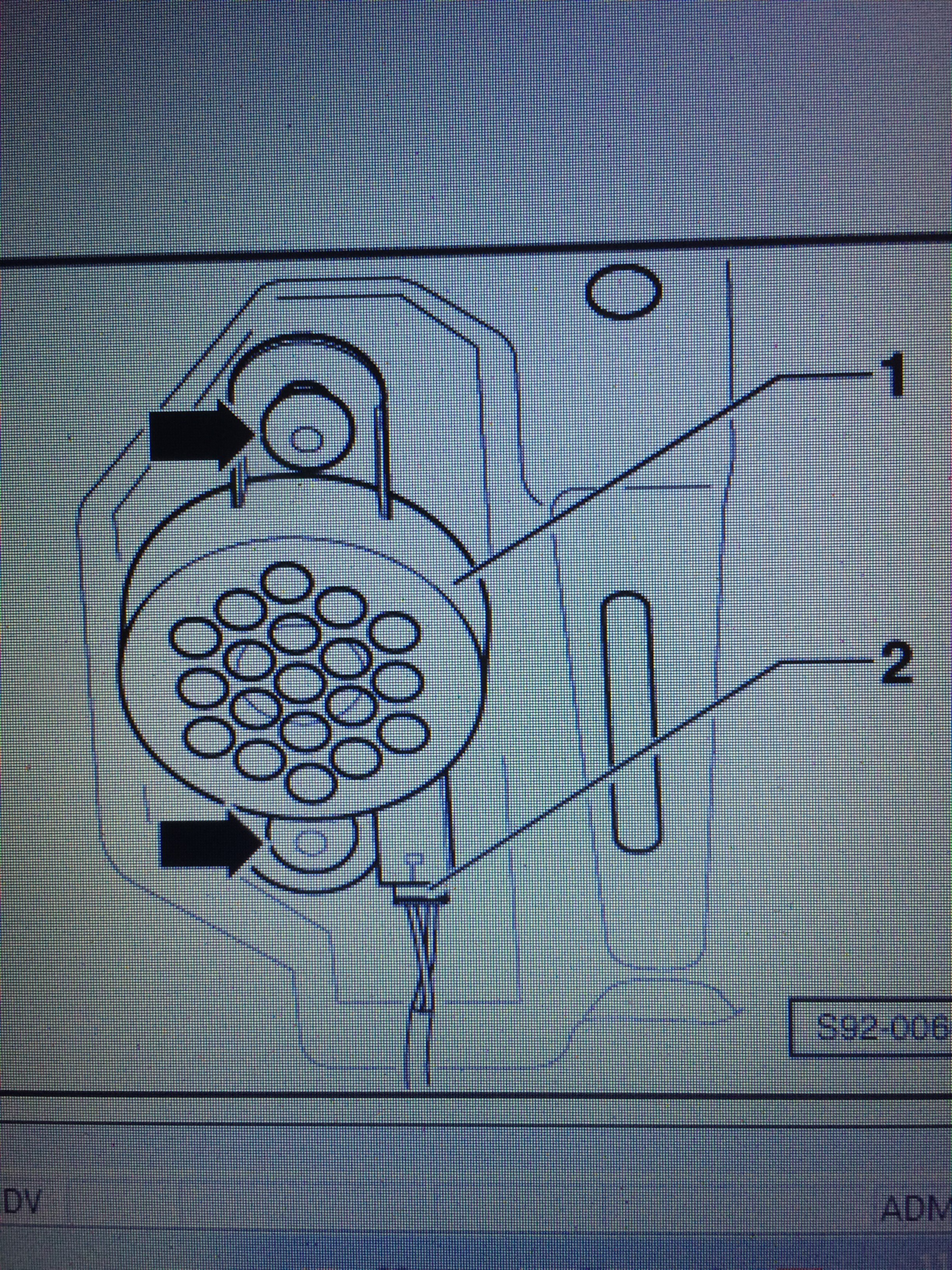

I have just found out when I reverse in my Scout there is no display and no bleeping yet the reversing lights come on, DTC 01543 shows 'parking aid reversing chime' H15 as faulty !
It'll be the separate speaker it uses for the beeps. As it's detected a fault it will have disabled the entire system.
Check it and it's wiring then replace if necessary :-)
The "beeper" is behind the L/H "B" pillar trim
Thanks for the info lads, I will have a look to see how I get to it, Is it just a remote speaker or is there some electronics with it ? Doesn't look like I will do it today as I have to work on it outside ! Cheers Stuart
It's just a speaker nothing fancy
Removing
– Switch off the ignition and all electrical components.
– Remove bottom left trim panel of pillar B →Body Work; Rep. gr.70.
– Unplug connector -2-.
– Remove button rivets -arrows-.
– Disconnect parking aid warning buzzer -1-.
Thanks for that nige, just been firing up an old PC which has elsawin on it and had to do a few updates ! Finally found it in section 94 outside lights etc, and now I am trying to get the printer working ! the troubles I have when you mothball it just to keep it for elsawin info.I wouldnt have thought just the speaker failing would shut down the whole warning system ! but I am about to find out. cheers Stuart

It was the speaker in the trim behind the seat belt on the near side, I tested it first by putting a 47 ohm resistor in series with a 4 ohm speaker and it all started working so then spent £8 on eBay for a replacement.The trim pulls off starting at the top, If I can find time I will post some pics.  The original speaker was 50 ohm and the replacement measured 25 ohms, Cheers Stuart
