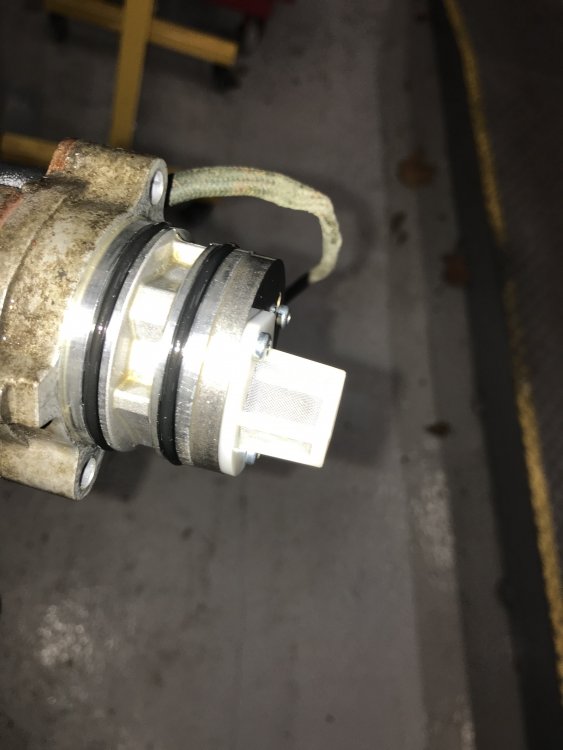

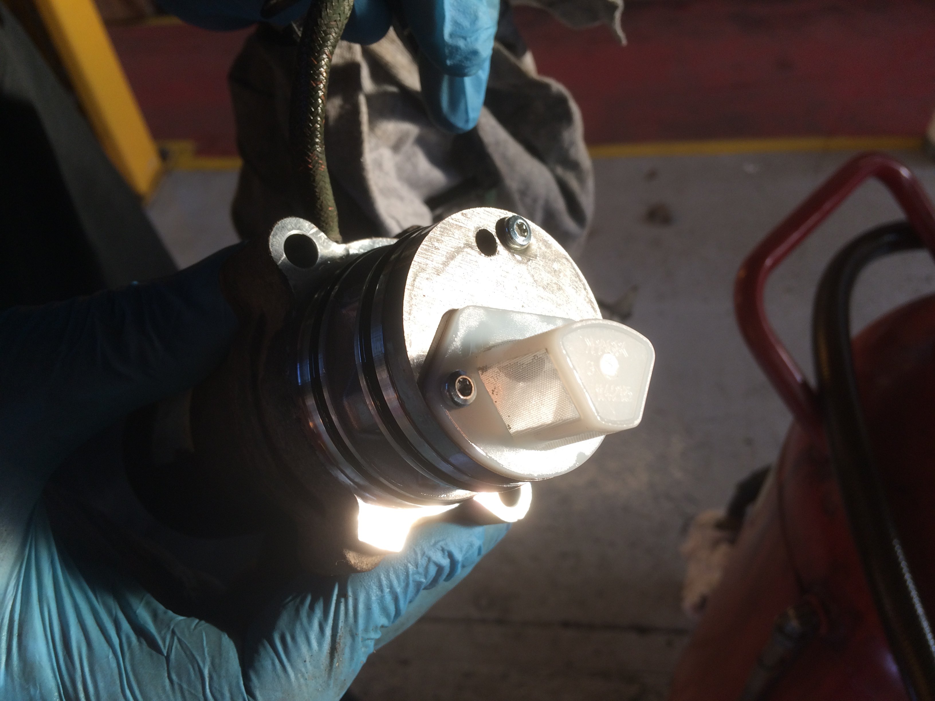

Hello,

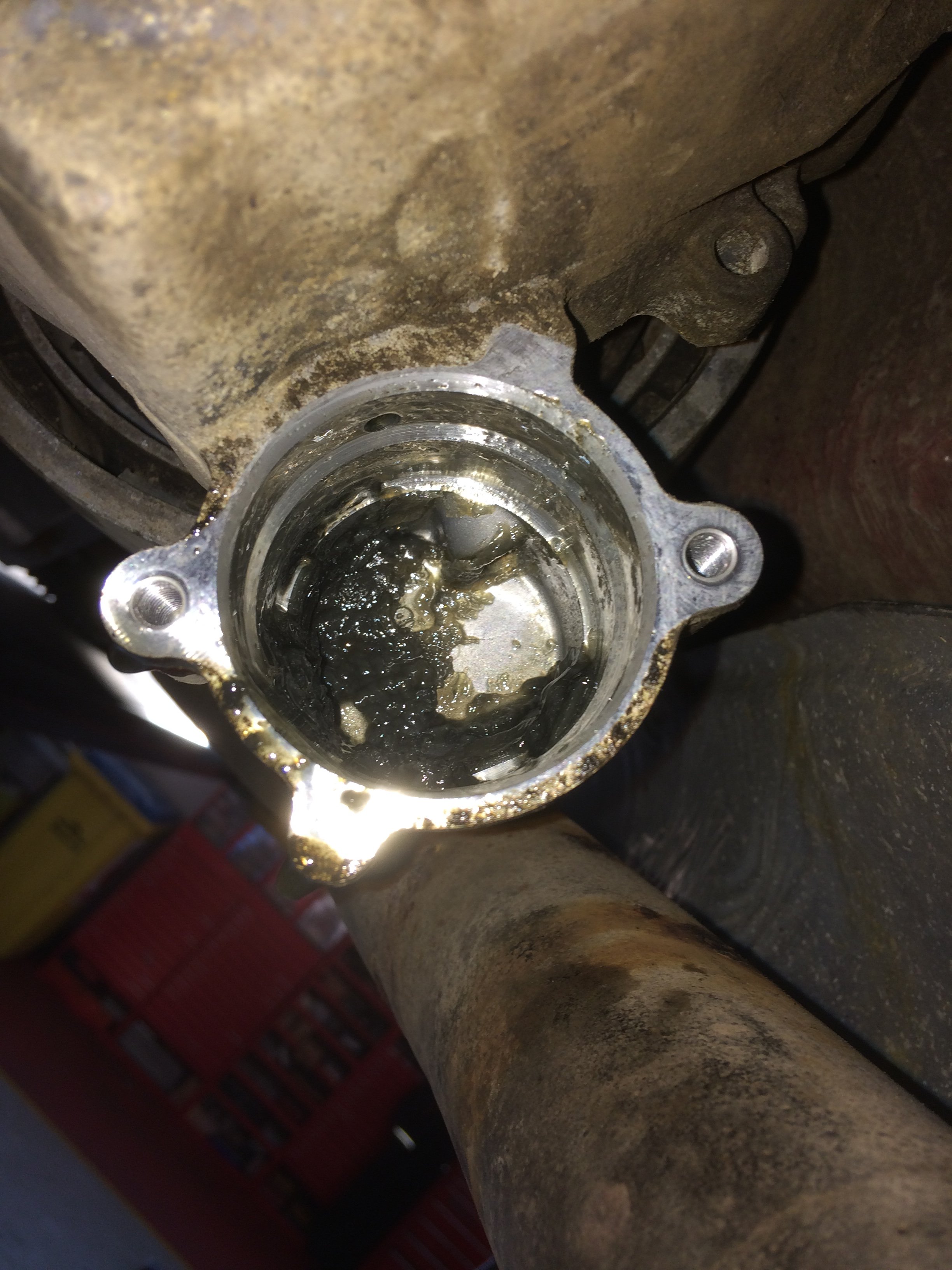

I would definitely get it done, my oil was drained and refilled at Skoda in accordance with service regime when new, but I have removed the pre-charge pump and cleaned myself and it was filthy! See the before and after pictures below. There is some very good info out there on Haldex 5 service / faults etc.. https://www.haldexrepairs.co.uk/generation-5-haldex-fault-finding-repair-guide/

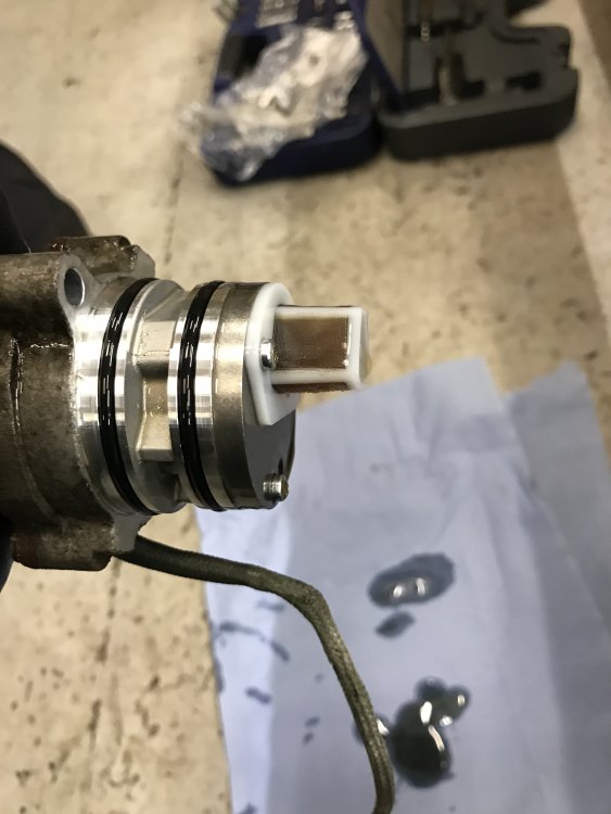

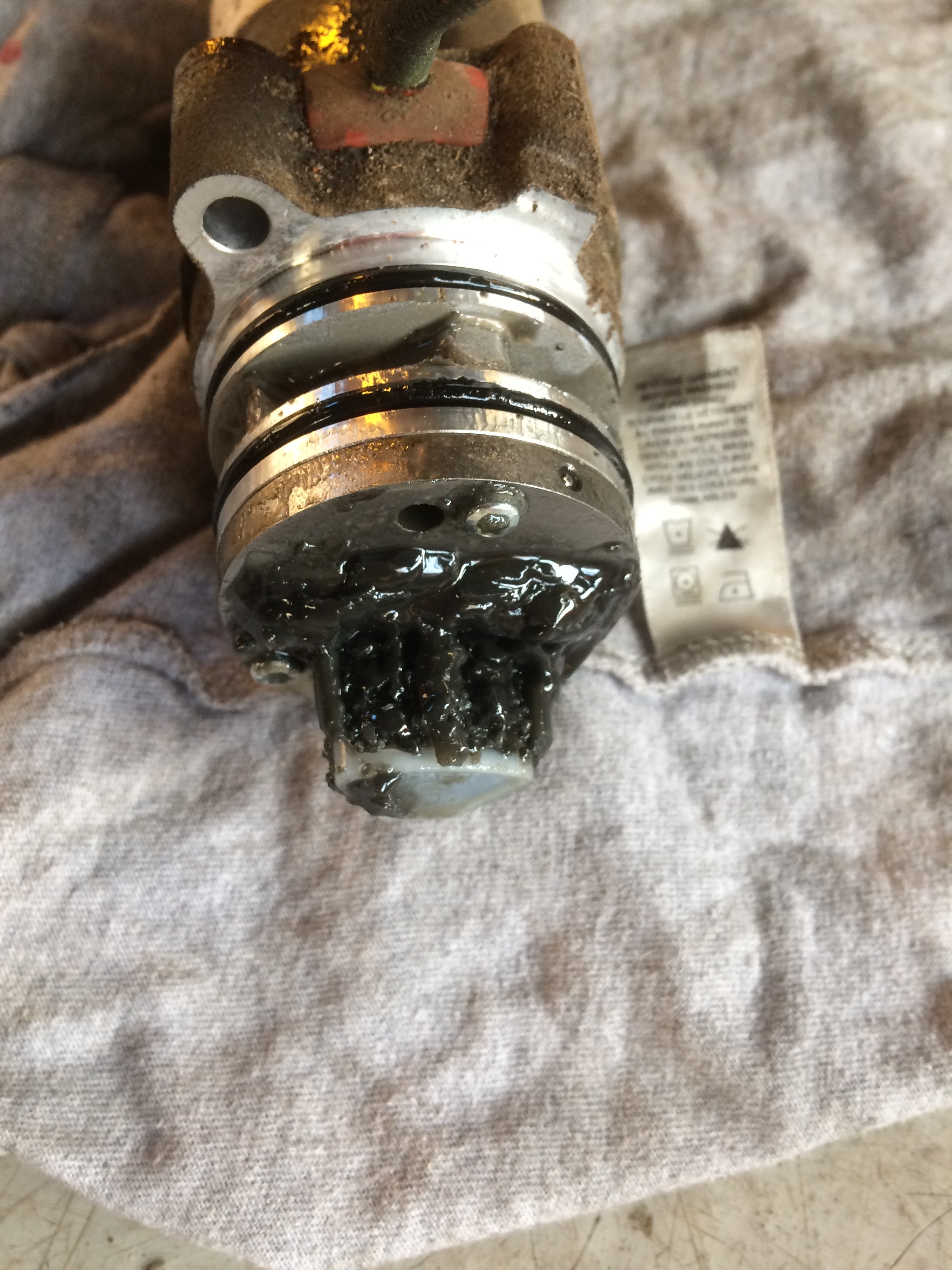

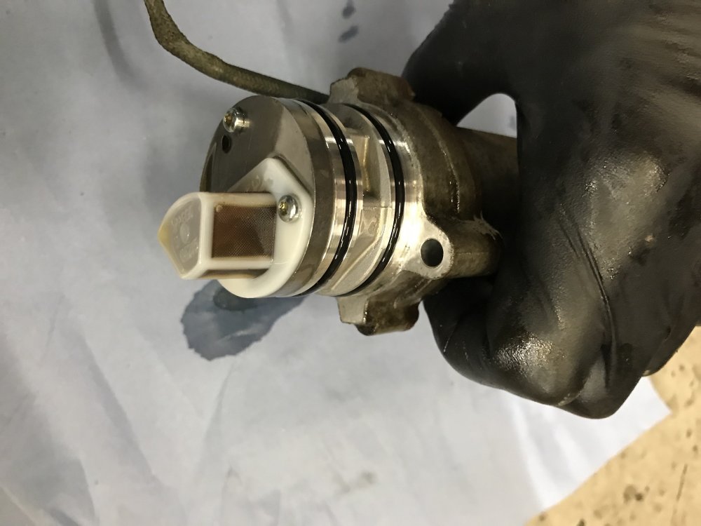

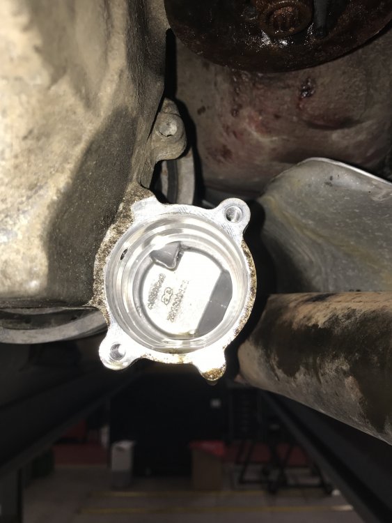

Hopefully you’ve had your Haldex fluid changed and all was good.

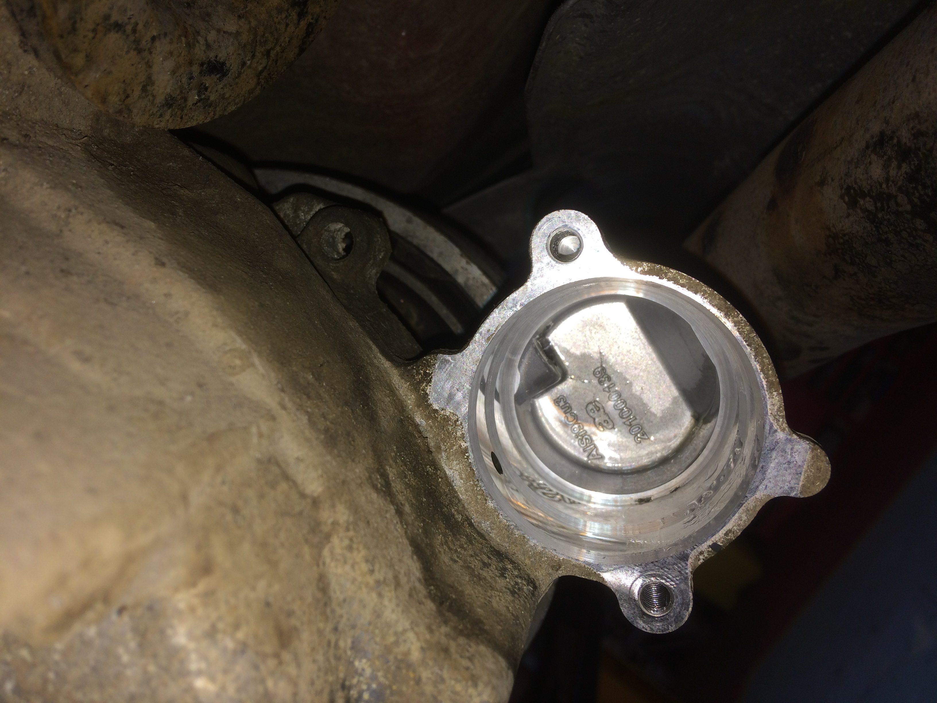

I had access to a ramp so thought I’d do the Haldex Fluid change again.
18 months and only 8000 miles elapsed, but things are looking good this time.
The first three pictures are as the pump was removed, last image is after the filter was cleaned off before refitting with new O rings, filler and drain plug plus bolts for pump.
The fluid was nice and clean when drained.
It is worth doing this job properly and removing the pump when charge fluid.
I used VCDS to run the pump motor to finish.
No fault codes were present on the AWD module.
