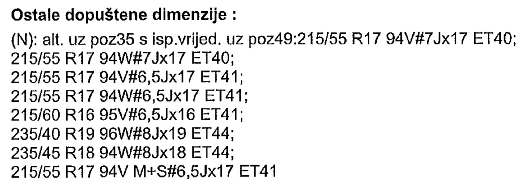

I agree with what xman said but I went ahead and checked things which usually can be a limiting factor:
- change in circumference more than 2% - you're ok there as this change increases circumference by 1.3%
- is tyre too wide for the rim - you're ok there as well. Skoda's 18" rims are 8" wide for which 245mm is max tyre width
These are the two limitation that I'm aware of but there might be others.
Having said all that, I personally would stay within approved dimensions (I'm attaching the list I got with my car - build 10/2018).
