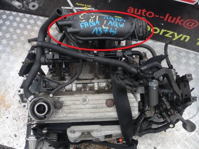

I think that's an 8v 1.4 engine. Somewhat different layout. TMB gives correct location and later bbz 16v engines with plastic manifold have it in pretty much the same place. Awkward to reach. Changed mine 4ish months ago when chasing similar fault.

Its underneath this thing. Take off the hoses and remove a couple bolts. And you'll find it plugged into the intake manifold with 2 bolts. Can't miss it.
Just use some electrical contact cleaner to clean it :)
That's all well and good but the engine in question is not an 8 valve. I've already posted the correct information 🙄

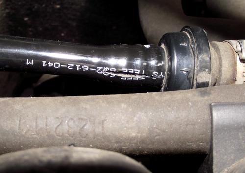

Visual inspection first. Torch and mirror needed so you can eyeball all round the hoses. Common for the plastic servo hose to split at its ends where it is stretched. Example below. Nice easy one to see. The other end was split underneath, hence the torch and mirror.

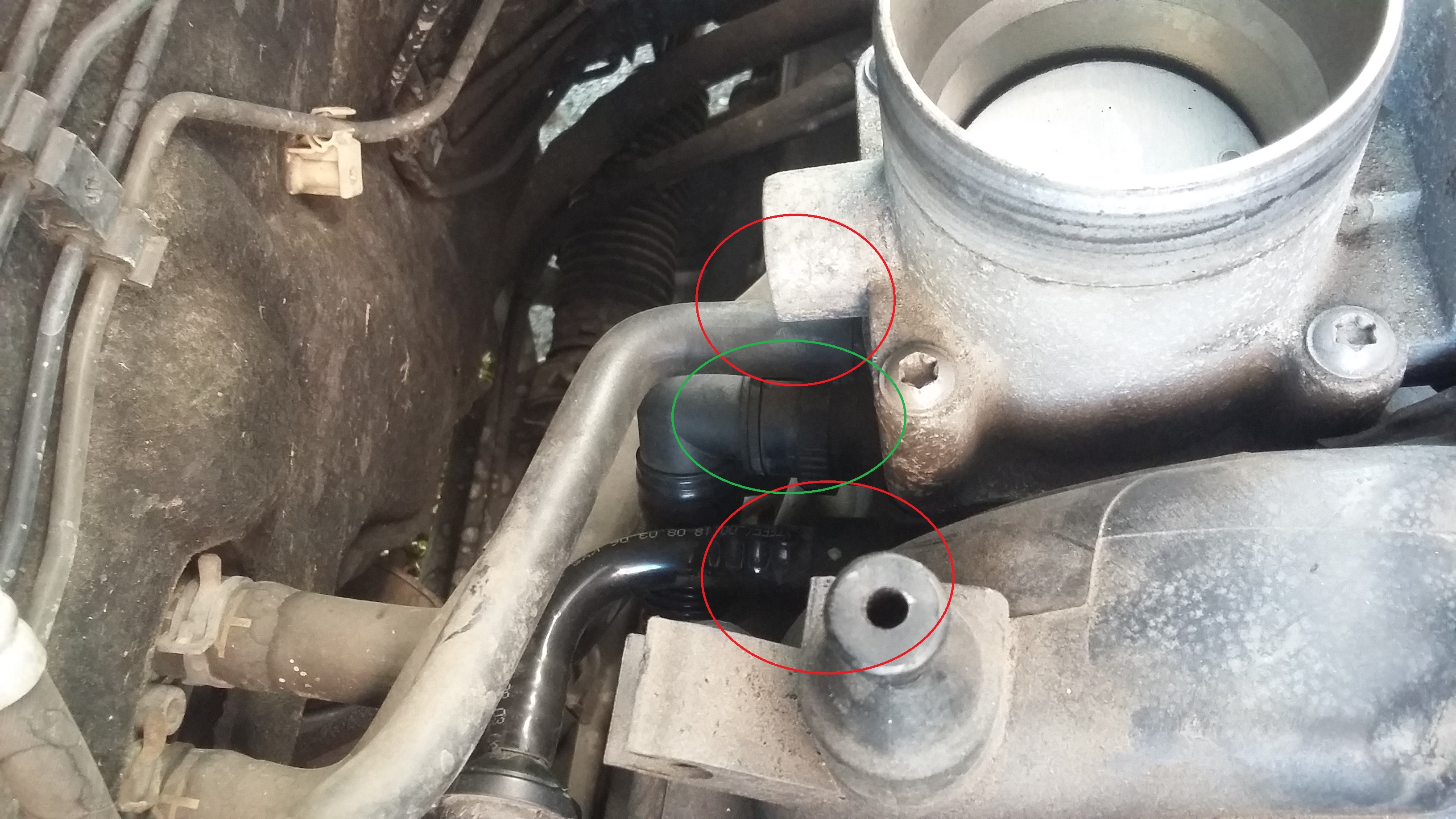

I also had a good look for split hoses this morning. I disconnected the two red-circled ones and they looked perfect. I also disconnected the green one but i'm not really sure what that is; it doesn't look like a vacuum hose?

Green hose is output from PCV system being fed back in.
