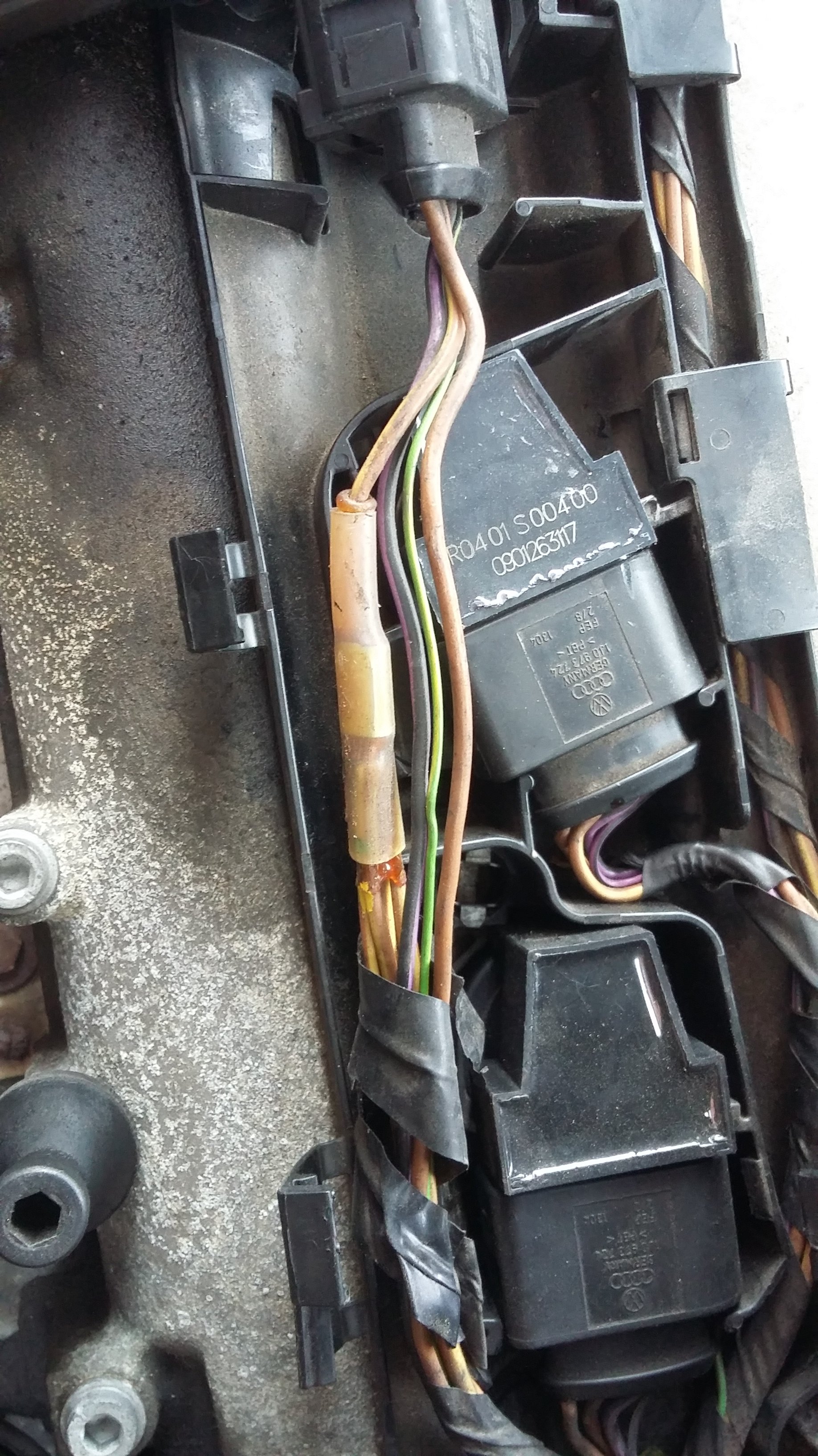

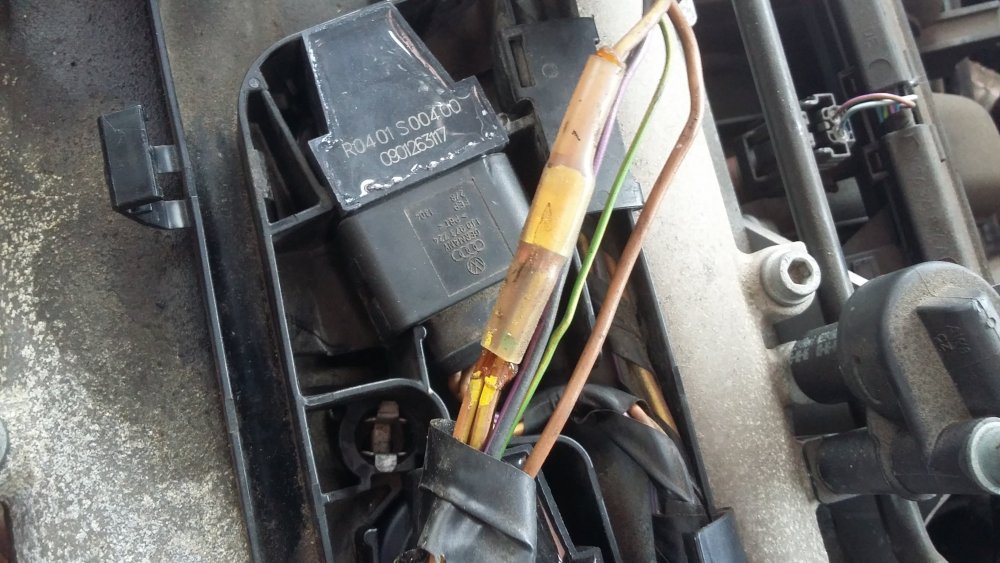

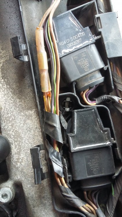

I did however take a pic of some dodgy looking wiring leading to the coil on cylinder 3. Does this look like it could cause the issue? If so how easy would it be to replace?
  • Sponsor
I have a vague memory of seeing similar on my car, so suspect that is a splice that's done during loom manufacture, rather than the 'dodgy fix' that it resembles at first glance.  Will have a look later, if I get a chance.
Does that rule it out then, or could it still be a weak point? No hot weather and sunshine forecast for the next few weeks to test it!
  • Sponsor
Probably rules it out. Mine has exactly the same arrangement.
Errm, just one thing though, that splice is on the way to coilpack no2, not no3. They're counted from cambelt end.
Oh! How stupid of me! However, coil 3 (the real number 3!) was still definitely replaced by the RAC in February; i have the rescue report and have just double checked it, so it has still failed very quickly if that is at fault.

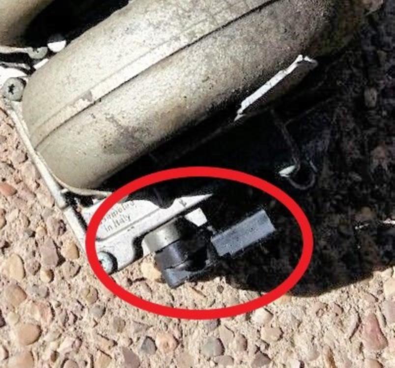

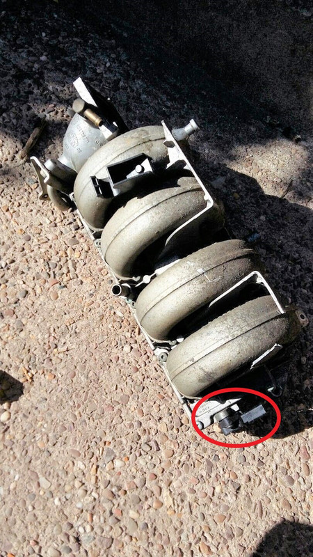

7 hours ago, isambard said:
Thanks for the suggestion XSR; where is the MAP sensor located?
Its underneath this thing. Take off the hoses and remove a couple bolts. And you'll find it plugged into the intake manifold with 2 bolts. Can't miss it.
Just use some electrical contact cleaner to clean it :)
